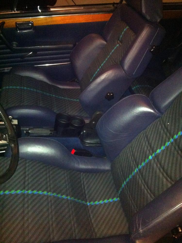

This topic has surfaced a few times so I thought I would provide complete information.
The cup holders from a 1995 5 series will fin in our coupes. There is a notch molded into the bottom of the cup holder. You need to put some sort of cushion pad as the slot is just a bit too big for the emergency brake lever. Once you have fitted it in, It works very well!
Part # : 82 11 1 468 721 $ 25.95

I concur - coffee in a coupe is ok
Installed the same one as Stan in my coupe.

That looks nice. I guess when I pull a high speed 180 using my parking brake I better have my Starbucks between my legs :smile:
