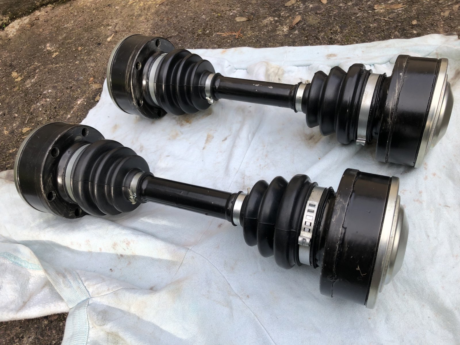

I have been working on the joints this week and I didn't read this post before I started. A tip for those who didn't mark everything is that the inner casting and the outer casting have to be in the pattern as I pointed out in the picture. Small inner vs wide outer or the other way around but not small inner vs small outer or wide inner vs wide outer. If you would do that last option (it is possible) be aware that the inner casting is not able to move anymore and it will cost you some force to get things disassembled again. It even might stuck as I experienced ;).

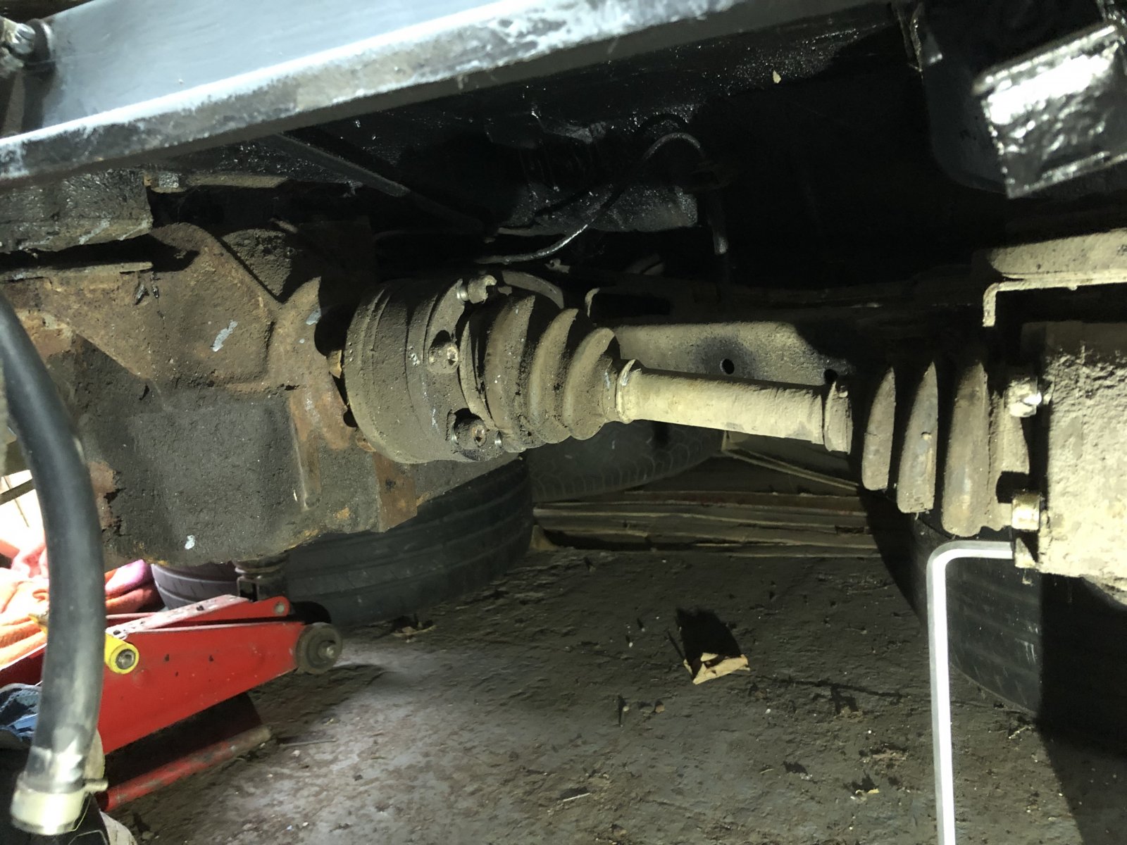

deQuincey - this is an extremely helpful tutorial! I just replaced my CV joints this week. Interestingly I don’t have bolt and nut like yours, mines a ‘75. The hex head socket cap bolt straight to the flanges on both diff and wheel hubs which have screw threads. It was a pain trying to loosen them while trying to stop the axle from spinning. I had another episode trying to get a bolt out which was bent and ended up rounding the head. Only took me 10 hours to get it out!

To undo those tight drive shaft Allen bolts I :
Locked the wheel hub with a piece of soft wood approx 4 by 4 inches and 4 foot long, shaped to fit the wheels studs pattern, then resting one end on the ground to lock it. I copied the idea from a post somewhere on here where they machine wood to replicate the wheel stud pattern.
Cleaned the Allen nut extremely well.
Used a 1/2 drive breaker bar with Allen key socket, when properly inserted I gave it a good tap with a hammer.
I cracked these Allen bolts off one at a time starting on the diff end.
Two were extremely tight so that was a two man job, one to pull on the breaker bar, one to tap / shock the head of the Allen socket, I felt this was safer than just pulling the breaker bar really hard.
I replaced all bolts when I reassembled It.
