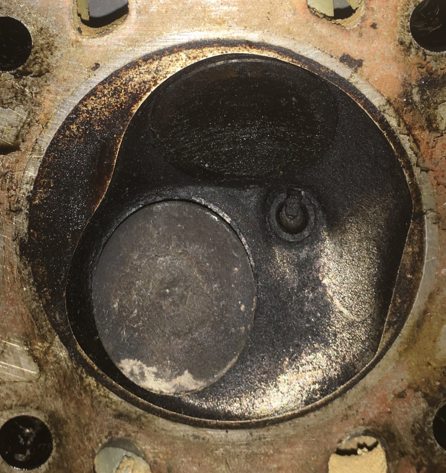

Here is a pic of my 277 head. I used my iphone’s skewing features fo straighten out the angle. Pretty nifty.
Anyway, you can see that the 89mm bore of a B30 still falls outside of the combustion chamber. The 277 head was used on the B34 which was 92mm. So BMW didn’t care about going larger and having some flat material overhanging the cylinder.
An 86mm 2800 would be 1.5mm closer to the chamber, and you can see from the pic that it is getting awfully close.

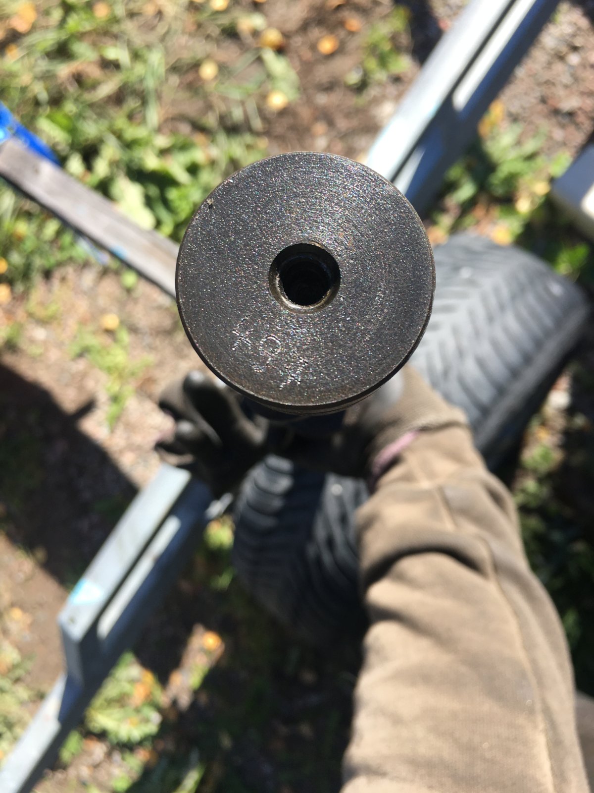

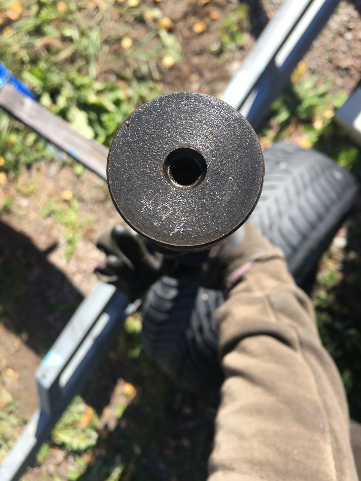

Also some weird marking at the back of the cam, 497 I think? Looks sketchy.
