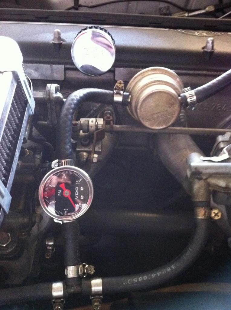

Check/replace your accelerator pump diaphragms. Maybe install a pressure gage between the pump and carbs to make sure the pump is putting out ~2.5psi.

I would look at the fuel pressure and accelerator diagphrams before trying anything exotic. These cars were designed to work w/o double pumps and one way valves. Here is my in-line fuel gauge:
