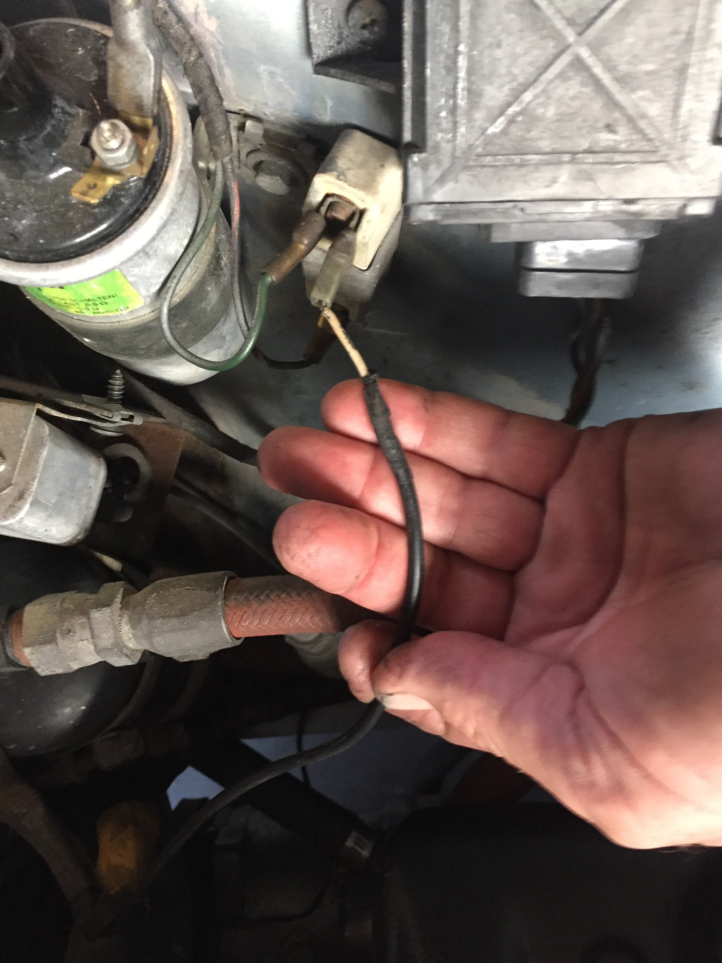

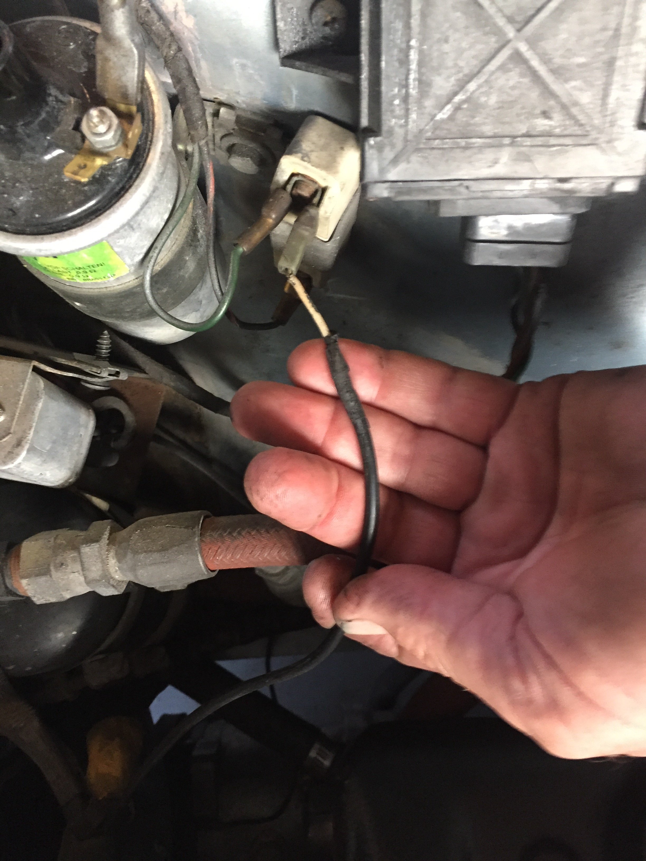

You have your white wire hooked up?
The white wire which i am pointing is comes from main relay.
