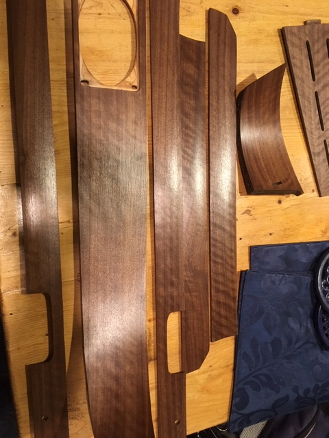

I did mine and used a different wood similar to the original Walnut with little more pattern and interest. Etimoe.
But regardless of your wood we are dealing with wood that is exposed to heat, moisture and your wife lipstick and hair brush rolling around next to that beautiful wood.
Since it's a car why not use a car product that UV and moisture won't bother. It's also very hard so hopefully the lipstick and brush won't bother it either.
I used basically clear coat for automotive paint. Has to be sprayed and is a two part mixed coating.
You can get in many types of finishes like satin which is basically what the original was.
BTW, I made my gear shift knob and brake handle cover from the same wood. Also the door lock pulls.

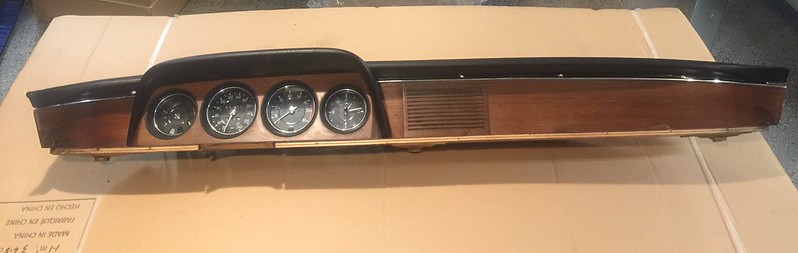

So I am still working away on the dashboard. 16 hours of removing the original lacquer has given gave us an idea of the damage. All is good except for the wood around the instruments and one horizontal wood strip above the driver's door. I am thinking about getting a local refinisher (touches up coffins!) to try to duplicate the grain, however, I was also thinking about trying to get as close to the original grain as possible. Does anybody know, or have experience with, a company that has veneers as close as possible to the original European/French Walnut?
