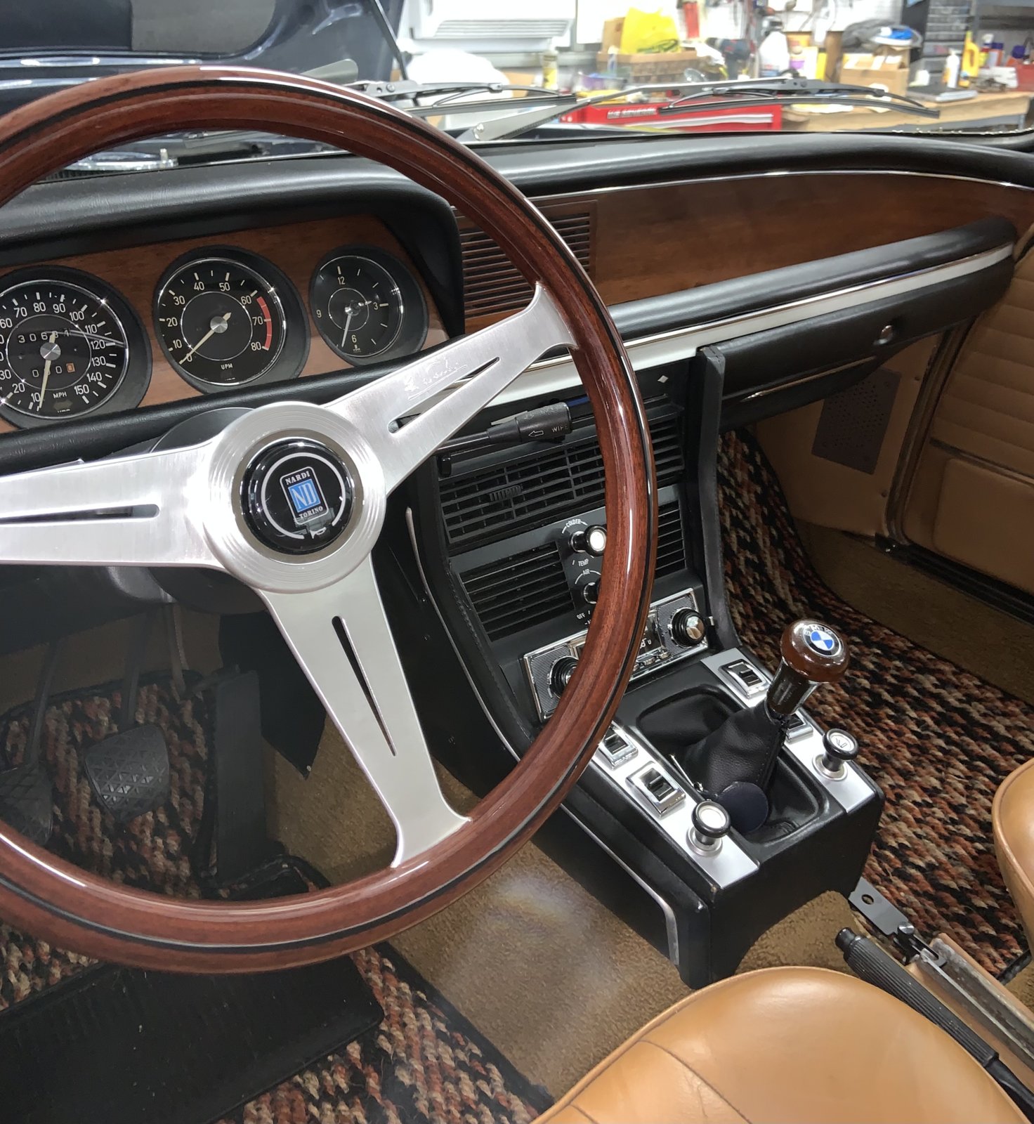

I used AAA Quartersawn Mahogany (Blonde) 18943 veneer from VeneerSupplies.com and used stain that I mixed from 3 different colors. Then I sprayed with a satin poly. The Tung oil sounds interesting.

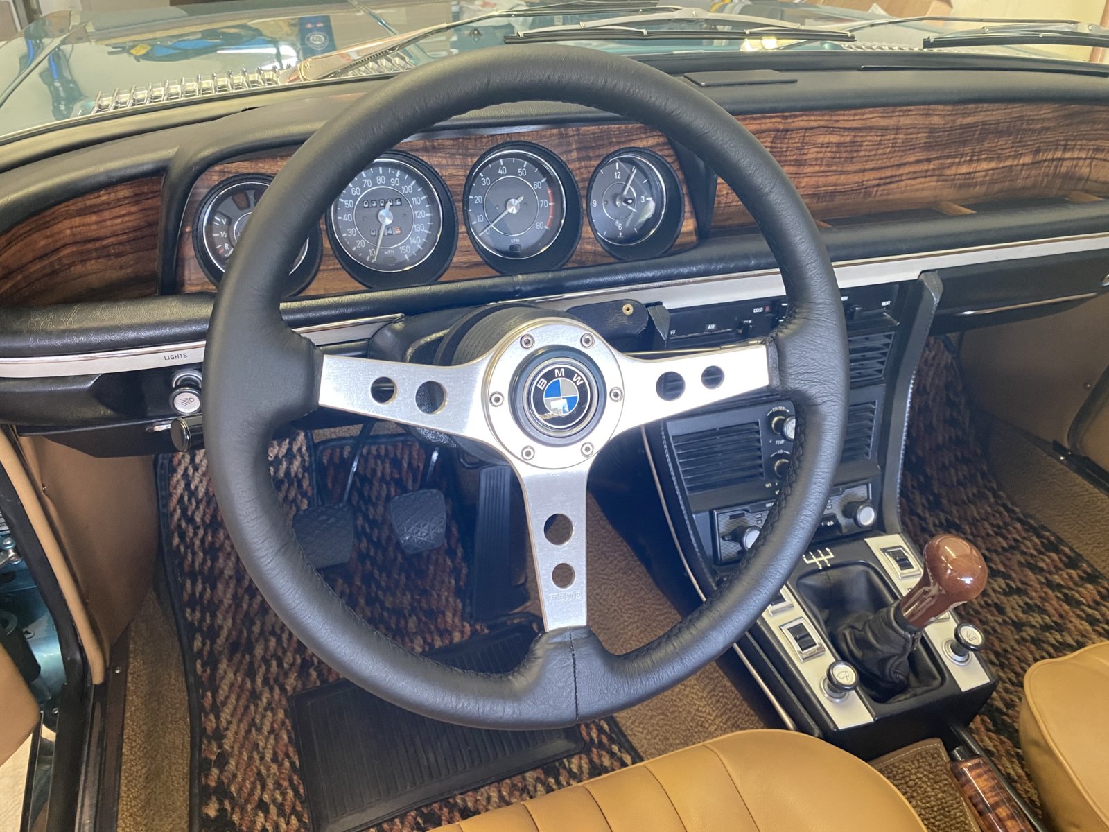

I bought Etimoe from there and used one piece to do all my wood. Grain is one continuous piece from l-r.

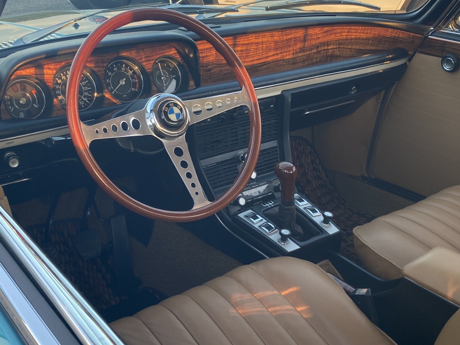

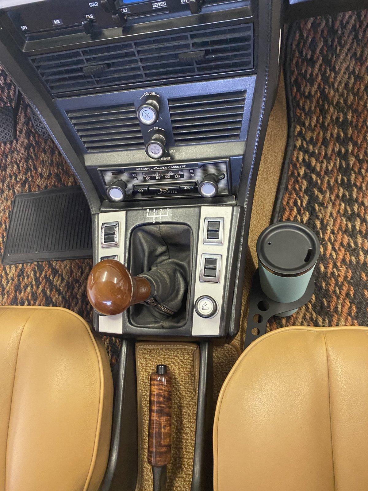

The PO of my car had the dash & trim veneer done in Hawaiian Koa. The car was shipped to me from Maui. I then bought 2 billets of Curly Koa on EBay and had a furniture maker copy my semi-square handbrake handle. It was finished with a 2 part epoxy-type finish. The Koa dash & trim are polished more than a satin look.
Your dash and steering wheel are what you see while you're driving. Take the time and effort to make them to your personal preference.
