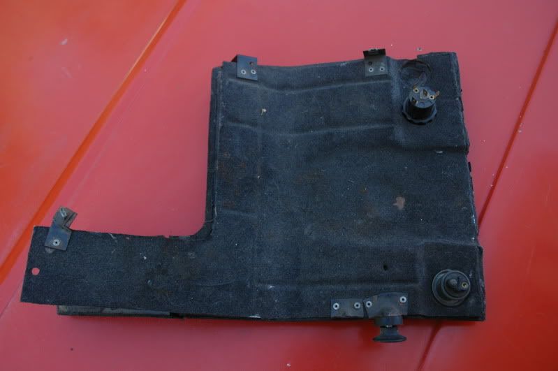

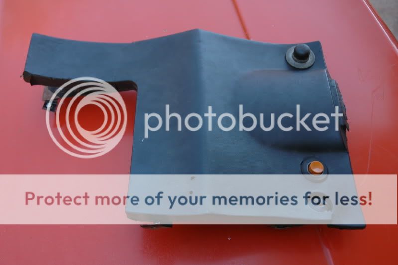

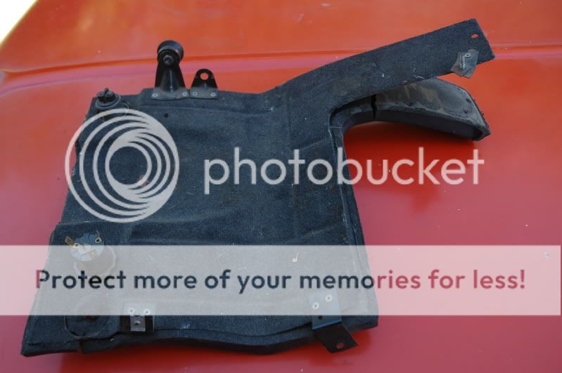

The first thing I had to remove when I got my E9 was the knee panel under the steering wheel..... The wiring was a mess and the ignition switch was bad.....
I have to admit I didn't pay close enough attention to how it was mounted.....
6 months later I drilled out the loose pop rivets holding allthe brackets to the backing steel sheet of this panel...... Mistake #2 not taking pictures of the placement.....Another month later I manage to repair the panel by completely removing the foam and vinyl from the steel...Cleaning the parts and vacuum bagging the 2 back together using gorrilla glue....
Now I need some good detailed pictures of how this panel is installed in the car.....Anybody have any pictures of how this thing goes back together? Usually i can figure it out from the parts catalog pictures but these don't seem to show up at all....

I don't have pictures as once it's installed it doesn't photo well.
1. On the right side is a sheetmetal bracket- a screw attaches it to the left side console near the rear of the same. It's nearly hidden.
2. Where the preformed wire limit is for the fuse cover panel there is another bracket panel on that knob that's held by a screw. Tip- I put the bracket on top of the hole with another screw so it all lines up with the dash.( I replaced my middle panel; so that may be a factor.)
3. The bottom leg is just another sheetmetal screw in to the footwell.
The biggest issue for me was the sheetmetal piano hinge- both of mine were frozen up so make sure you get them working.

Anybody have just pictures of the panel, after it's removed, so I can be sure of the bracket placement?
DaveG
BarryG,
PERFECT!!! Thanks so much! That's EXACTLY what I needed.......
