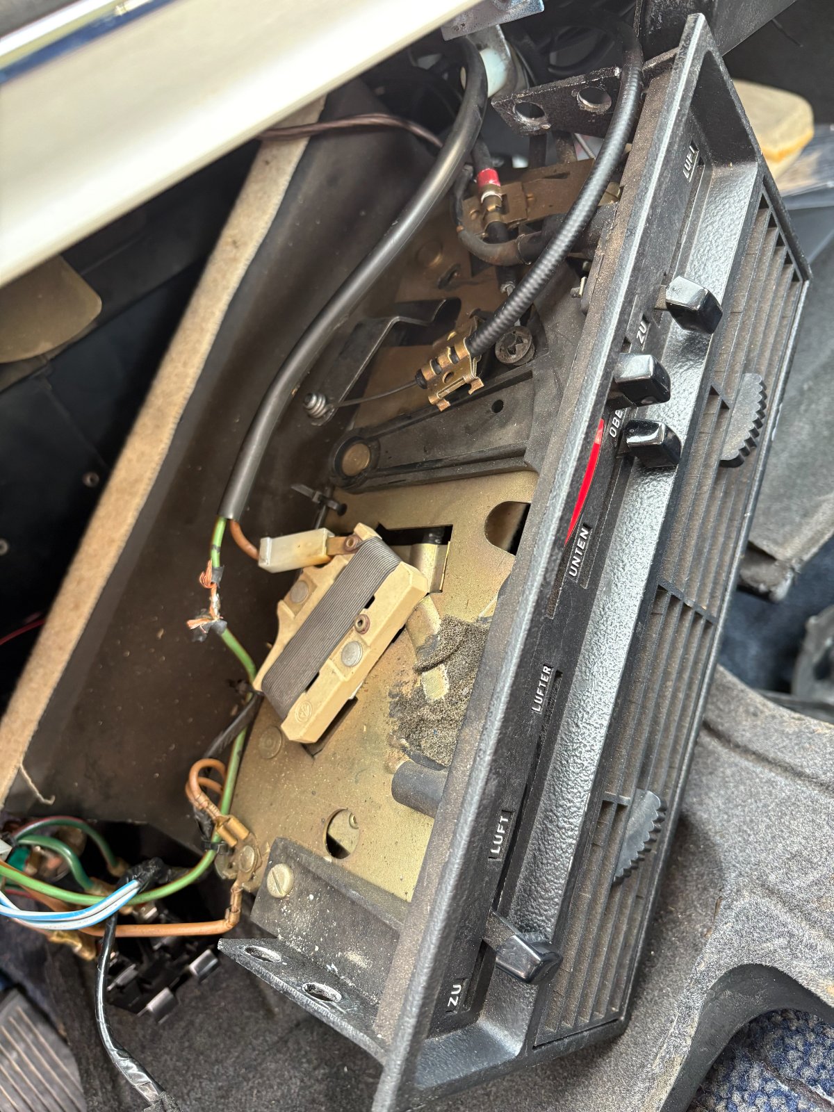

I successfully identified the faulty circuit using the light method. The light would shine full power. It comes from fuse #5 (lighter, power antenna). I however noticed that the light is still a little bit on when removing the fuse. So there must be something else draining, but just à little.
I disconnected the lighter, and just to make sure, the rear window defrost. But I still have the same problem... Whatta PITA. I'll keep searching... Last summer I did a lot of restauration, like repairing some electric wires, and so on. So I have to double check.

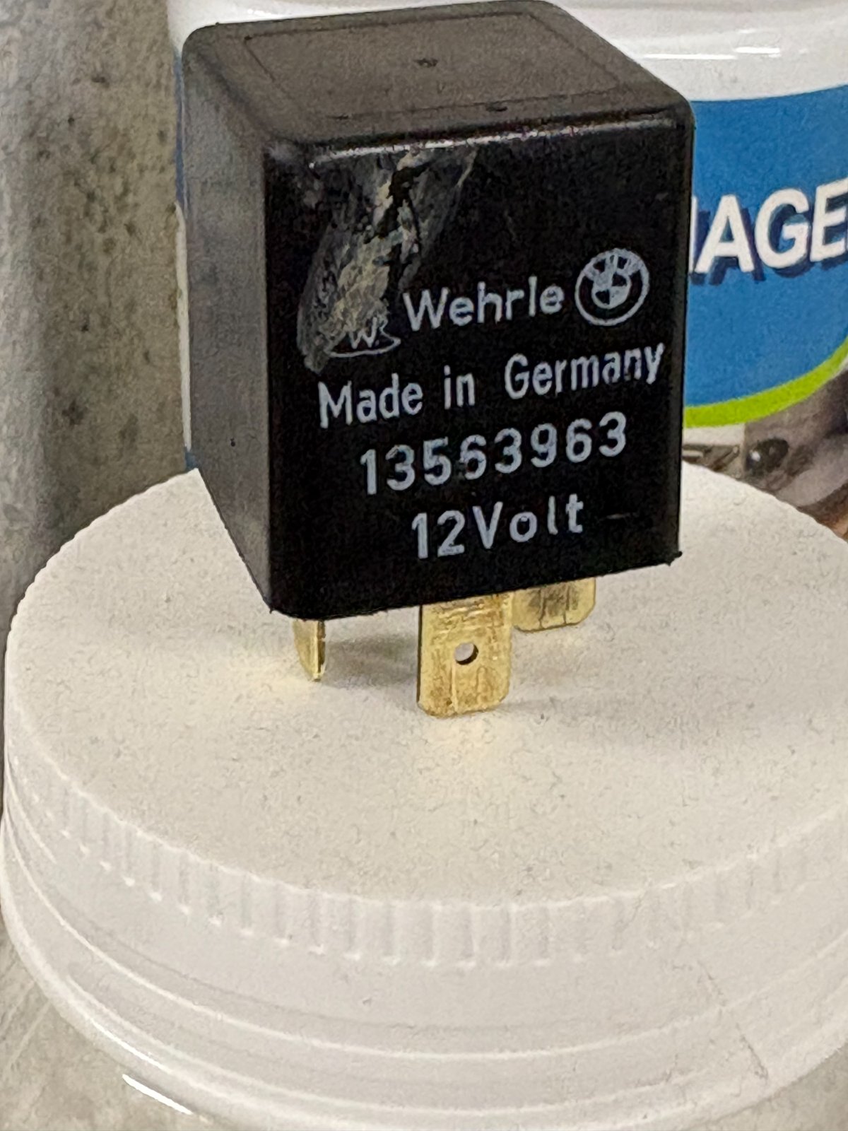

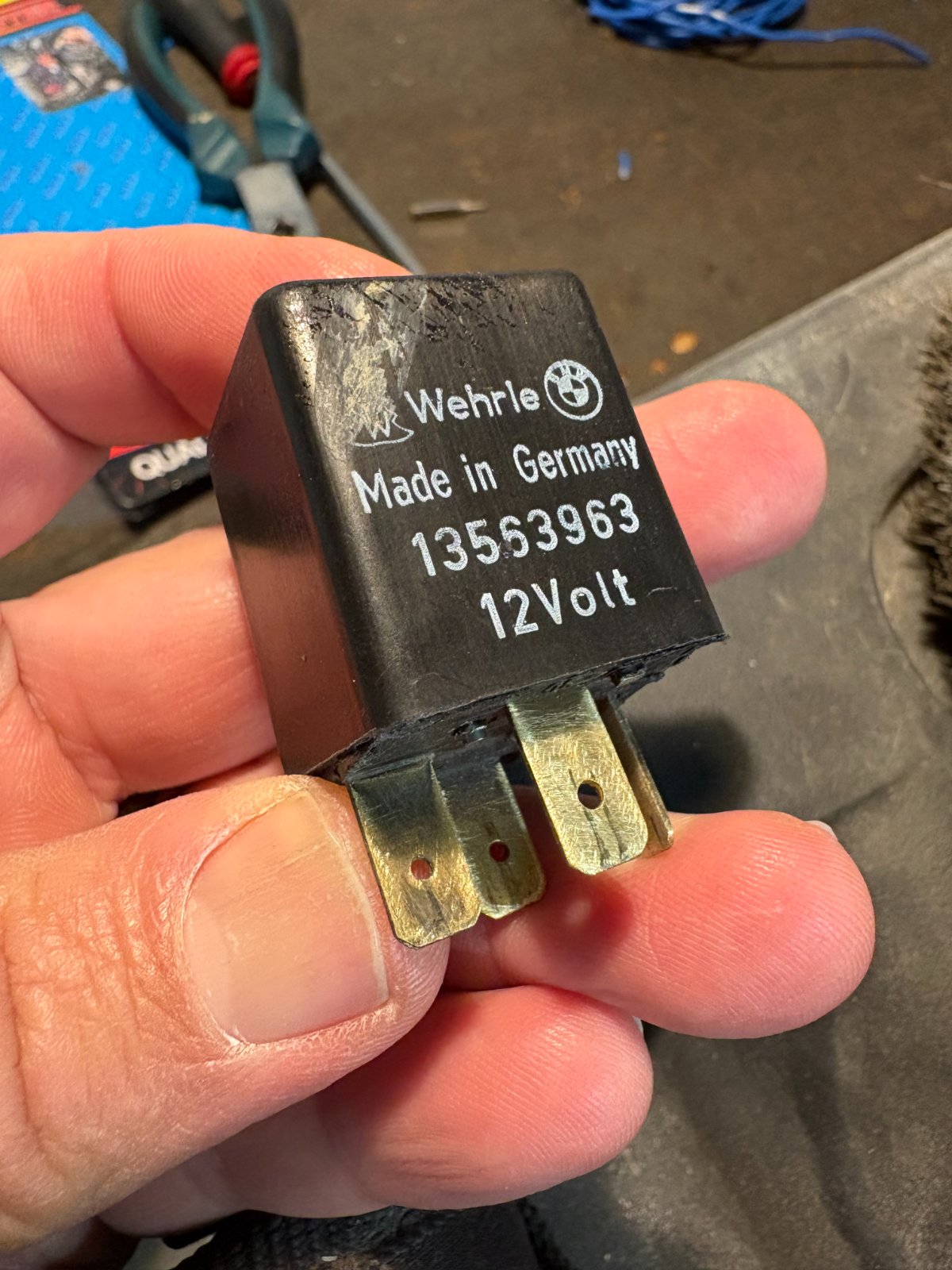

To those who may be interested, I finally located where the draining battery comes from: the culprit is the low beam relay. So I followed @boonies advice, using the light method on the battery. Now my problem is that I cannot get to find that Wehrle 13563963 relay on the Internet. No nothing at all. No info about it, no equivalent...
- I am 100% sure this relay is faulty because I took one identical from the engine bay, and all got back to normal
- Since I couldn't find what kind of relay it is, because no diagram on it, I bought a standard 4 pin relay, and tried it, and it was unsuccessful (batt was still draining)
- I bought a 5 pin, just to give it a try: unsuccessful
- I bought a 3 pin (blinker type): unsuccessful
So I need to search info about this relay.
Can anyone help me?

This looks like a standard relay, but you say that a regular 4-pin Hella or generic relay doesn’t work? Can you take a photo of the connections on the underside so we can see the configuration?

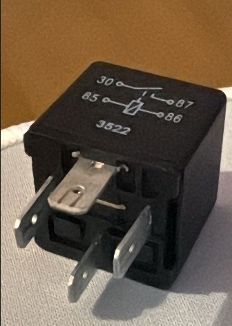

Here is the standard 4 pins relay that I tried out, and didn't work.
Or, partially. Let me be more precise :
- When I plug it in, with no ignition on, I can clearly hear the solenoid energized and a small click, which makes me believe that the contact closed.
- With the OAM Wehrle, no noise
- And when testing with the lamp, it slightly shines, so some current is running. Which does not happen with the OEM Wehrle...
For these reasons, I have come to believe that the OEM has a different wiring. I even thought It was wired as a 3 pin relay...?

You aren’t showing the bottom of the relay to display where the pins are located
What’s odd is that the relay picture you’ve shown has the standard wiring - 85/86/87/30 in the usual configuration. But Don is right, maybe just replace the engine bay one. From where did you pull this one?
Ah, is this picture the replacement? Yes, show us pics of the one that works along with any labeling. There may not be a label on the side like the Hella but sometimes there is a small raised number next to each pin so make sure to capture that if it’s there
Are you talking about the OAM Wehrle ?
Pins are displayed just as on the new Hella. But unfortunately, there is no diagram on the OEM one. That would have been soooo helpful..
