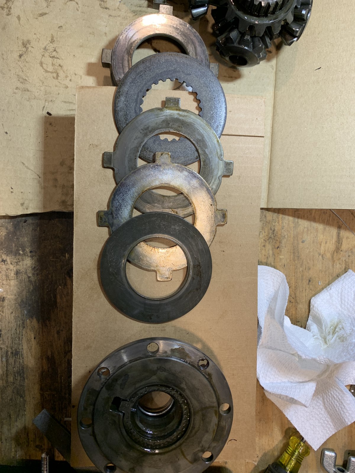

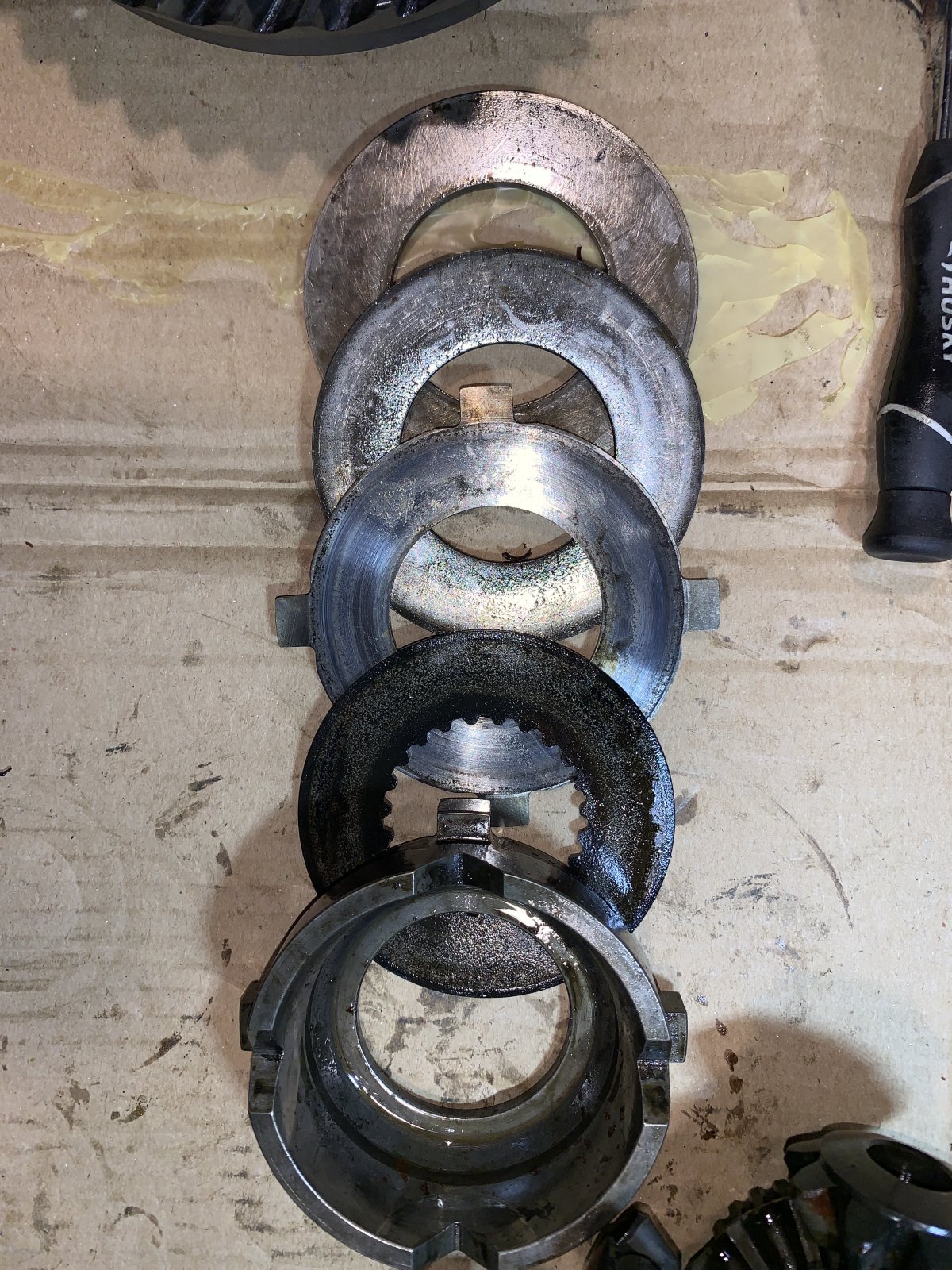

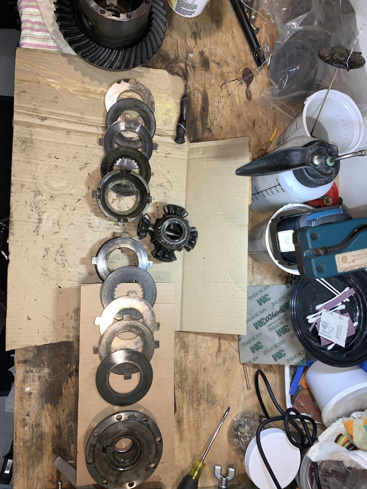

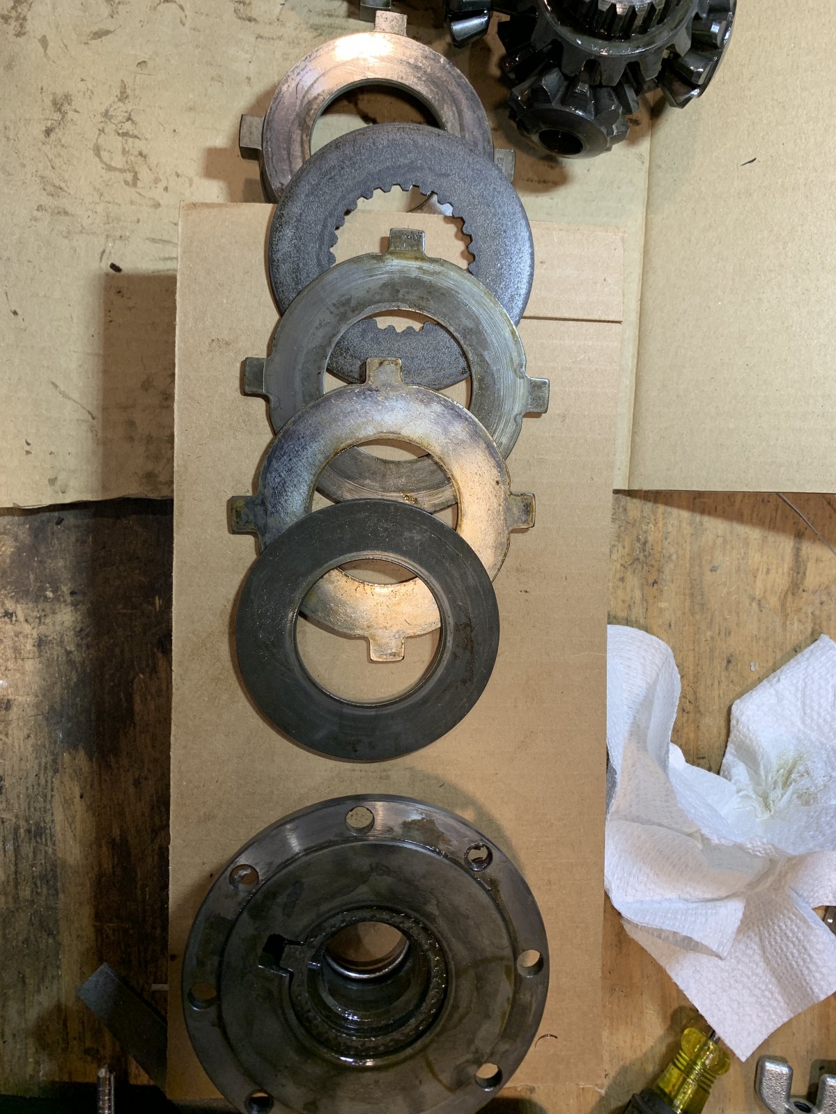

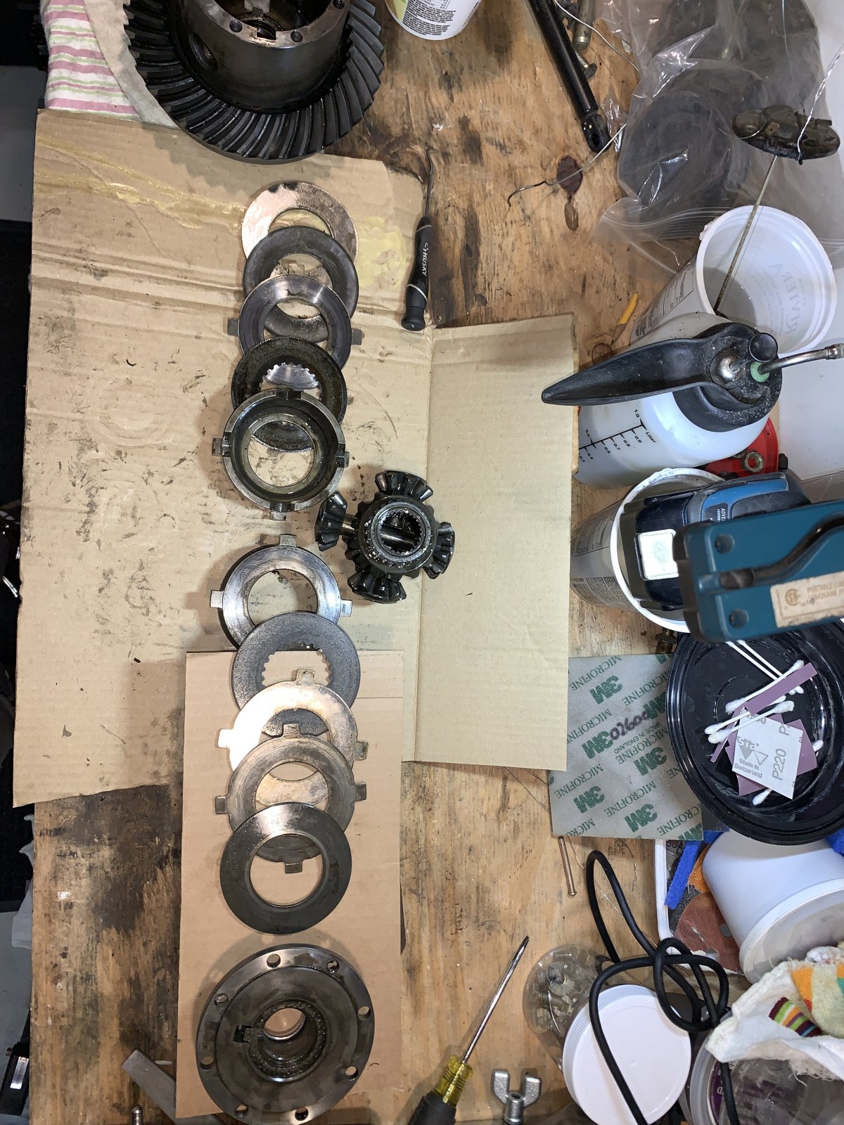

Well in the interest in keeping this post going, I took apart the LSD carrier and cleaned and oiled everything. No obvious damage, everything looks worn and stained but not terrible. Funny to see two clutch plates on one side and only one on the the other but its how it should be according to the page in the e12 service manual. Put it all back together and its now unlocking and spinning. 43 ft/lbs break away torque according to my fumbling efforts. comments??
By the way Ian C, you said preiviously 25% and 40% are very different animals, I believe the difference would just be a thinner spacer and another clutch plate? or something like that. I'll be measuring the plates and emailing results to streetdriven soonish. Need to take it all apart again.

Sending the scans of the pages tonight, yours is another arrangement, similar to the 25% used on e9s.The early 40% have to be unbolted from the crown wheel to open, at least 2 versions with different types of plates, different number of plates, no belville plates no preloaded breakaway friction,and different depth of the can. Yours resembles the 25% much easier to deal with and a test by torque wrench possible. The 40% has to have the internal components places under a 200lb load from a press to take a measurement, then select thickness of plates to suit can depth. I'm hoping the dimensions and spline count of the plates from Streetdriven will match the early diff I have, then its a matter of the thickness. Ill be happy with any percentage of lock that's not going to make it feel like a drift car, really want the 3.45 :1 ratio.
