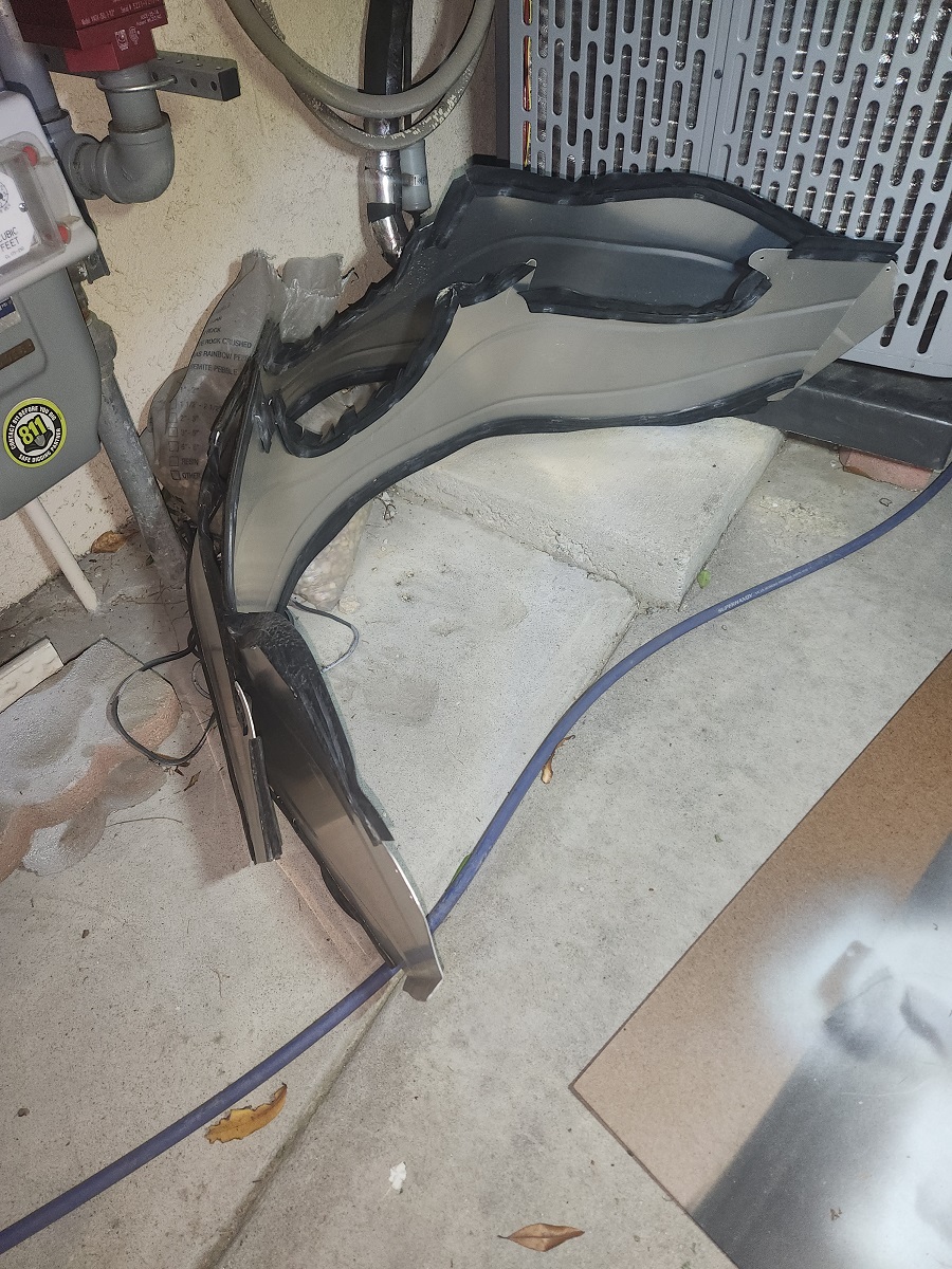

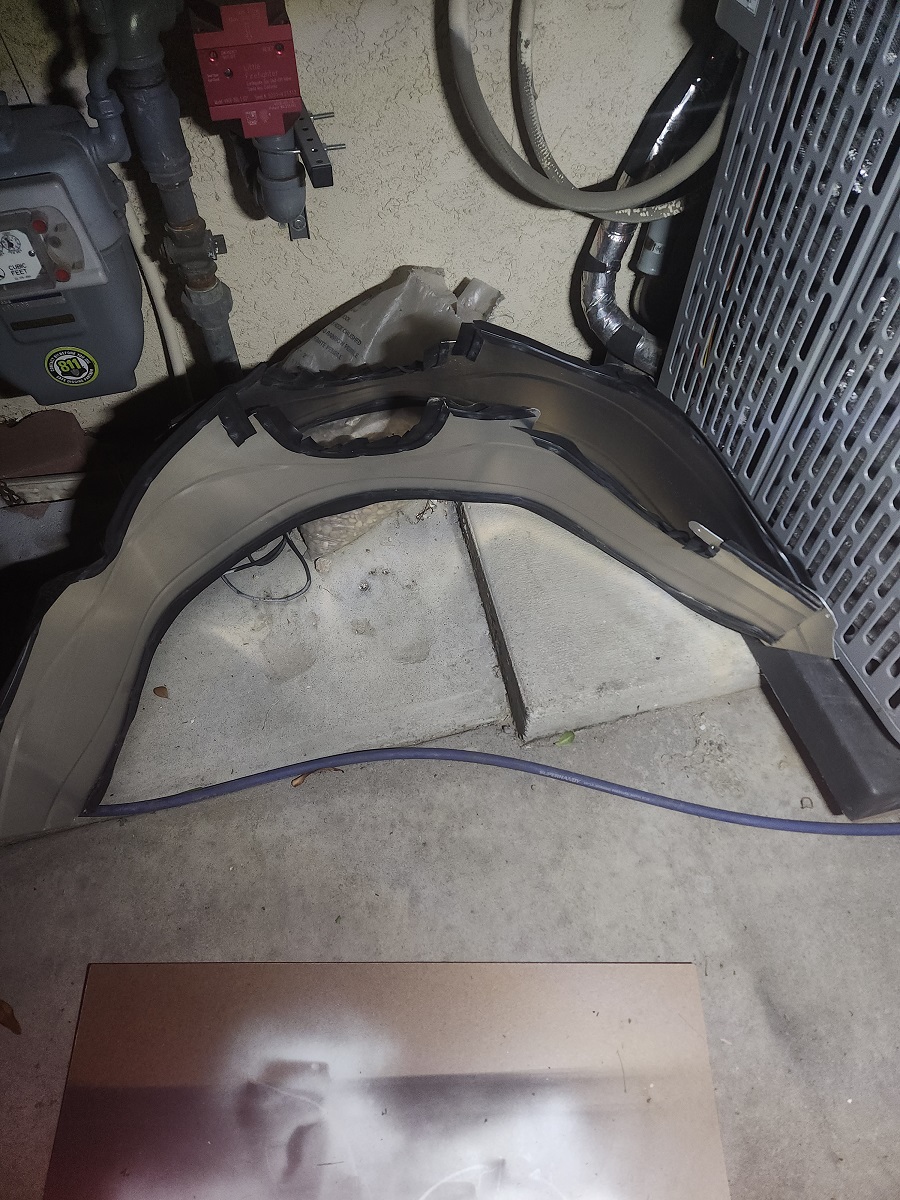

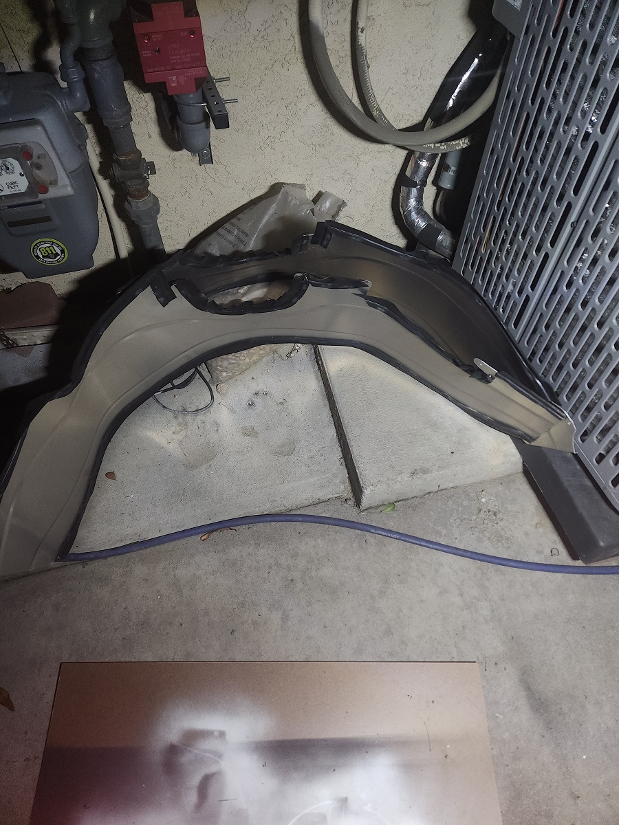

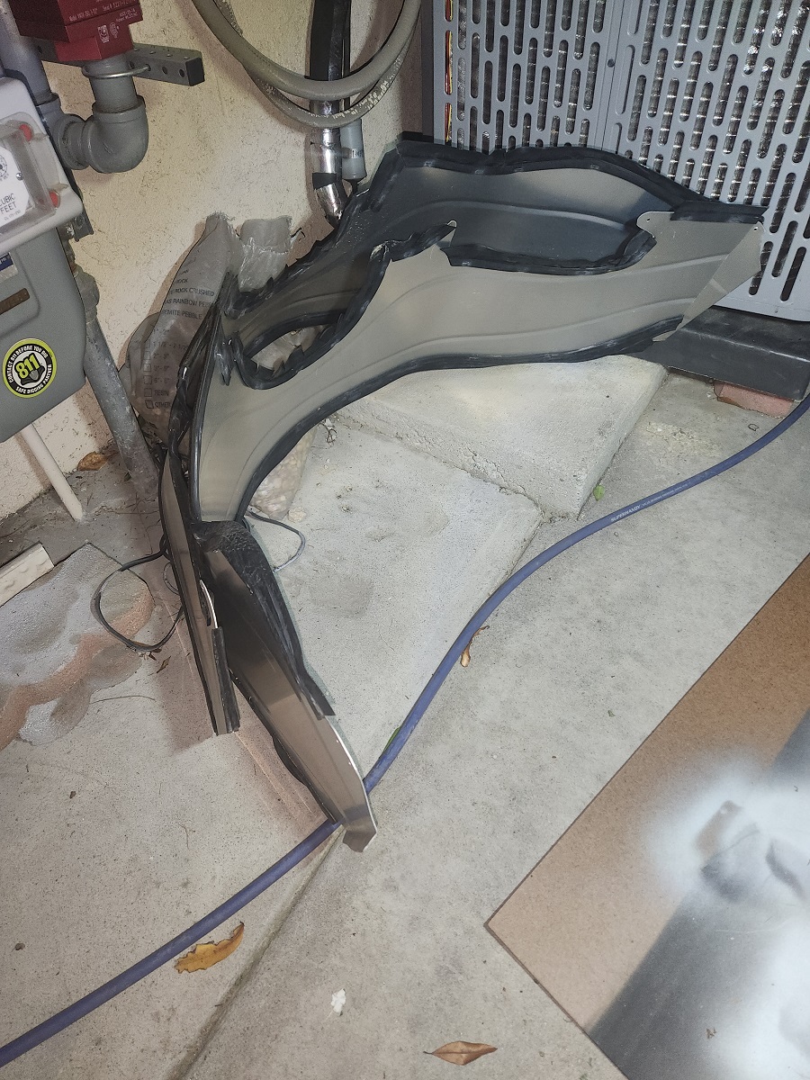

Hi Don, have you ever got in LA, If you ever come don in LA stop by please and take a look at my 3.0csi with M3 engine, that I submit it to BAT waiting for an answer and I got a gift for you, I got this under fender aluminum cover but couldn't install and don't know what to do with it it is so big I can not mail it there is no that big of box to post it, if you ever come down and if you can use it for your car pick it up. I hope to see you down in LA.
