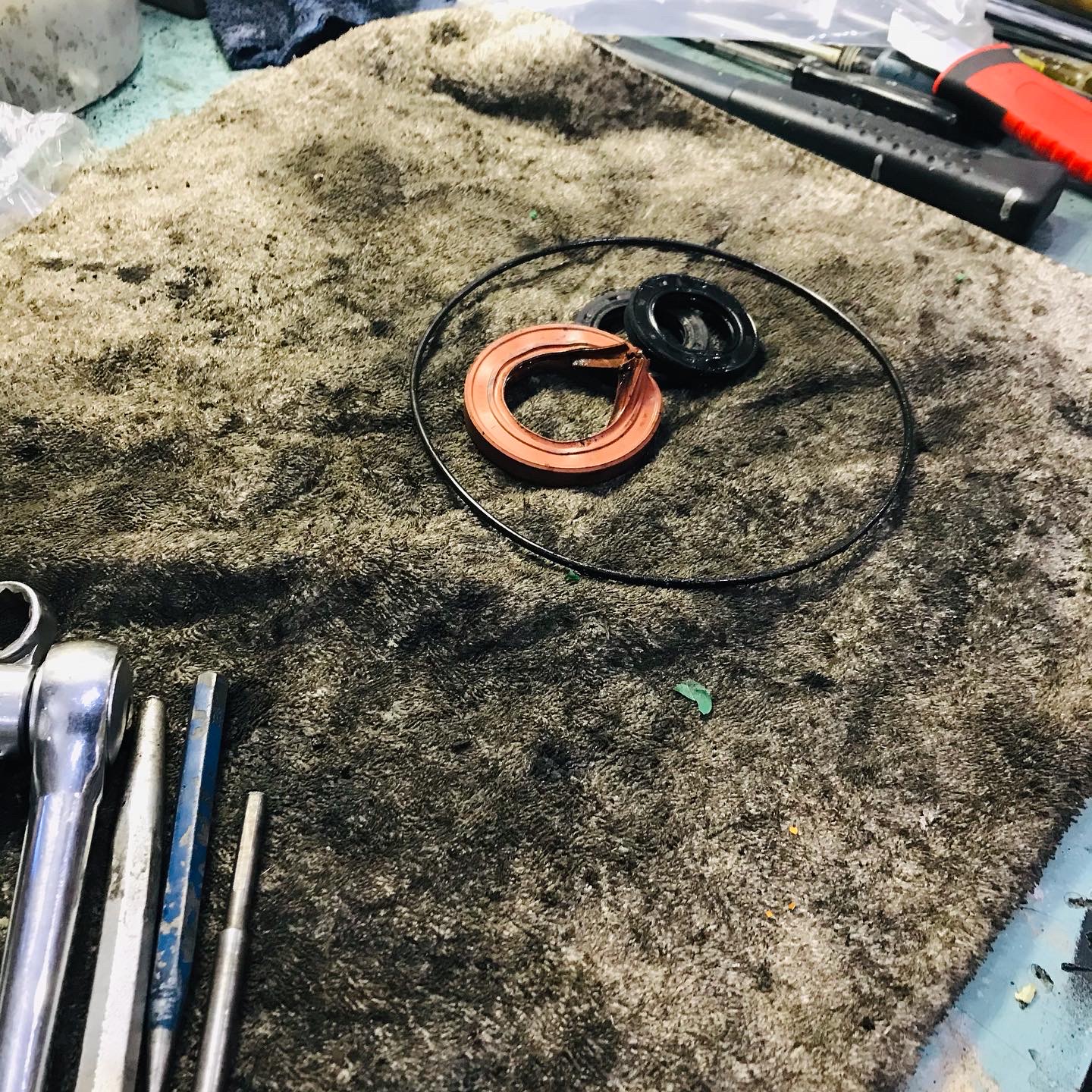

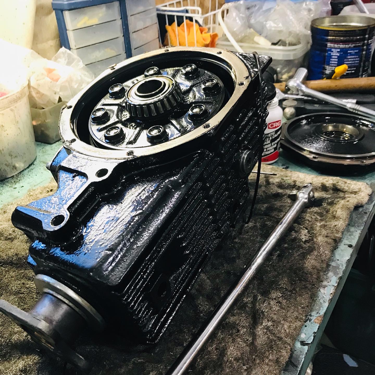

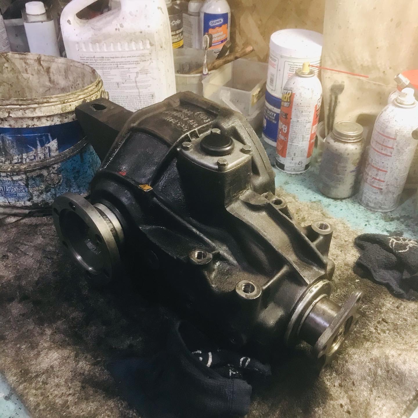

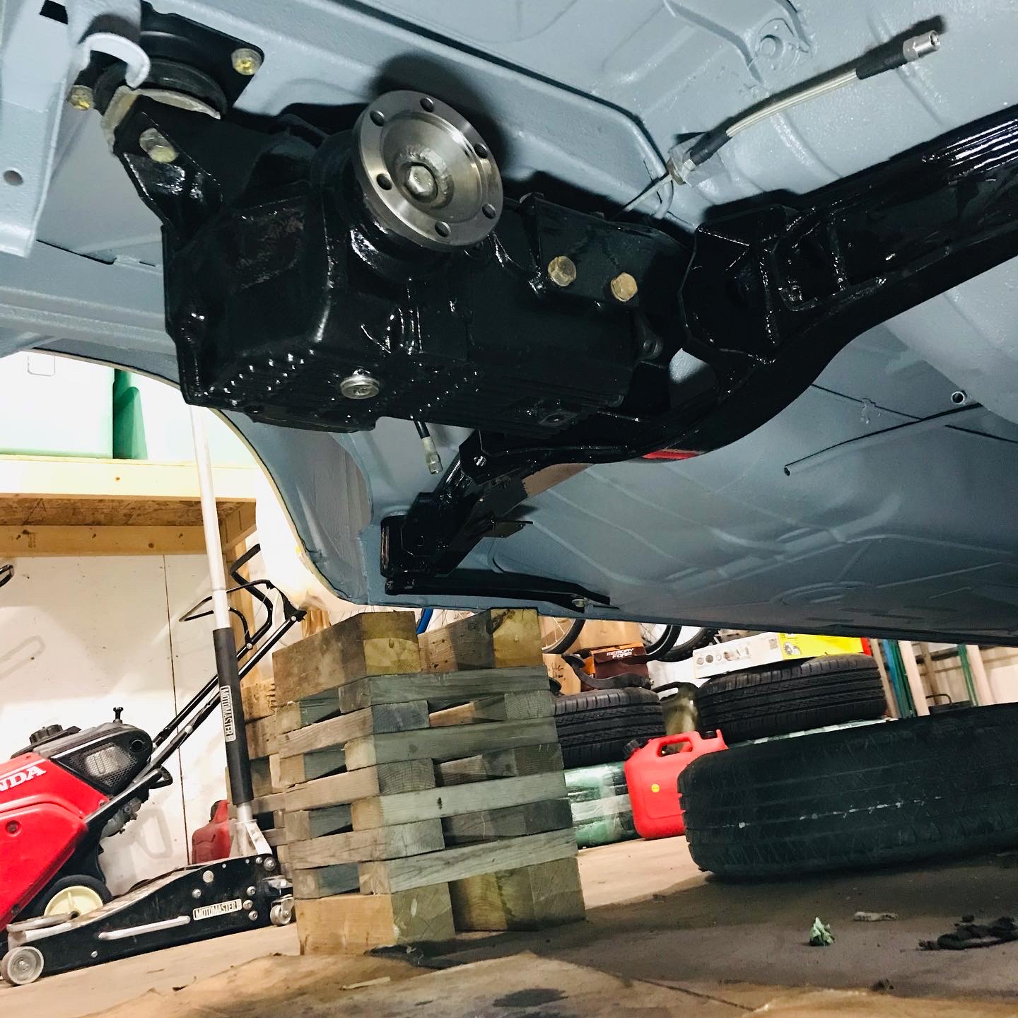

HI Forum!
Replacing the seals on the differential and reinstalling must be one of the most straight forward jobs there is on these cars. That said...most jobs on the E3 and 2002 are straight forward, IMHO. The most challenging aspect always seem to be the cleaning and prepping for each task. Thank you for the feedback!!
Regards
Bill
