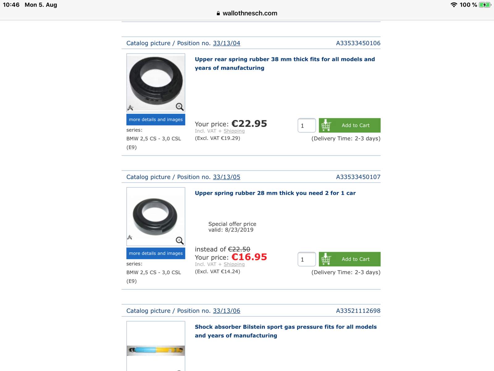

Does anyone have one of these off the car so they can measure the inner and outer diameter?
My suspension set up is how I want it but I want a bit more height at the rear to improve the stance. I intend to make some spacers in steel to put above the rubber dampers.
Thanks in advance.
Take a look at the W/N page, those rubber spacers can be bought in different thickness.
Maybe just getting the thicker ones will do the job, obviously assuming you don’t have those in already.
The fatter rear spring perch was for US cars. In conjunction with the aluminum spacer that was installed at the top of the front strut, this fatter spring perch maintained the original rake while increasing the entire ride height of the vehicle so as to meet US requirements as to headlight height.
Nice to know these are higher but I was hoping to make some rings as spacers. I think that 10mm will not be enough to lift the car to where I want it to be. If someone has one lying around, and simple measurement will do, nothing to any microns or whatever.
Could you use 38mm spring perches on both the top and bottom of the spring to get a 20mm ride height increase?
Doubt it, the bottom are standard for all the cars. Only the tops are variable as far as I know.
