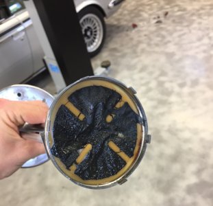

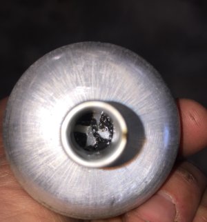

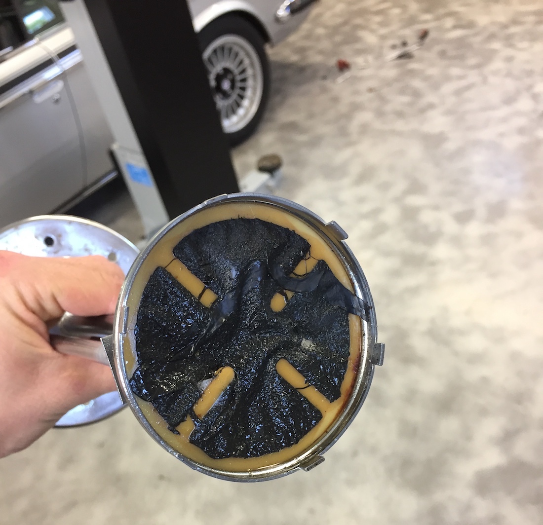

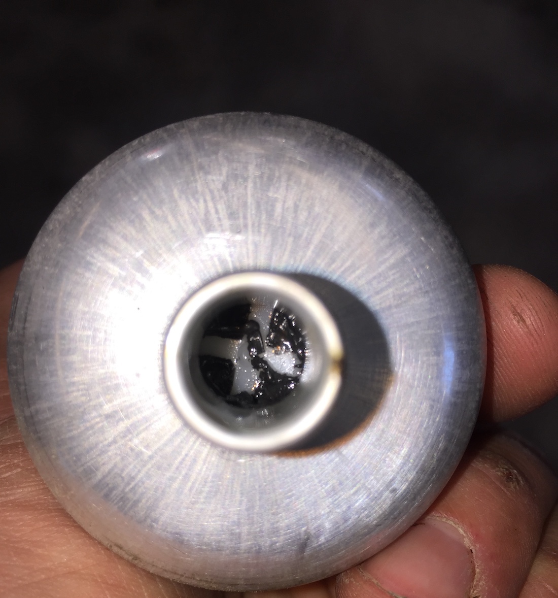

Dohn, your problems certainly sounds like a vacuum issue.
I installed a brand new tank in my coupe as well, and while I didn't have a problem with vacuum (vent line goes out under the trunk) there seemed to have been some paint inside the tank which I didn't see when I installed it - so it slowly mixed with the fuel and clogged up filter and fuelpump and gave me fuel starvation problems. Just a thought.
