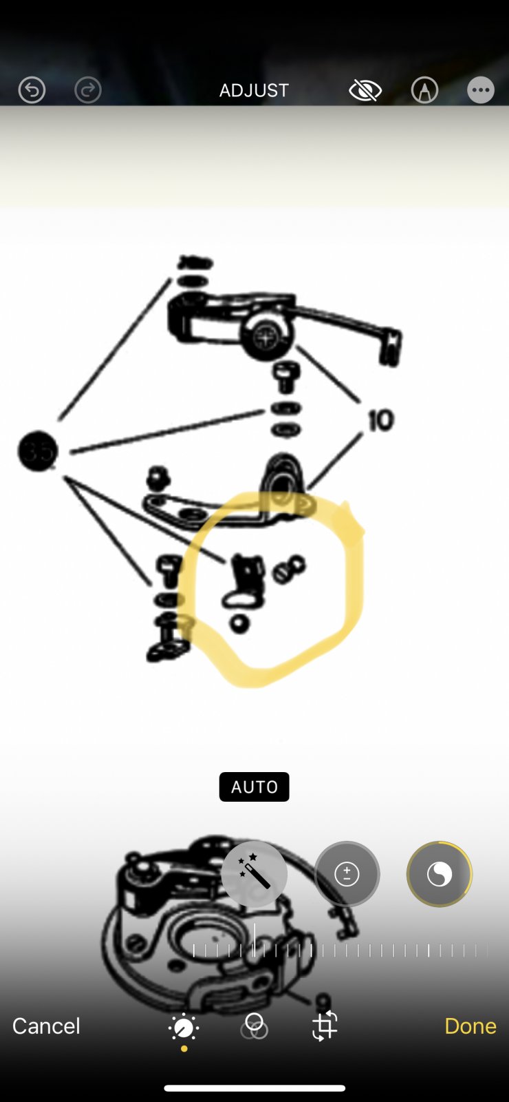

Gents;
Thanks for the comments and good will to help out. The swivel plate seems to operate properly, it twists and returns, I’m attaching a picture of the piece that broke that I fabricated and replaced…I don’t think that it serves as a ground point or anything like that…..
I will use the E3 distributor as it is identical and see what happens, I just didn’t want to mess with it because I would have to redo the whole timing procedure upon return.
