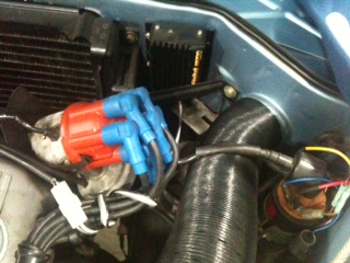

Hi Guys.
Looking to replace the ugly "Fireball" EI w/ a concealed Pertronix. Can anyone identify the type of distributor in my coupe?
Thanks.

It appears to be a standard version Bosch. On the side of the body will be a series of numbers stamped which will tell you exactly which one of the several BMW used. ( All basicaly the same, maybe a little different advance curve.) The workbook will tell you more after that.
The Crane Fireball box is a multispark; as like in MSD.
A pertronix that fits a standard distributer for a BMW 6 cylinders will fit with what you want to do. Carefully identify the wiring on the Fireball to revert back to a more stock wiring with Pertronix.
Hope this helps....
It appears you have the correct dizzy with advance and retard vacuum lines and are good to go but make sure. Early coupes had advance only and take a different Pertonics unit.
If you want a pertronix set, i have one available. I bought it 2 weeks ago from Carl N. While it was on its way to me, i happened across the Mallory mechanical adv. dizzy that i've been looking for for years and bought it (i'm running triple webers so the vac adv/retard does me no good). So the pertronix is up for grabs. From the pictures, it looks like you have the same stock distributor that i do so it should be the correct unit. I would call and ask for a refund but i think i'd rather just resell it and take a little hit and do my part to help keep shops like Carl's going. If you are interested, let m eknow and i'll shoot you the part number so you can confirm that its the one you need.
