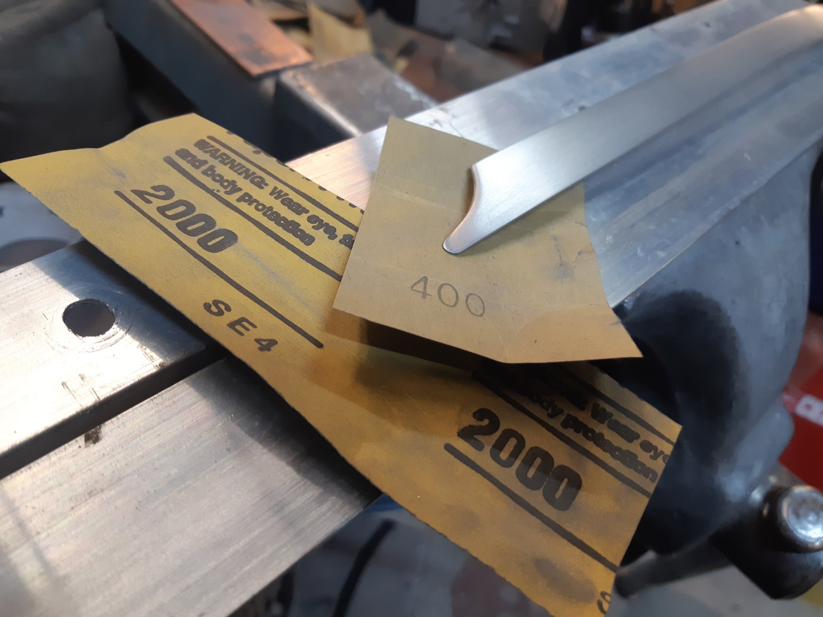

@tferrer ; you're right, on the thin polished bright trim (as per original posting) going to 80 grit is a gamble. .
I had the 80 grit in mind as I redid my center console and dash grab rail. These had some serious scratches, and I did start with 80 grit, but then again these are not polished to a mirror shine: they keep their brushed look: At about 400 grit the appearance was as factory for these parts, I finished with a pass of 2000 grit to take the sharp hooks off; otherwise your cleaning cloth with hook to it.
