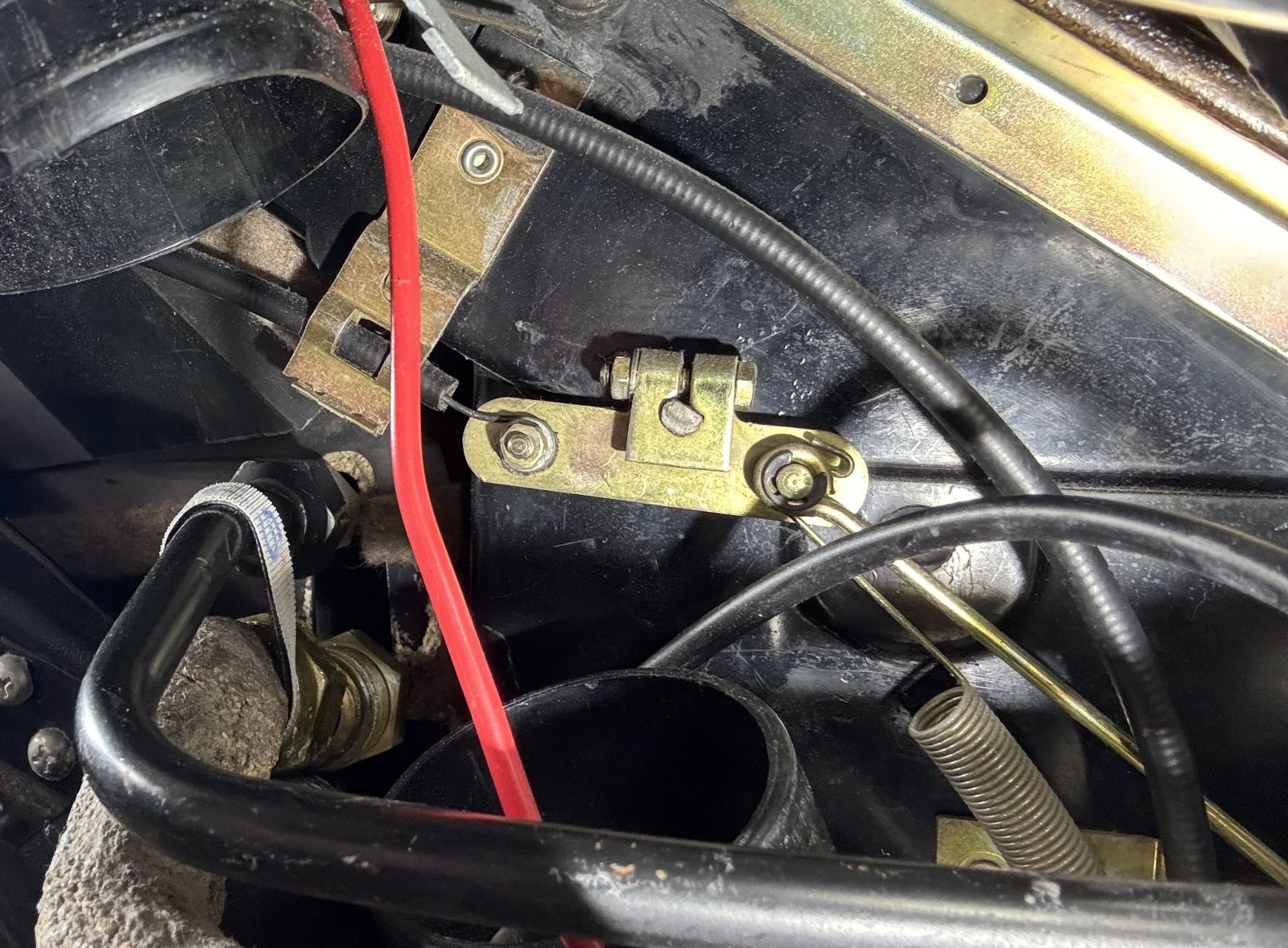

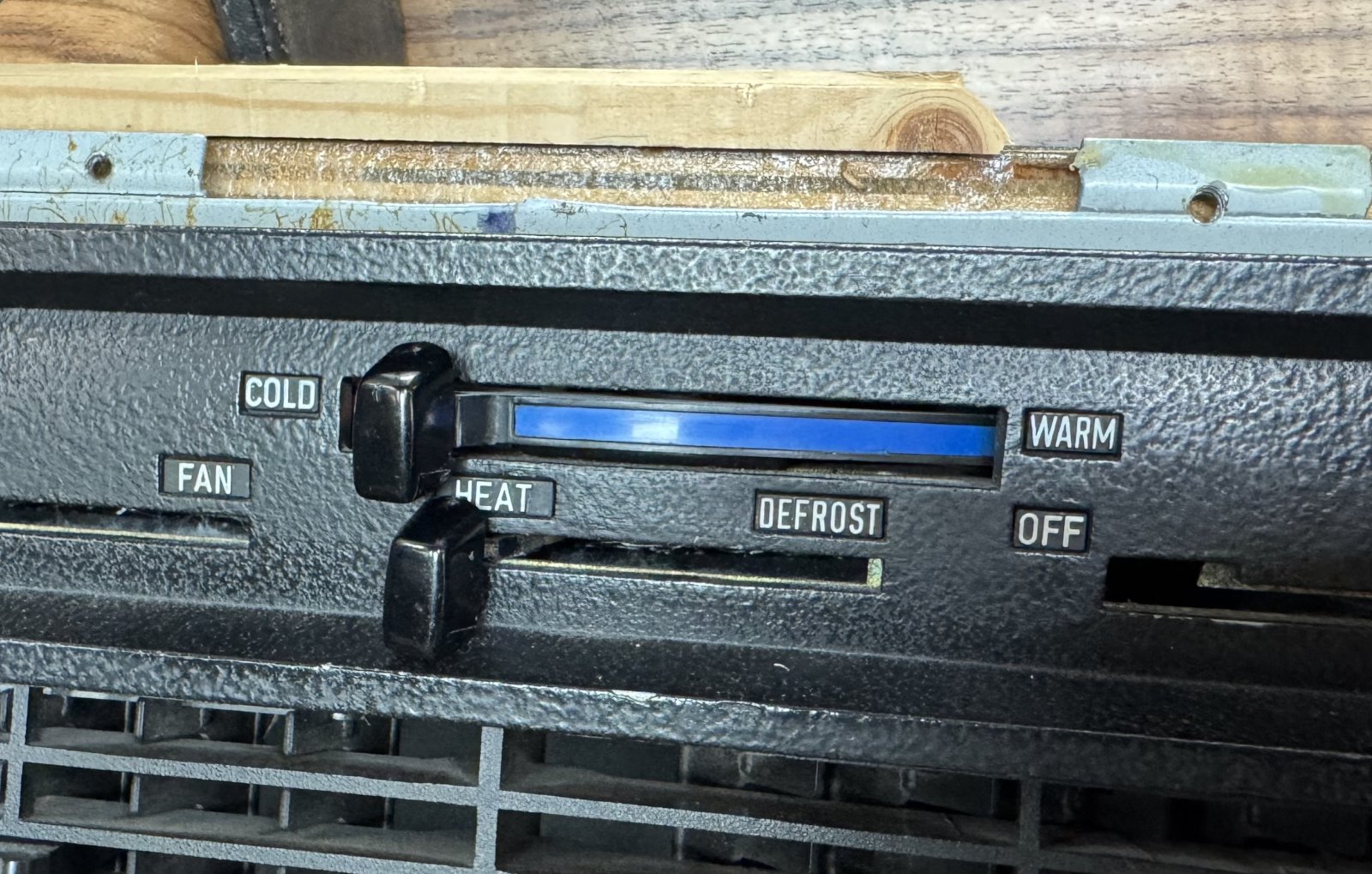

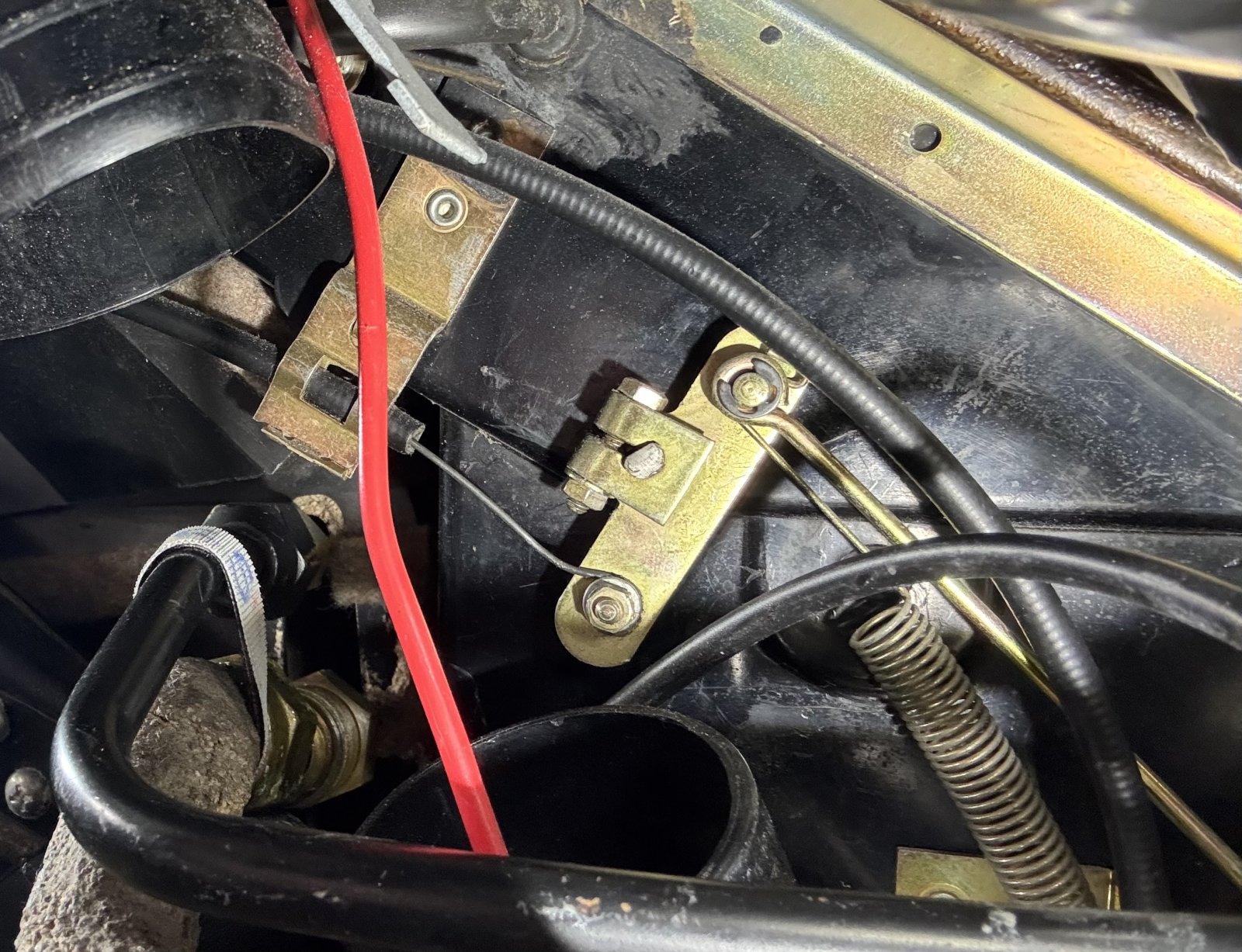

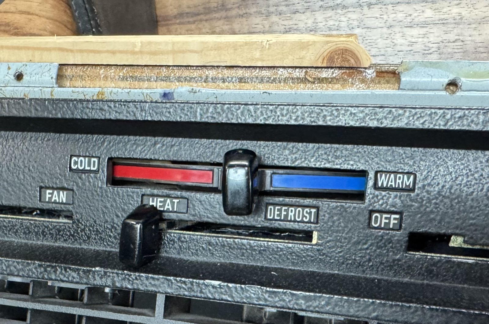

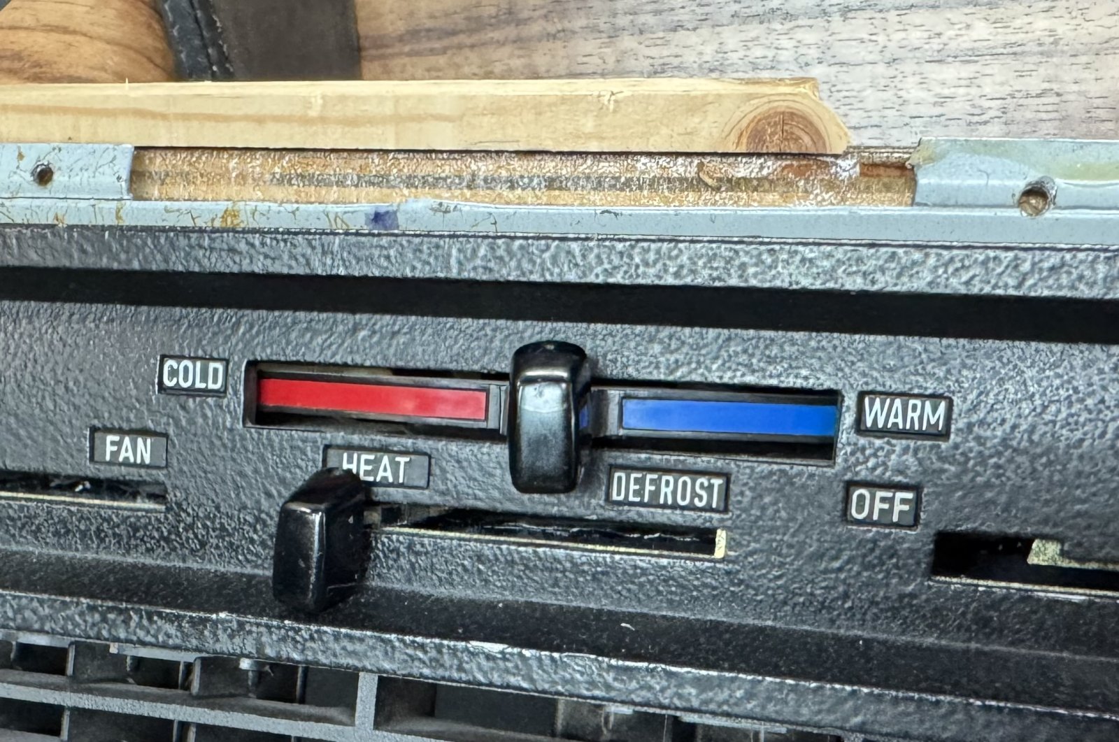

Hi Erik. I realize this thread is 3 years old but I am trying to solve a problem on mine so I was re-reading this DIY.

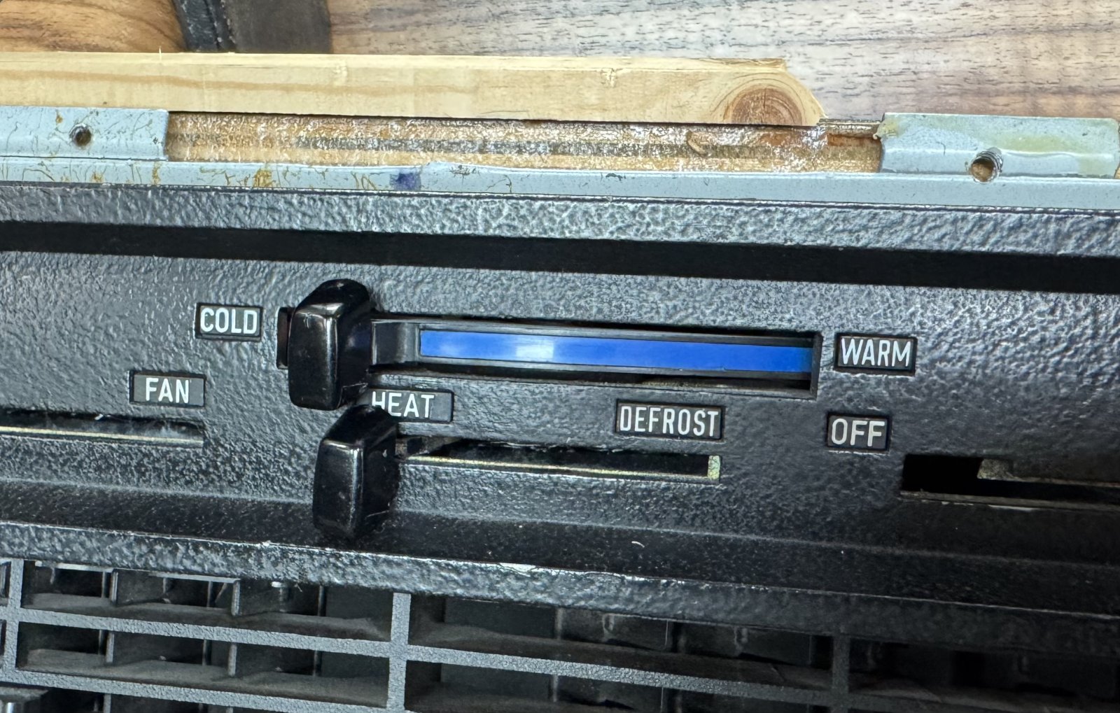

My issue is that the hot/cold lever only moves from all the way left (all blue) to just past half way to the right (partially red). It can't go past that point for some reason.

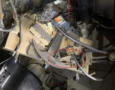

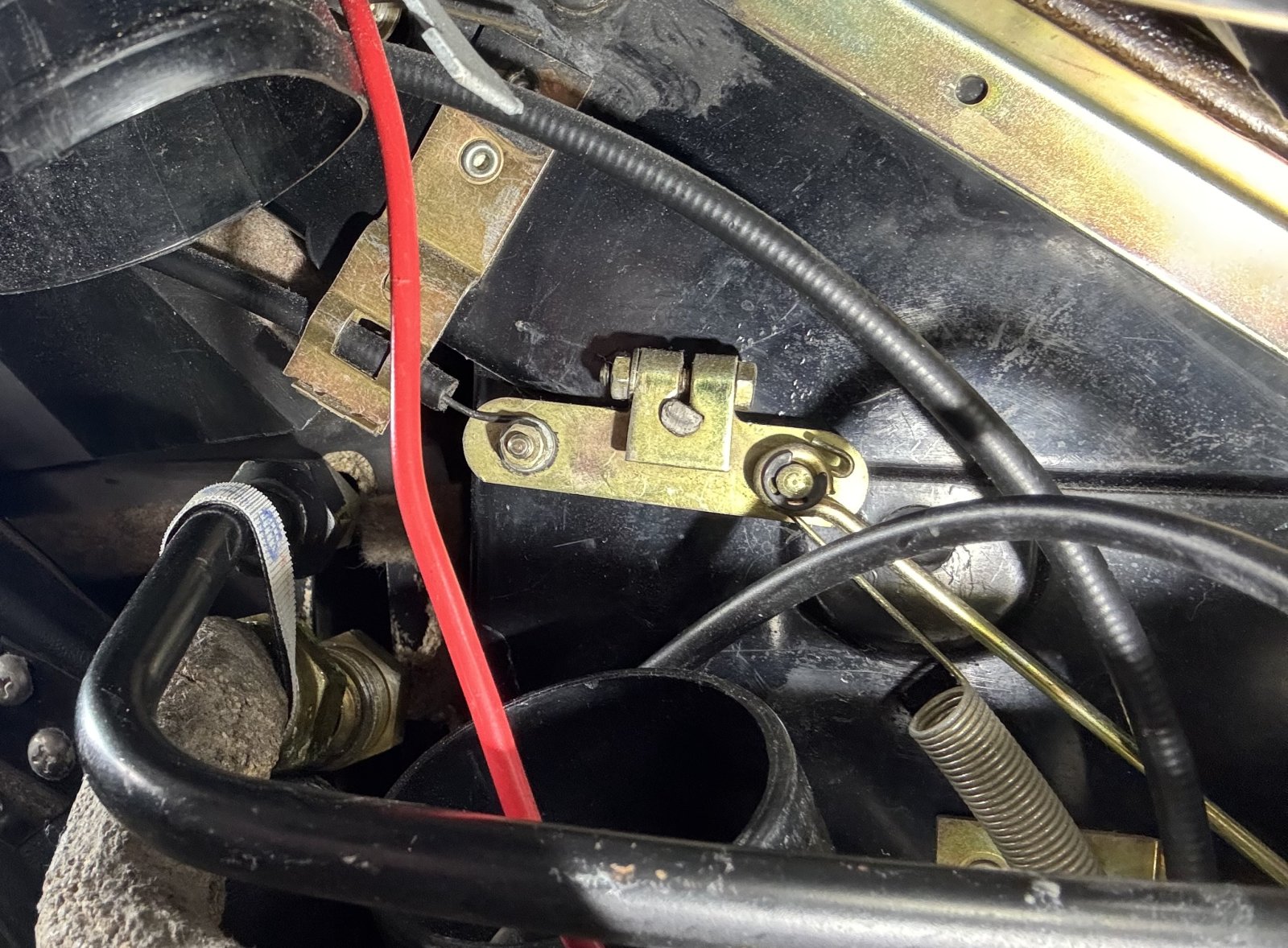

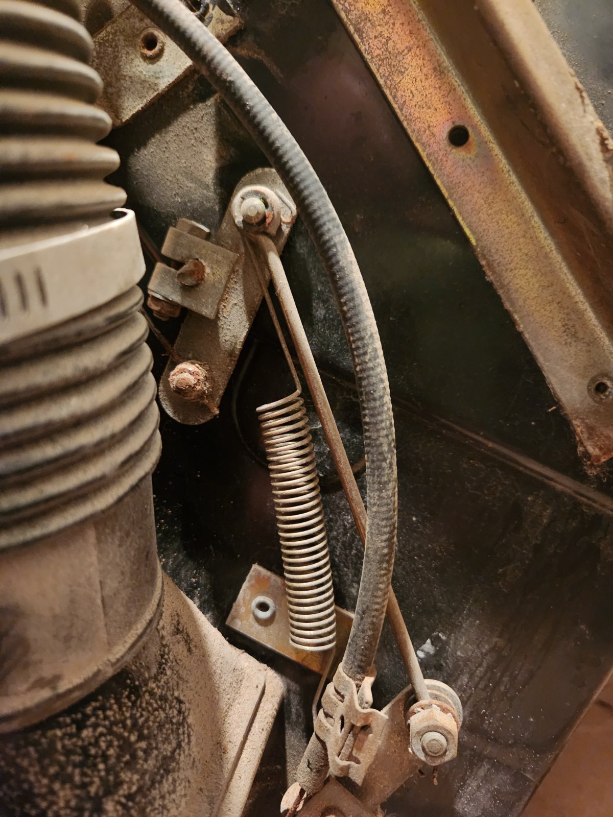

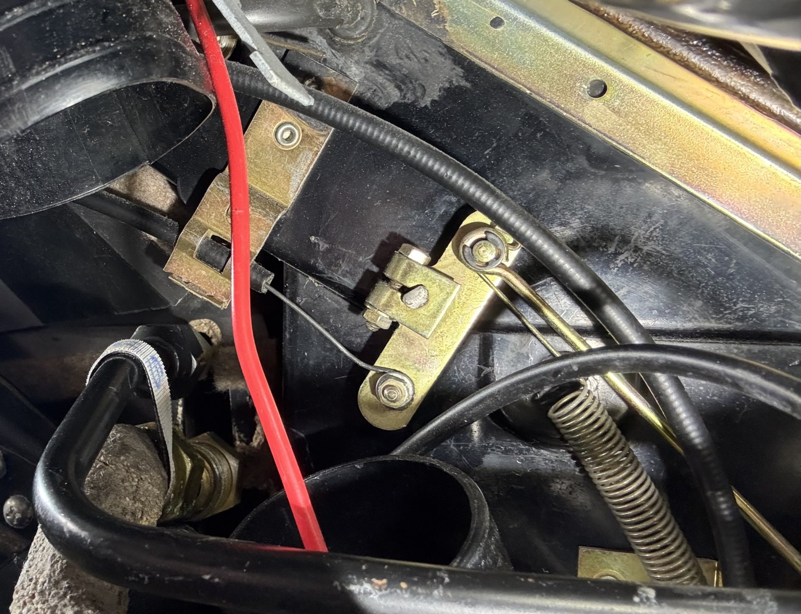

Unfortunately my system is fully installed so I have limited access to the cable adjustments. But when I compare the positions of the flaps to your 2 pictures above, mine are very similar.
Do you by any chance remember if those pics show fully open and fully closed? If so, it would indicate that even though my hot/cold lever only opens partially, at least the flaps in the heater box open and close fully. I then need to look elsewhere for the lever adjustment...

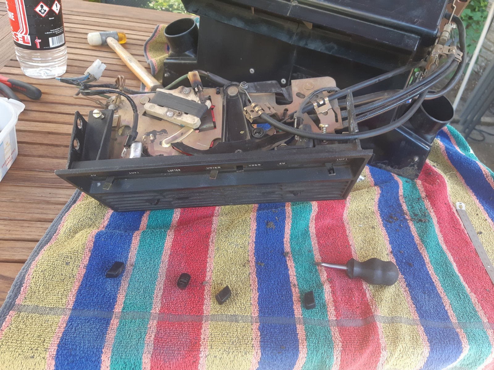

I'm watching this great thread as my heater core is on the work bench for refurb. The picture below is the full warm position of my equipment. The bracket may be a bit more perpendicular to the plastic contour line - compared to Eriks left picture.
In full cold position mine is same as Eriks right side picture.
Very interesting @coupesport . Thank you for that. So it looks like my full warm position is not really fully warm. I can't really see what keeps it from opening all the way…
As mine is on the workbench I'll look at it more closely and if comment back if I see any possible restrictions.

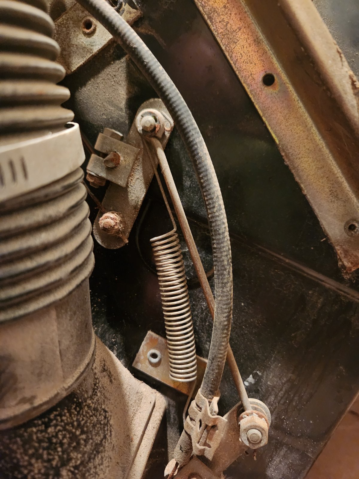

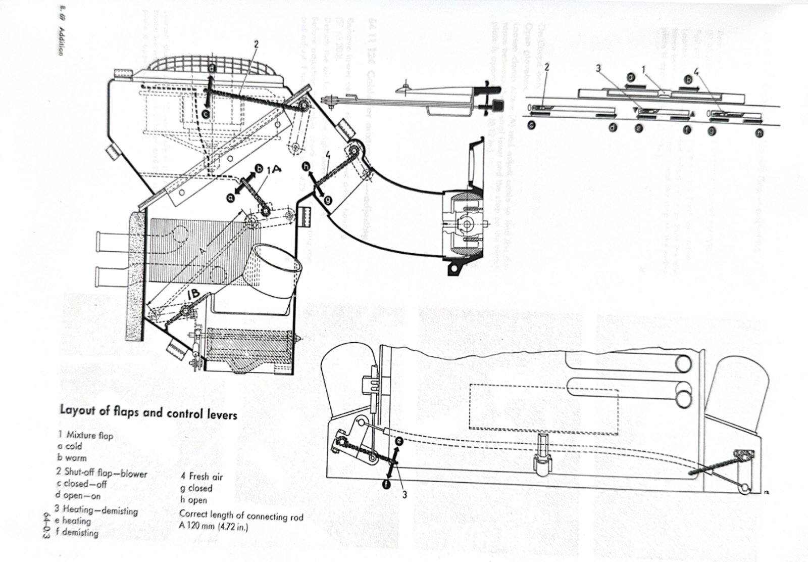

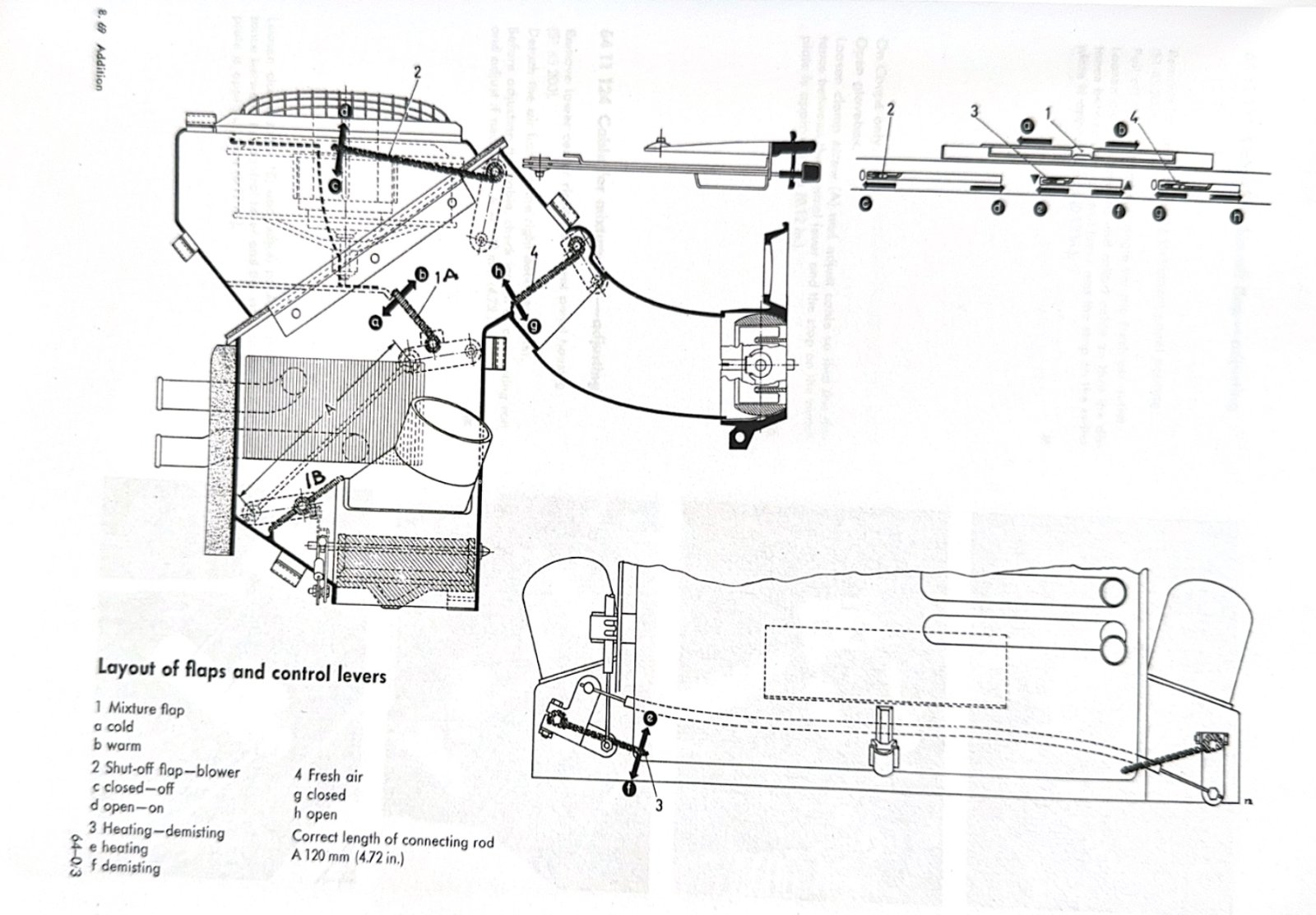

As you can see there is a straight rod making a 2nd mechanical connection.
Yes, that hot/cold lever controls 2 flaps at the same time. 1A and 1B in the diagram. Linked by rod A which is supposed to be set to 120mm

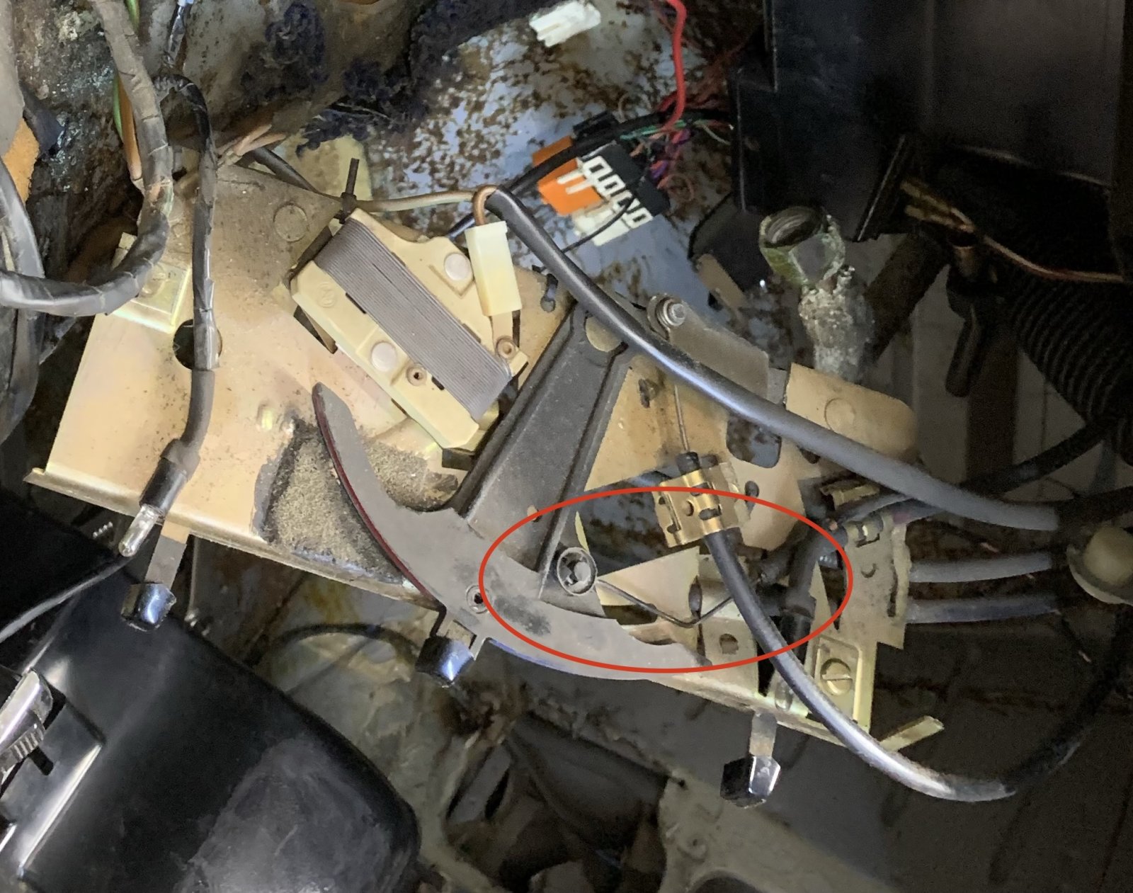

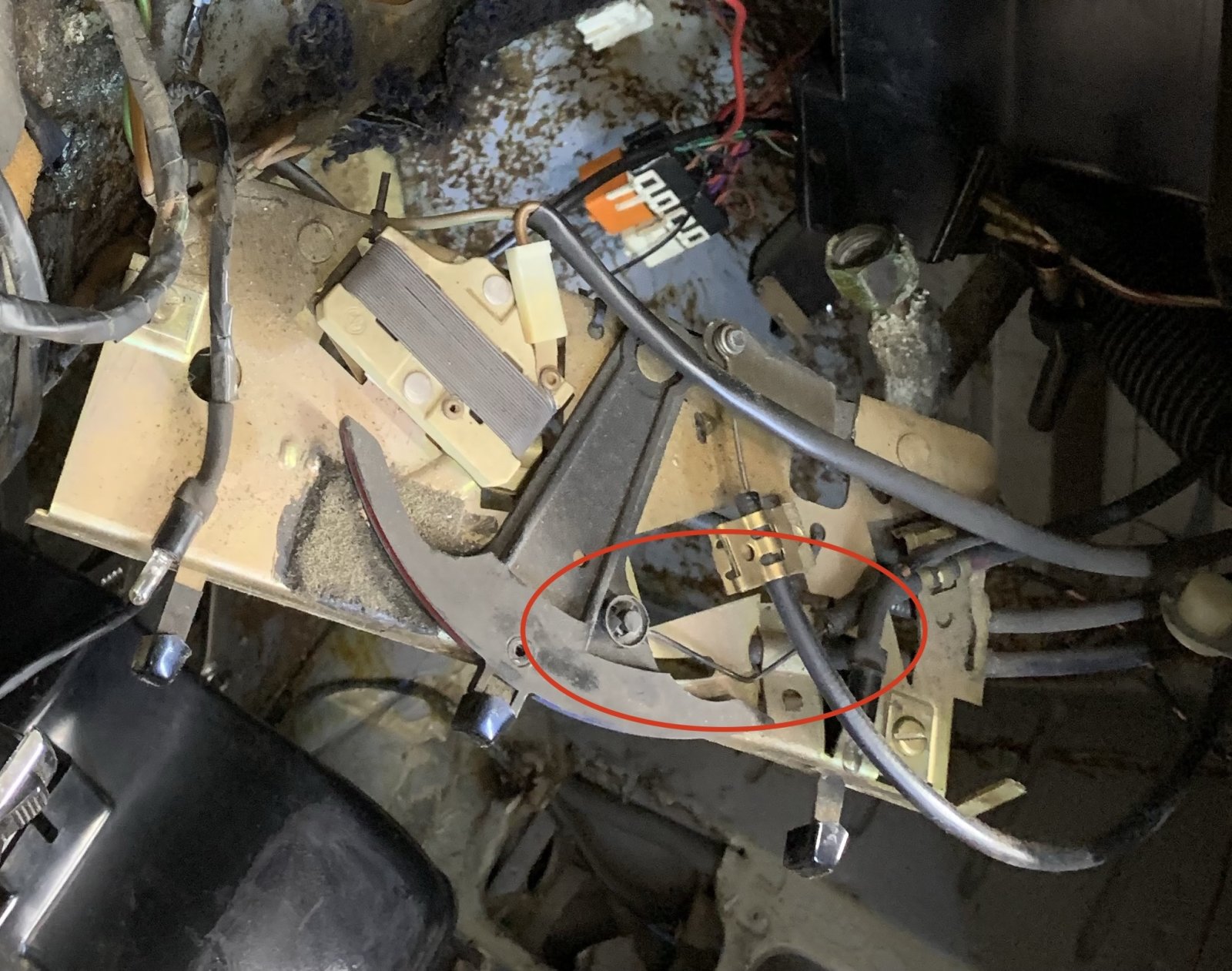

Looking at this picture
and comparing it to mine
it looks like I have a bent bowden cable that should be straight. That can't be good...
Oh man. Last thing I want to do is to take that heater control panel off again!
Sure enough, that was the problem. That cable is supposed to be nice and straight. This bend (or break in the case of another member) happens because people move that slider to the right with too much speed and force and it bends the cable. This will prevent the slider from going all the way to the hot position.
Now is a good time to straighten it if necessary and make sure the slider works smoothly. It's a lot harder to do after it is installed
Sorry to add to your thread, @eriknetherlands but I thought it was relevant...
