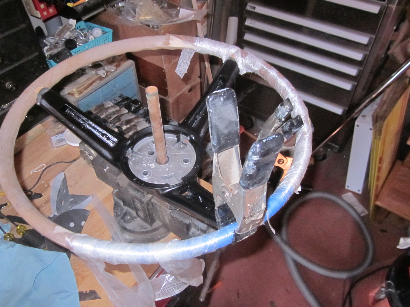

So, instead of starting with solid wood, I would like to use bent lamination, ie wrapping a continuous strip of thin veneer of the same etimoe I used on my dashboard around the steel frame to build the outer thickness. Maybe 5mm or so thick.
Once that is done, using the same technique, I will build inner layers. Then at the end I would sand it all down to the proper rim thickness and shape. If this works as planned (and I realize it's a big "if"), it should make a nice match between the steering wheel and the rest of the car woodwork.

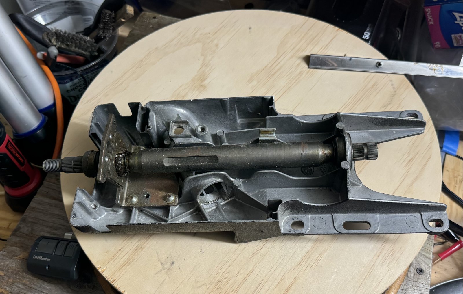

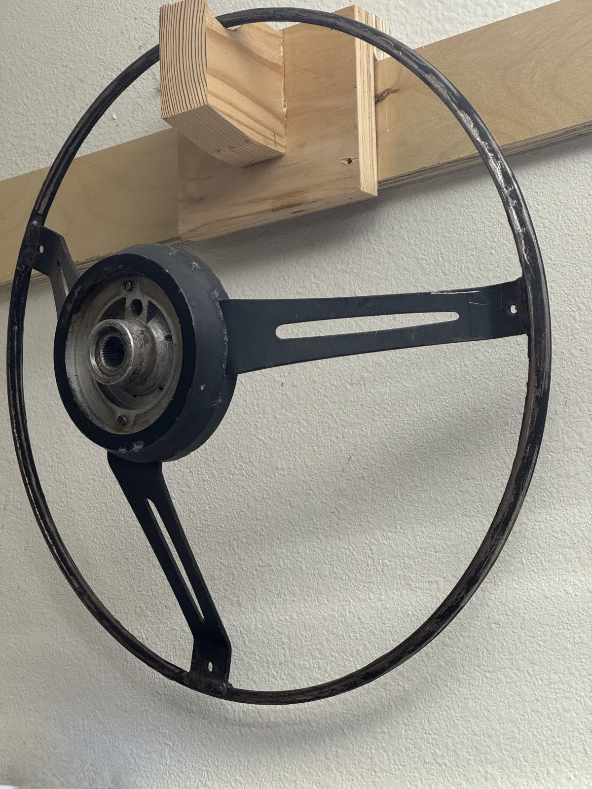

The tool setup I need: I have a steering wheel column to which I can secure the wheel (on the left in this photo)
I would like to setup a small electric motor that will spin this column (by grabbing the spindle on the right in this photo) which will then spin the wheel so it can be sanded. Much like you would do in wood turning. I imagine attaching the whole contraption to a base, securing the motor next to the column and using a belt of some sort to grab the spindle on the right. This motor would need to have variable speed for ideal control.
There are plenty of motors available on eBay but they are generally too powerful and fairly expensive ($150+). And then there is the issue of finding a belt that can fit on that motor on one side and that can grab the grooved spindle on the other.
I know several here have built similarly crazy contraptions ... Any thoughts on how to bring this to reality?

If you don't want to cut up your steering column I'll be happy to donate a splined stub of 2002 shaft you can attach.

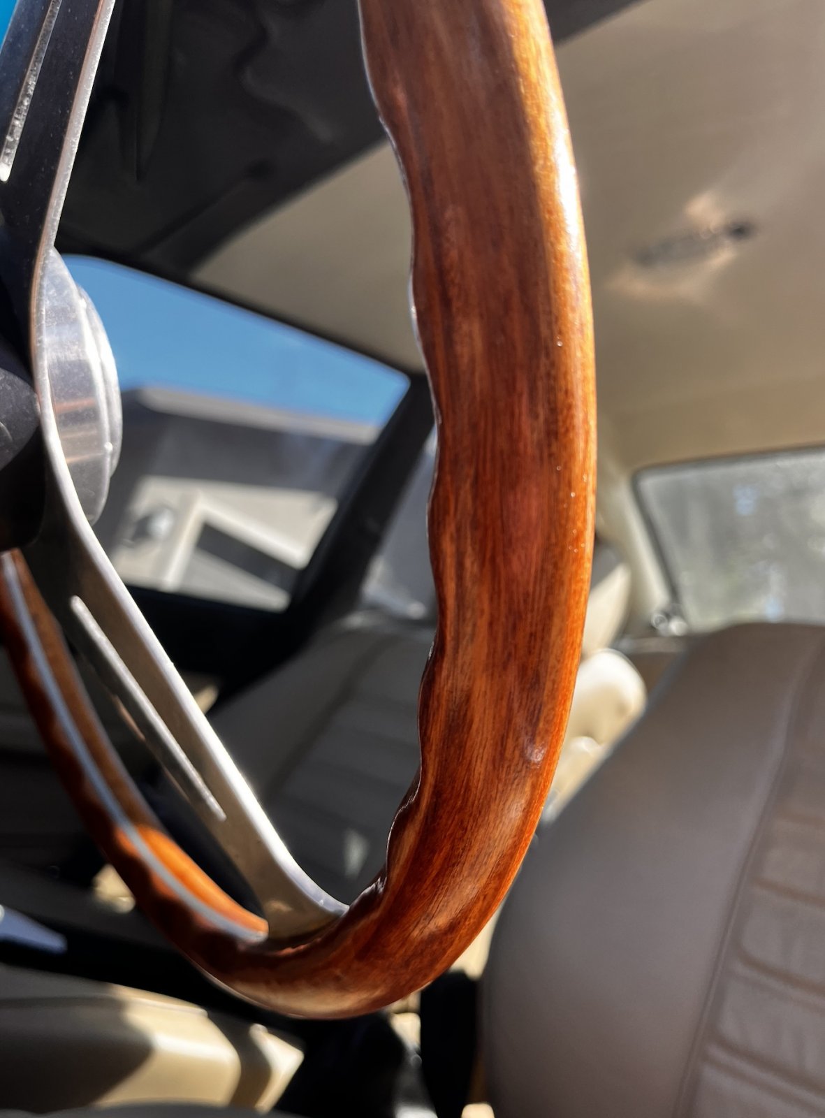

Never would have thought they spun-dipped the rims in finish still.

Take care that you will may experience a wobble if you choose a setup where the wheel spins. A wheel isn't weight balanced like a fan; the bottom half is heaver vs the top part.
As the steering column has a double bearing about a foot apart, mounting the wheel on it, and screwing the cooumn to something sturdy will likely be strong enough, but still you may, depending on the RPM of the wheel, get a wobble or vibration at higher speeds.

Good idea, but don't think those steering bearings are intended for continuous running at any rpm you might want for sanding. Turntable and router for heavy removal sounds like a plan. Now if you had an old motor driven wheel balancer... ;)

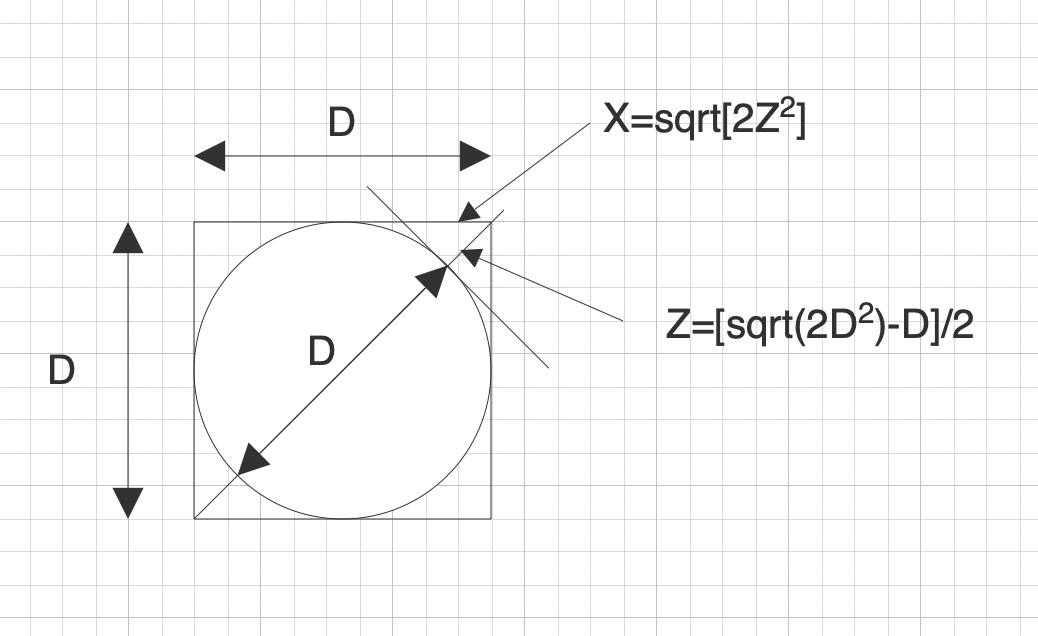

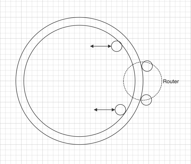

Using the DIY router table I sketched above it should be possible to mechanically round the hoop to about 90-95%. I'd start by rectifying the hoop to be sure it is round and uniform after the lamination. Do this by hand first, so the thing sits flat on the table, and turns smoothly in the rollers. Then fine tune it by shaving the high spots off with a flush-cut router bit. Get it to a square section about 1/16" larger than the finish diameter. Then cut the corners off using a 45 degree bit, again (I am sure you already know this) a bit at a time. Be sure not to cut too much off the corners.
For a rough diameter of D, you would cut into the edge at 45 degrees as follows.
The depth from the corner to the 45 degree flat is Z=1/2*(sqrt(2*D^2)-D), this translates to a lateral cut in from the edge (for example looking from the top of X=sqrt(2*X^2). If you run these relations using, say a 1 inch rough blank diameter, your get Z=.207,and X=.292.
Here is a diagram for you geometry nerds.
As you can see this gets you a LONG way toward a round section hoop. You can either use a file to cut the remaining points down, or use a 1" bullnose bit in the router. I did this on some long teak grab rails on my boat using just a table saw, and then hand finished them with a plane and sandpaper (long and straight is much easier than a hoop though. I do have an old Stanley 113 plane with an adjustable curved base you are welcome to try out, but sandpaper is probably safer...
Once you have the rounded hoop, then cut the hoop long ways using the table and a saw bit in the router, and then cut the above mentioned rabbets, and start assembly!

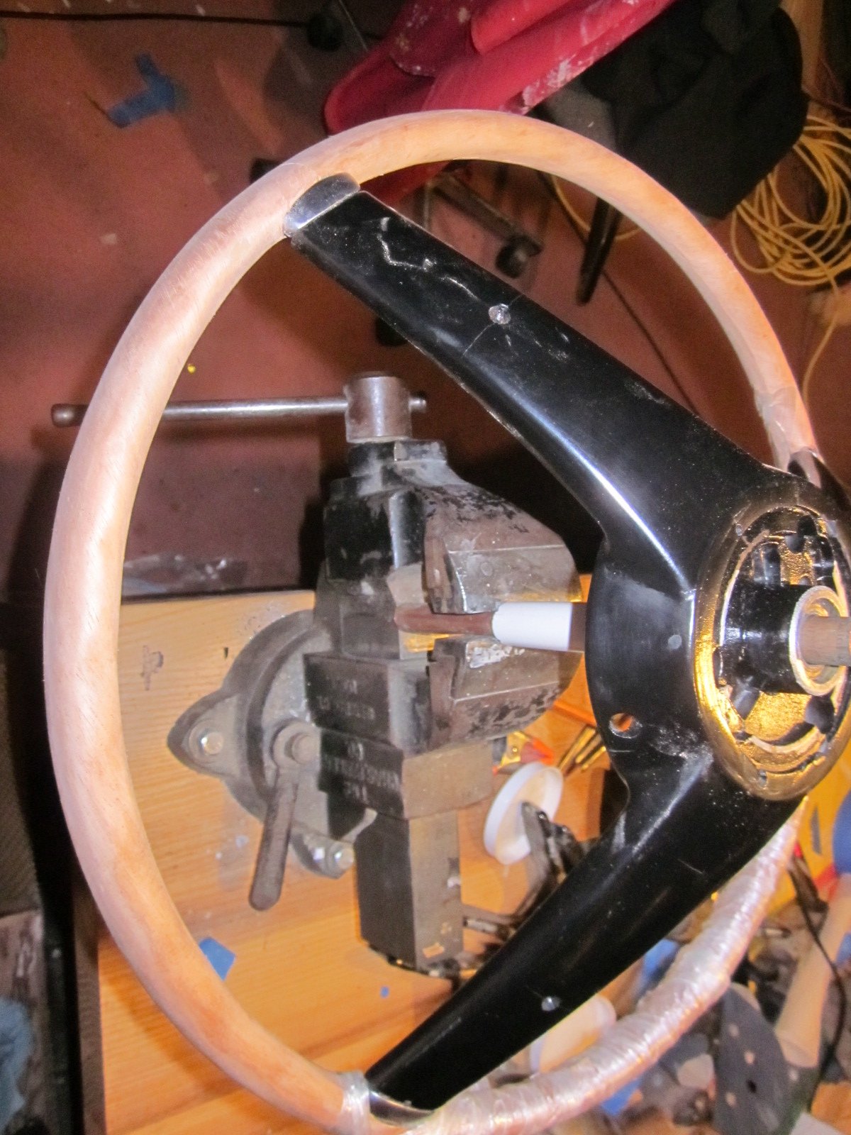

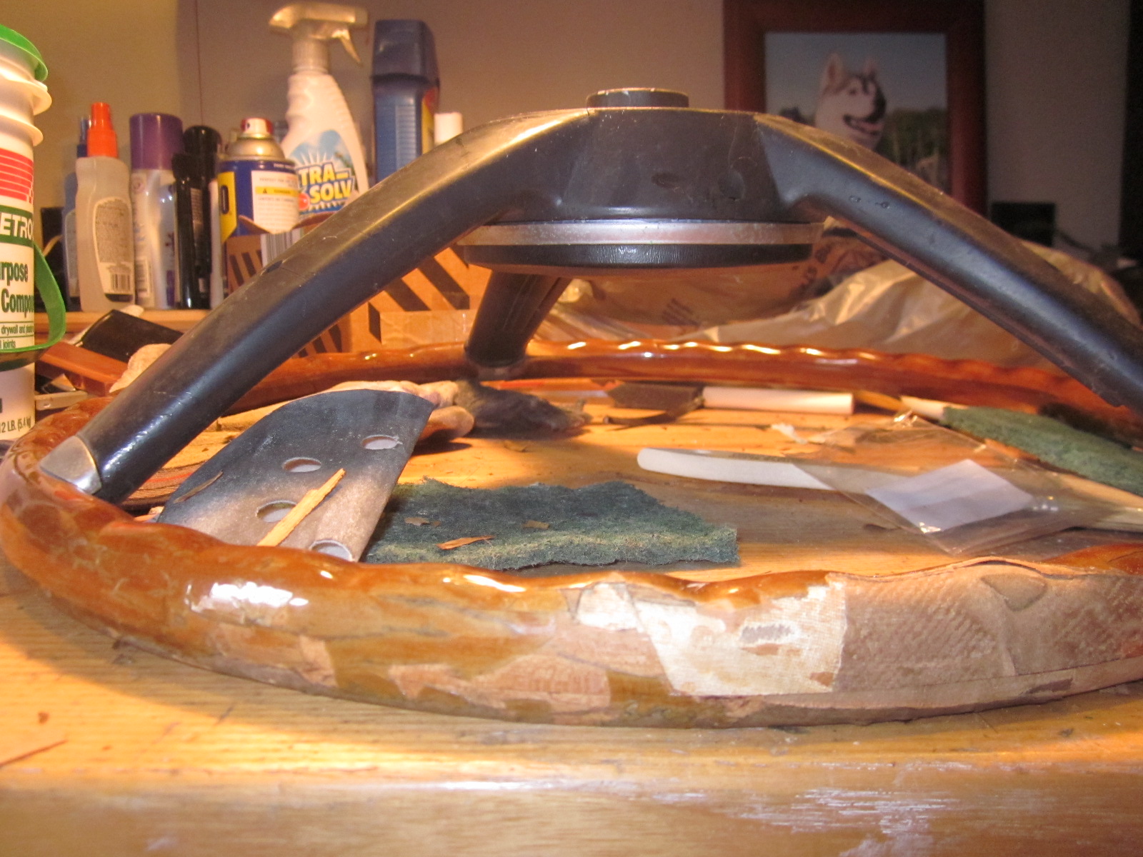

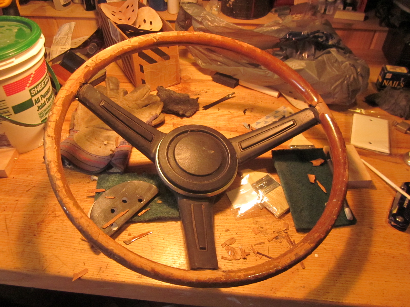

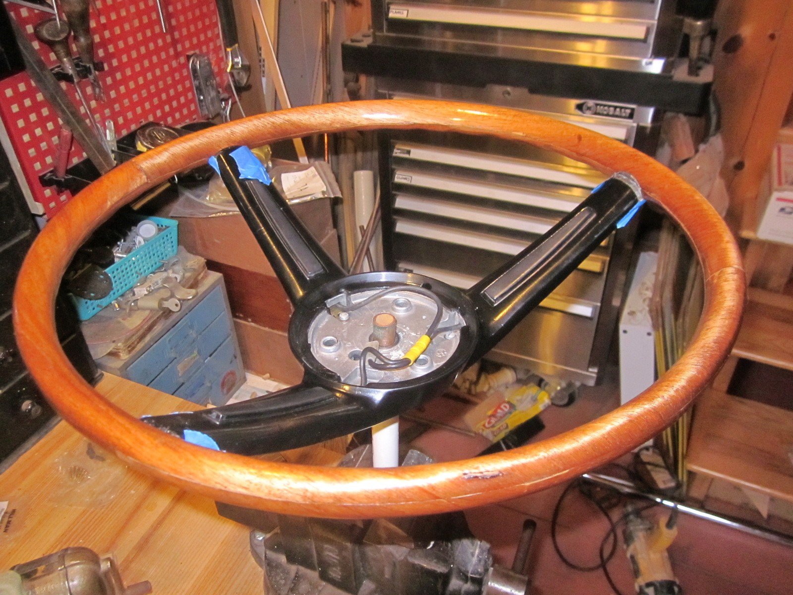

I re-veneered a junky 420mm CS wood coupe wheel & modified it for my 1973 2002Tii.
After I removed the original flaking by scraping & sanding.
I made a painters tape templates 2 for the front 3 for the back. Peeled the templates off & laid as flat as possible on the Rockler Adhesive back Mahogany Veneer. Fist I moistened the veneer then I used fiberglass reinforced tape to wrap it around the wheel. Where the front pieces wrapped over the 3 back pieces I trimmed them with a a new razor knife blade. Only use only enough pressure to cut the excess veneer. I was able to maintain the rear finger detents of the original.
I sanded with 220 only enough to smooth out the raised grain, the veneer is at most 1/16th or 2mm thick.
I did 5 thin coats of Minwax Gloss Oil Polyurethane & 3 coats of Satin, lightly sanding between each coat, then using 0000 Bronze Wool & Bowling Alley Paste Wax as the final step.
The stock 2002 'Bus' steering wheel is 400mm & fit inside the 420mm stock 'Bus' Coupe steering wheel.

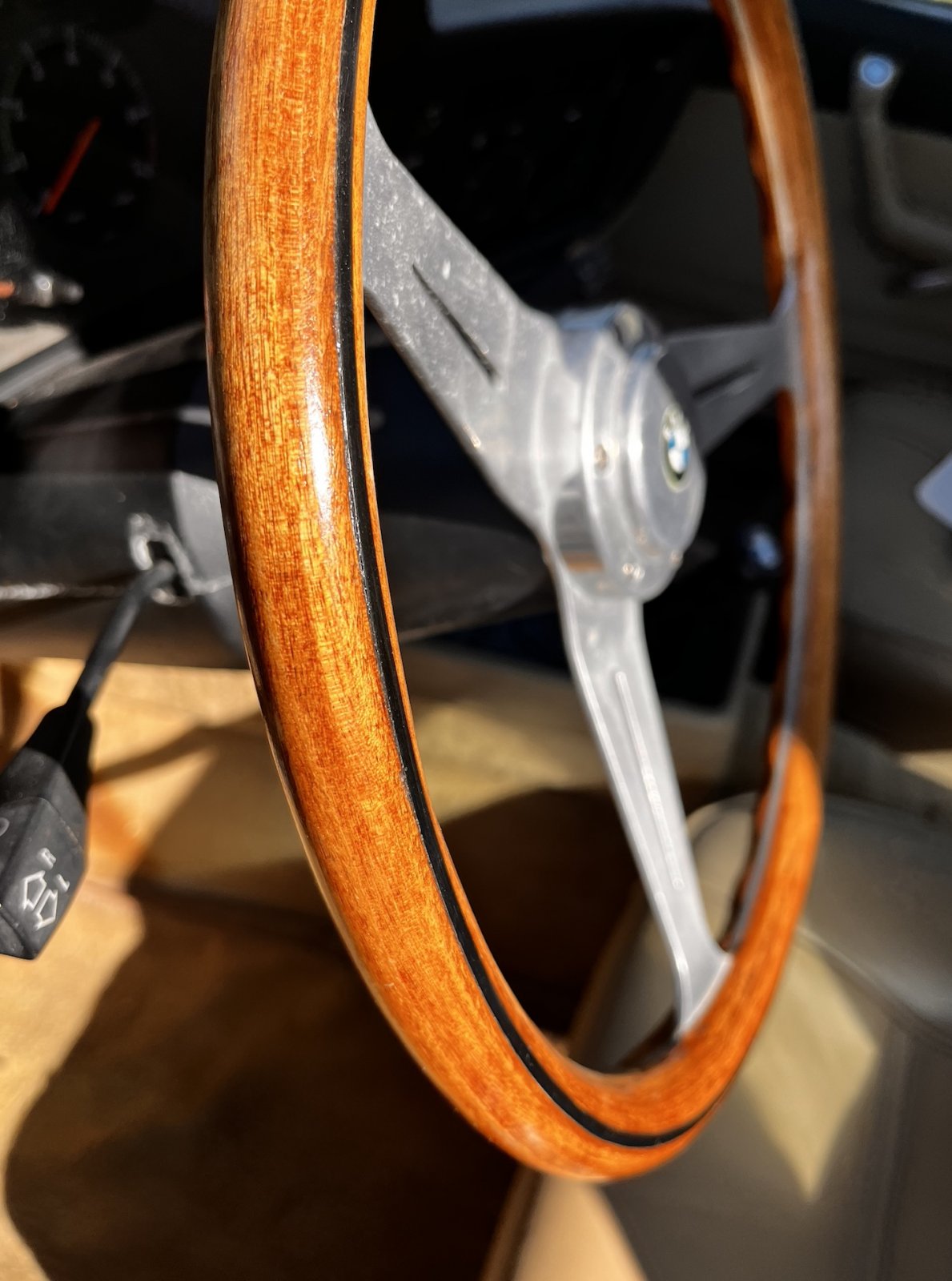

I went out and took some pics of my Nardi wheel . This is on my 635, but it is the same as woudl go on an E9..
It appars that this wheel was made by cutting a 1/4 secton out of the wood hoop, and then inserting the rim and spokes in that cutout, and then replacing the cut out portion. They used a black inlay to mask the cut line in the front of the wheel. There are no joining lines anywhere else onthe wheel. On this one the rim shows on the inside, so the piece that replaced the removed section (probably the same piece that was cut out) lies flat against the rim. Seems like the way to do this would be as described above, but cut the section out using a saw kerf that is the thickness of the rim and spokes, so when it goes back together the crosssection is unchanged. That way all the shaping is not for naught. Again, for you, the rim probaby doesn't show, so you would use the smallest kerf you could find, and cut reliefs for the spokes. I'd bet that they used a router to cut the front part creating a groove that would later be filled with the black inlay, and then used a saw for the horizontal cut to release the quarter section. Were I doing this, I'd then put the rim in, and attach the black inlay with a thickness that fills the gap. And then attach the removed 1/4 section piece. Then simply use the router to trim off the slightly proud inlay, and sand.

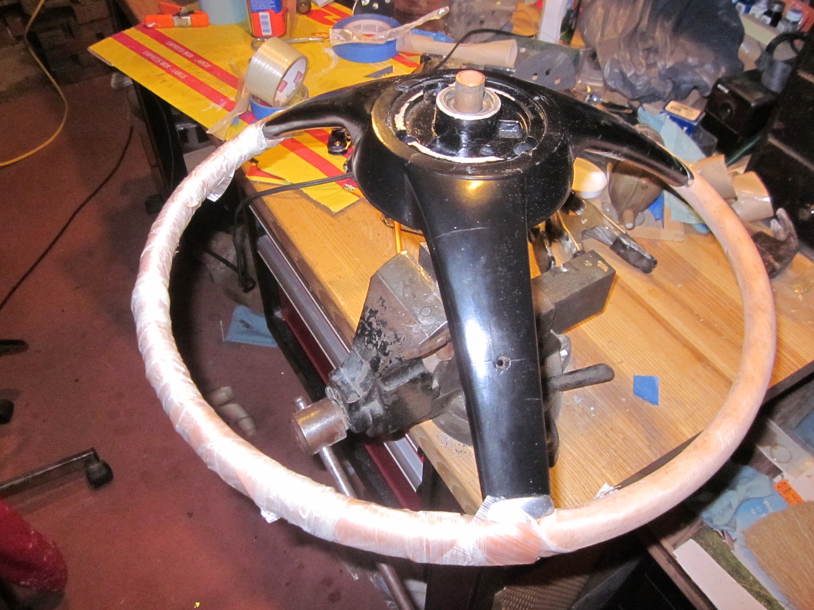

That is why I want to explore the idea of wrapping a (very long) strip of veneer of the same wood I used on the dash in the same way a roll of duct tape is. If the glue (I'm using a pre-catalyzed urea powdered glue) is thin enough, it might blend in enough to be near invisible. I suspect that Nardi might be using that same technique to make joining invisible.
From then on, there are several paths available for routing the channel inside which the steel rim will nest. Building a jig with roller bearings for the routing table as you mentioned earlier will definitely be part of the deal. Both for outer contour (although we might not want a perfectly round type of arc) but also for the inner channel.
