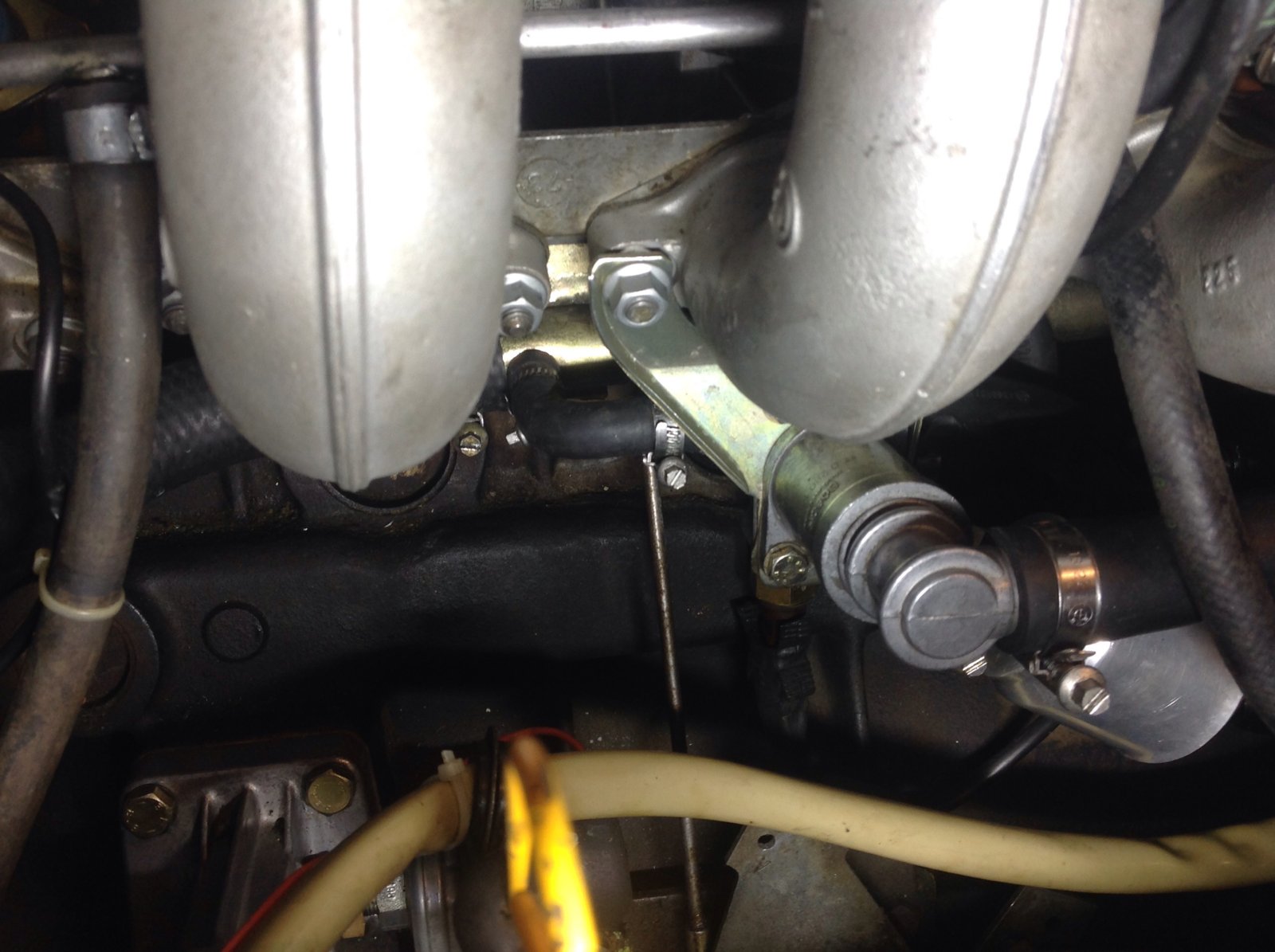

Cant seem to find the part number of tbe two thick washers behind the aux air valve lower mounting, on the injector casting.
Any one help please?
Could it be
24111690120?
Could it be
24111690120?
I think you meant the Air Accumulator/Plenum Chamber ? (not AAV ) ...is this it behind the acorn nut in the pic?...if so, size is A8,4...Walloths has too if you search the part number you quoted .
Thanks for the input. I do actually mean the AAV!
Here is a pic of the area. The thick washer is behind the mounting bracket for the AAV.
View attachment 44947 Thanks for the input. I do actually mean the AAV!
Is that original hardware for your intake runners? It sure looks new. I could have sworn that the nuts on my intake runners all had washers, and were standard nuts but flared like yours.
image.jpg Yes they are the BMW replacement nuts supplied. I still have the old nuts and wave washer in the "to be cleaned" pile.
(Its a very big pile!)
PS
I am pleased to report that the part number is indeed 24111690120. Expensive at over £2.00 each though!
The orange book indicates three required, two I know the location for but the third?
