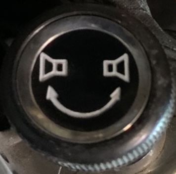

Does anyone know what this knob does?
Wobdog
a.k.a Mike
908
975
Los Altos Ca

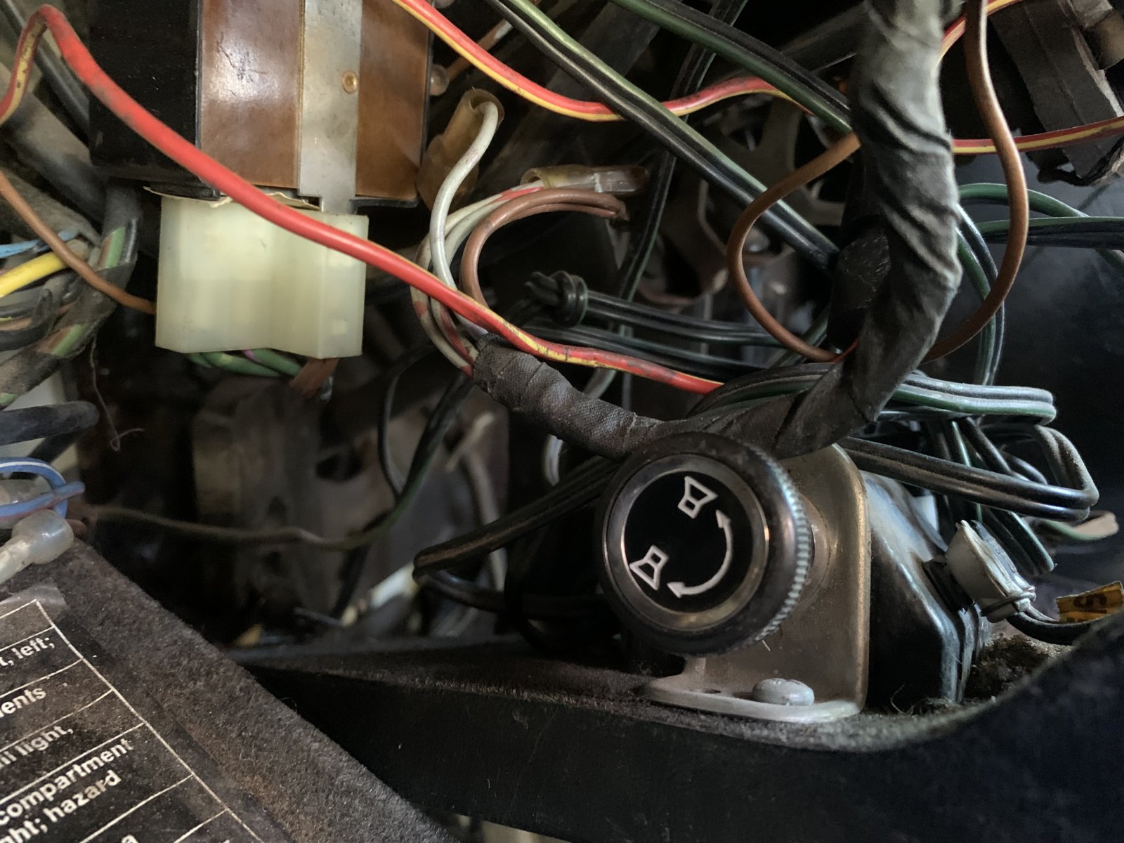

Does anyone know what this knob does in the fuse box/Engine hood release compartment does? I thought it was do dim the instrument panel with this lights on but it does not seem to do anyting when I turn it.
No doubt it is a Becker stereo fader control. Wired to front and rear speakers and to the Becker amplifier that is typically mounted to the inside of the firewall above the glove box. Most Becker (Grand Prix models) stereo units had separate amps. State of art stuff for the early 70's. Is the stock Becker still installed?
Now I see the old DIN plugs. Strange location as it was certainly not accessible while driving back then, but in the future...................scares me.
Winner Winner Chicken Dinner. Although I do like googly-eyed smile knob (I need that one) it in fact is the radio fader from front to back. THANK YOU VERY MUCH...would not have figured that one out on my own.
