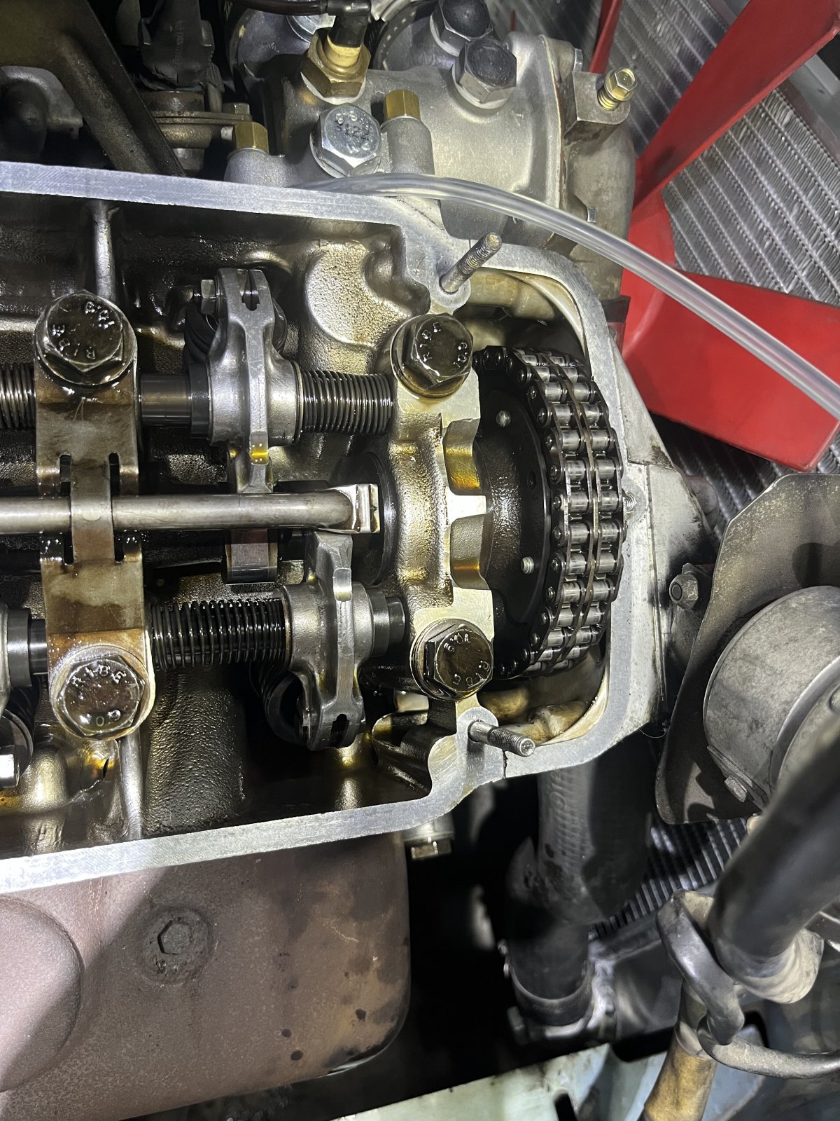

So I replaced the vibration damper and still have the knocking sound. The sound is coming from the top of the engine and near the middle to front of the engine so in the area of cylinder 1 & 2. Could it be injector because the timing of the knock aligns with the injector when I put the stethoscope to it?
I checked the sound at the bottom half of the stethoscope and the knocking was not that pronounced as it was at the top of the engine.

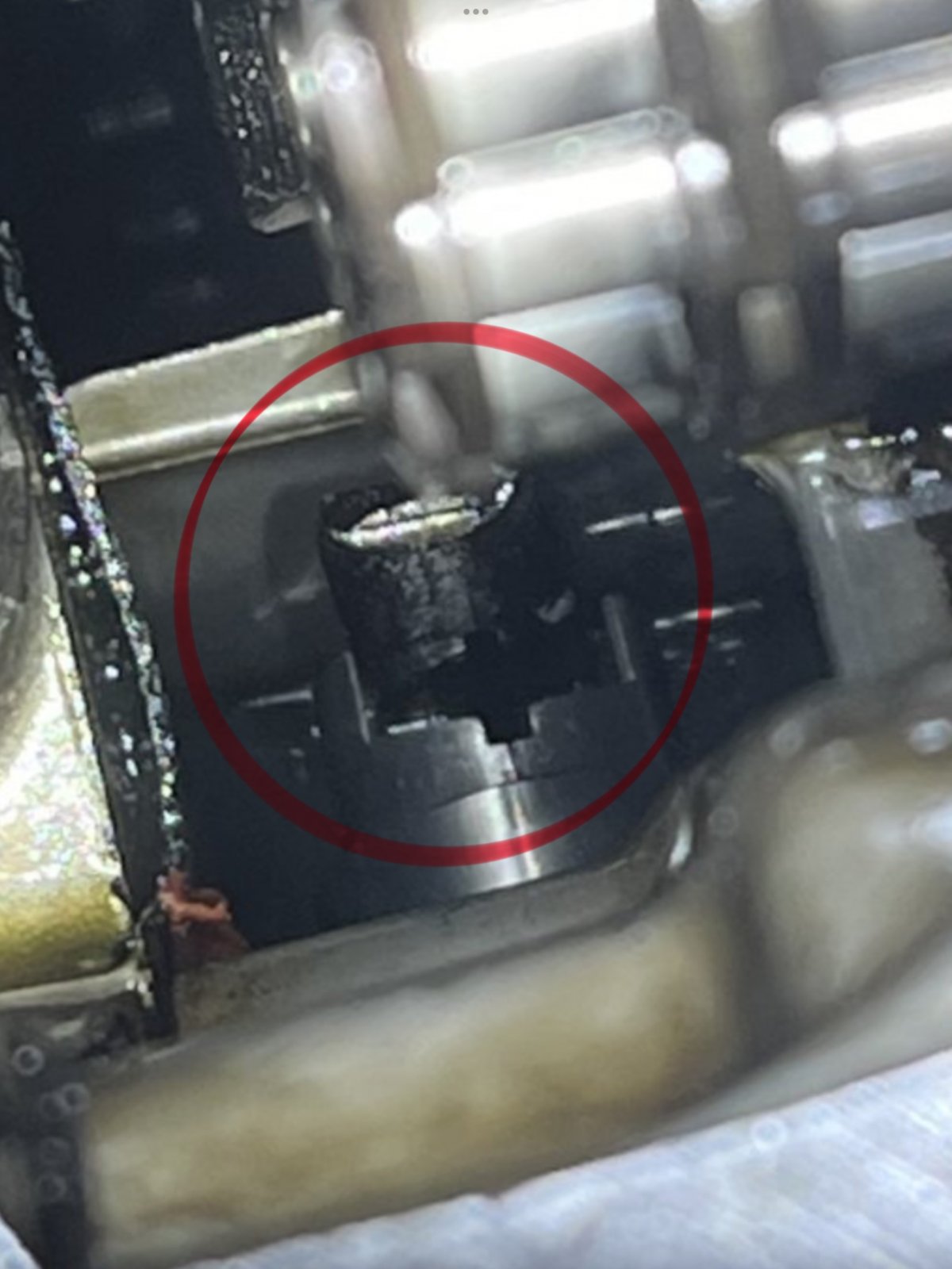

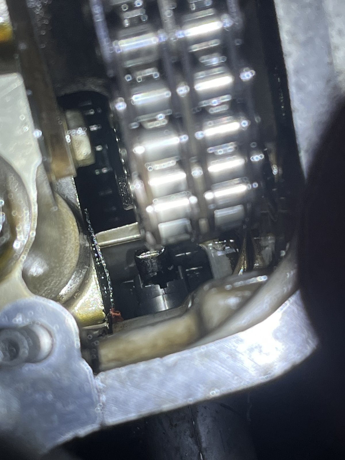

I have some thoughts for you…
And questions….
Did you replace the timing chain tensioner rail recently? How about the timing chain piston? Did you re-use the upper timing cover during an engine rebuild?
Do you have notes of what brands you bought?
Can you remove the valve cover and take a well lit high resolution picture of the timing chain tensioner rail with the timing piston exactly where they come together?

Thanks Don
Will have to take off the cover again.
I replaced the spring and end cylinder (where the end has a wide notch where the guide slots into). I bought those from bmw.
I haven’t done an engine rebuild or timing chain replacement.
