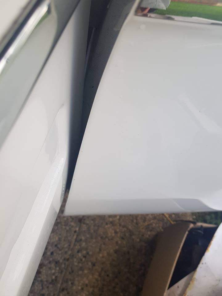

Guys my driver door opens way too much to the part they touch front wing. Missing some stopper or what?

Will check it out. I have to replace it on passenger side since there door wont stay open so I just might buy a pair.
Buying a pair has been a bit of an ordeal last time I checked. There is a mercedes hack available. Careful with your doors, a car on BAT recently had fender dings on each side from the doors hitting them.
I had door issues which involved the hinges wearing out. I asked on the forum and got quite a few. I might have some which are serviceable. A tiny movement at the hinge turns into quite a sizeable movement at the door.
