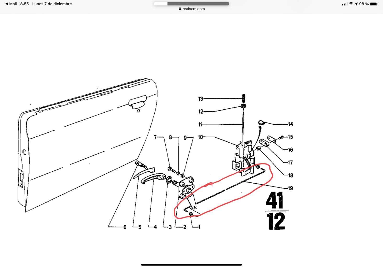

someone can help with the dimensions and thickness of the connection rod to open the door
part number 51211810643

Interesting, mine (1972) is different than shown, it is bent around the connection points rather than straight and pushed into retainers. It is possible that this was done when the door was opened for metal repair in the past.
My measurements are about 57 cm point to point, but I have a loop, at least on the door post connector. the thickness is just under 4mm.
Guys. probably pic is not correct. Mines was lost by the body shop and paint guy, therefore I don’t know how it is.
my car is 3.0 CSI August 73

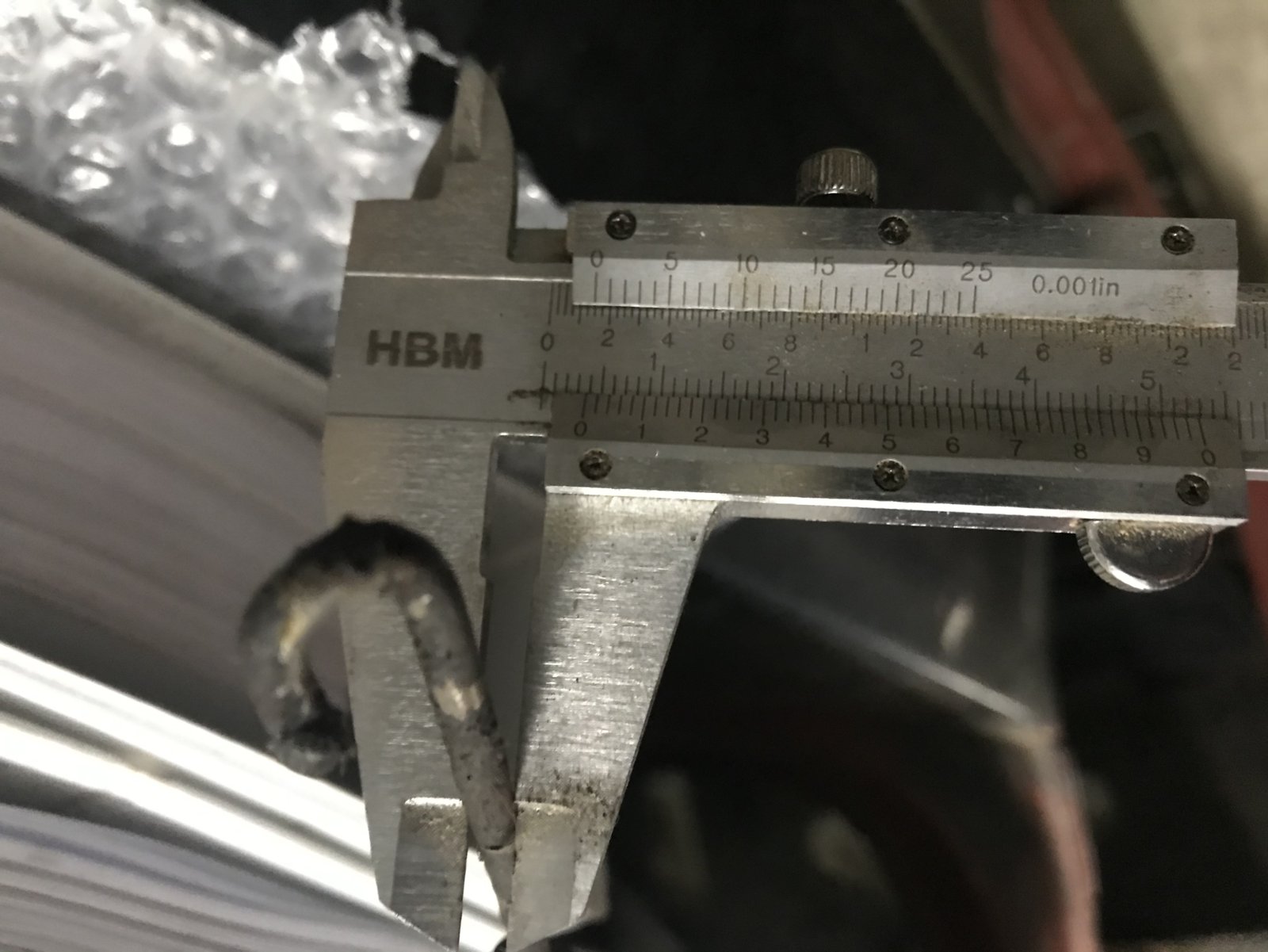

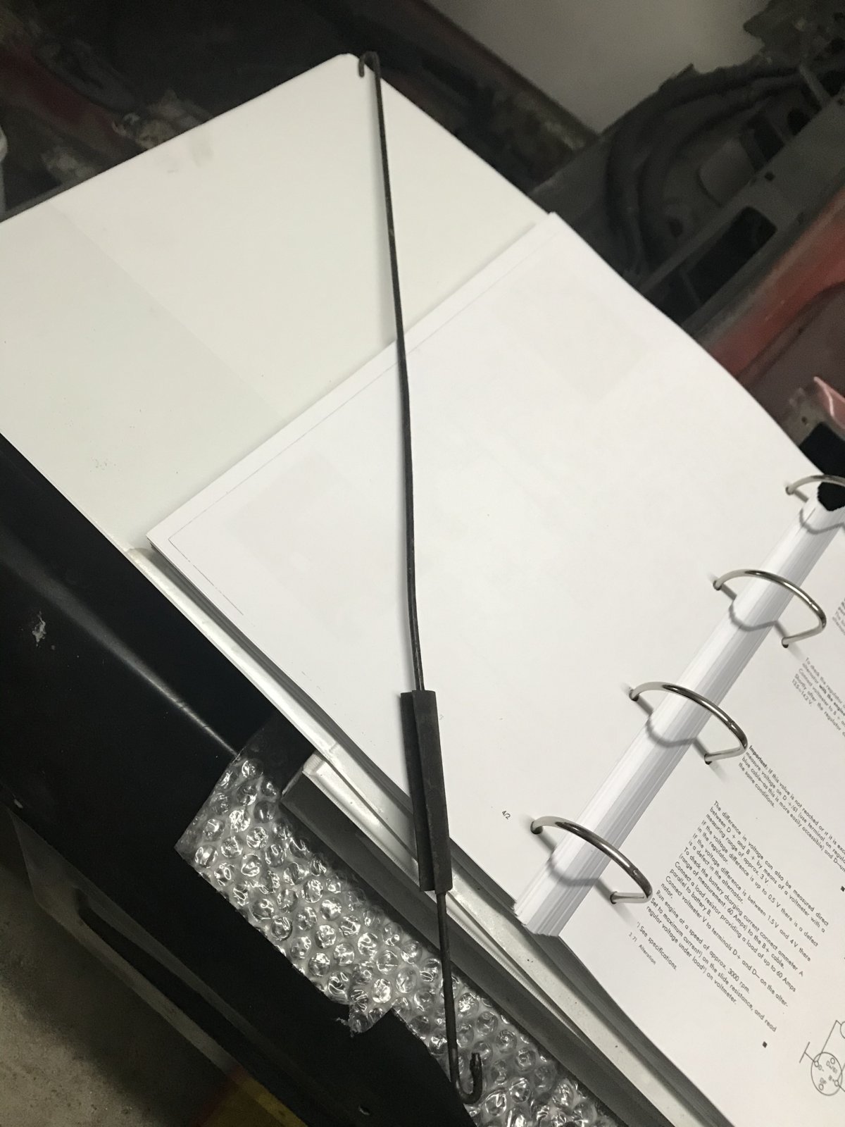

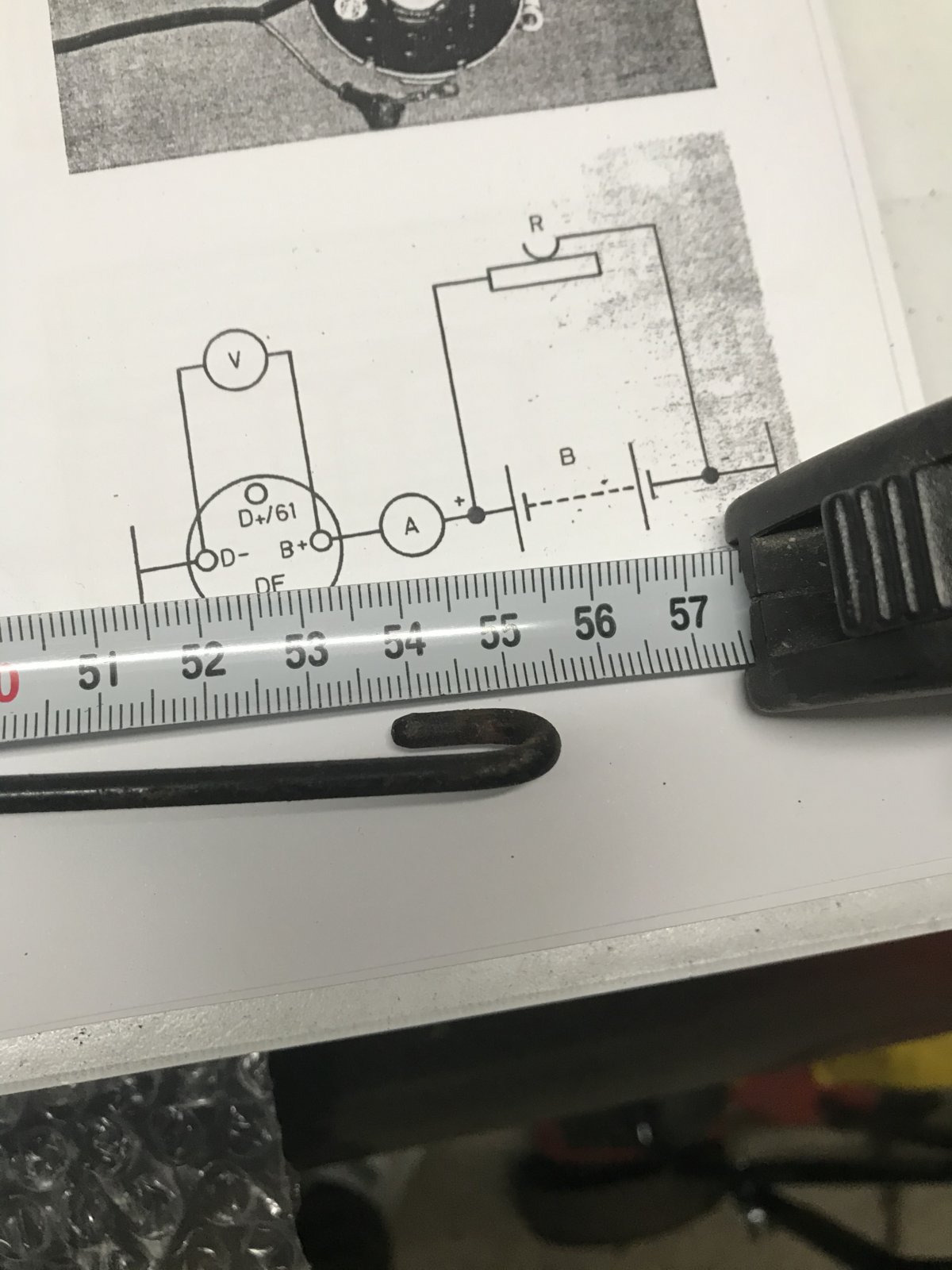

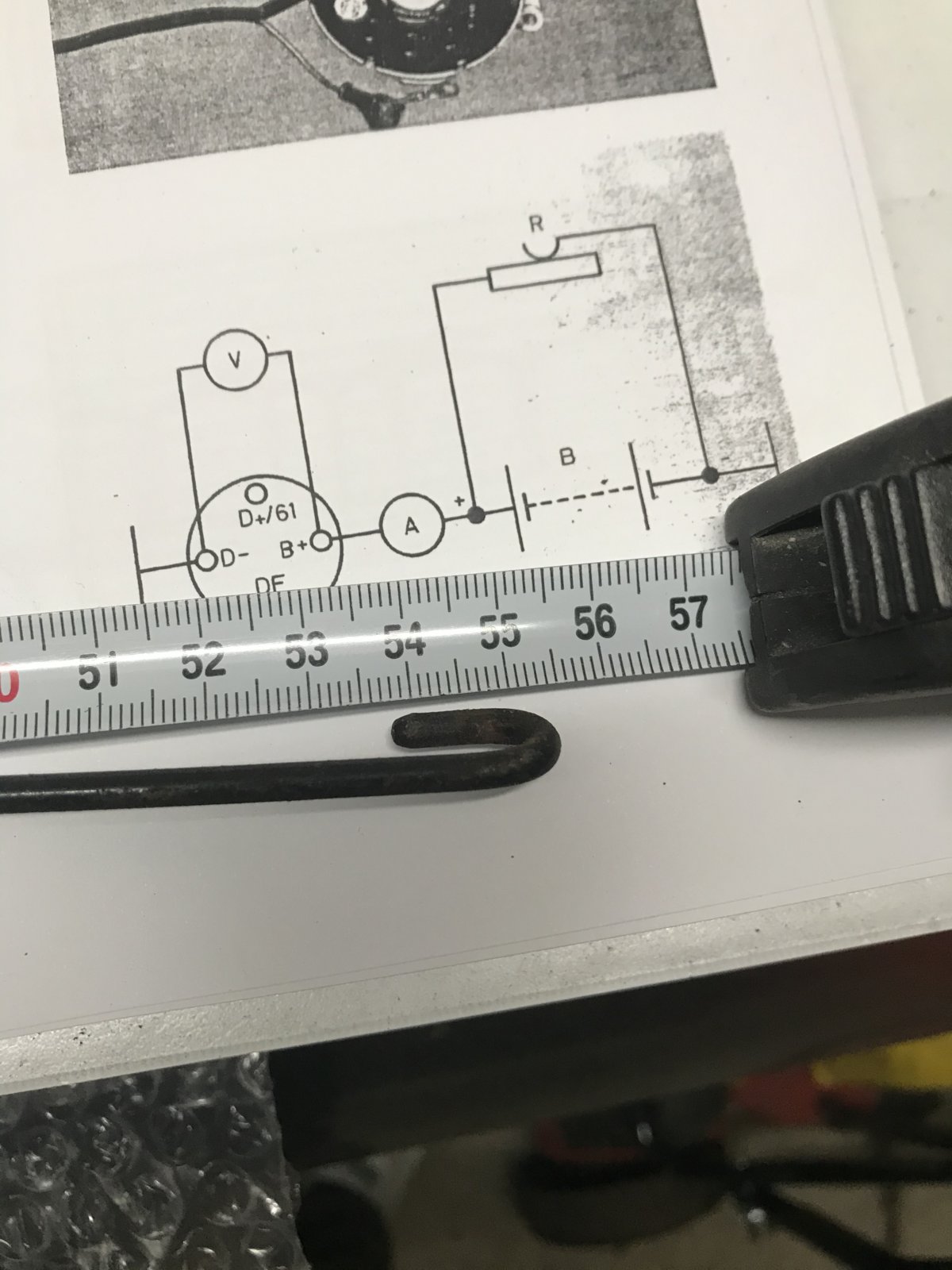

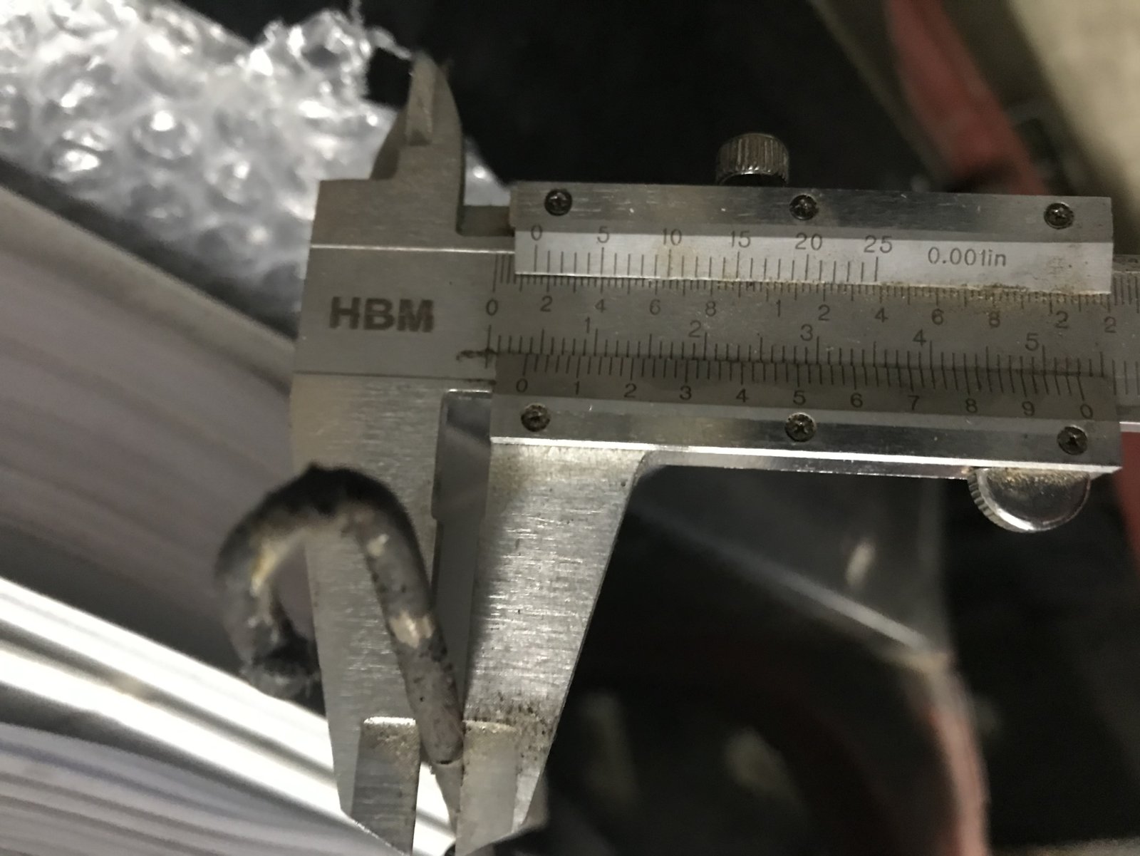

Not for sale, but see dimensions in the pictures. It is from a 2800CS from 1970. 3.7mm thick, 55.5mm from end to end, measured with the bow included.
