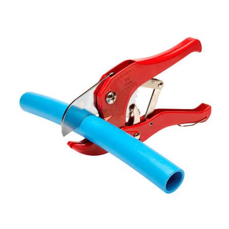

How about pipe shears? They typically have a large jaws that hold well.

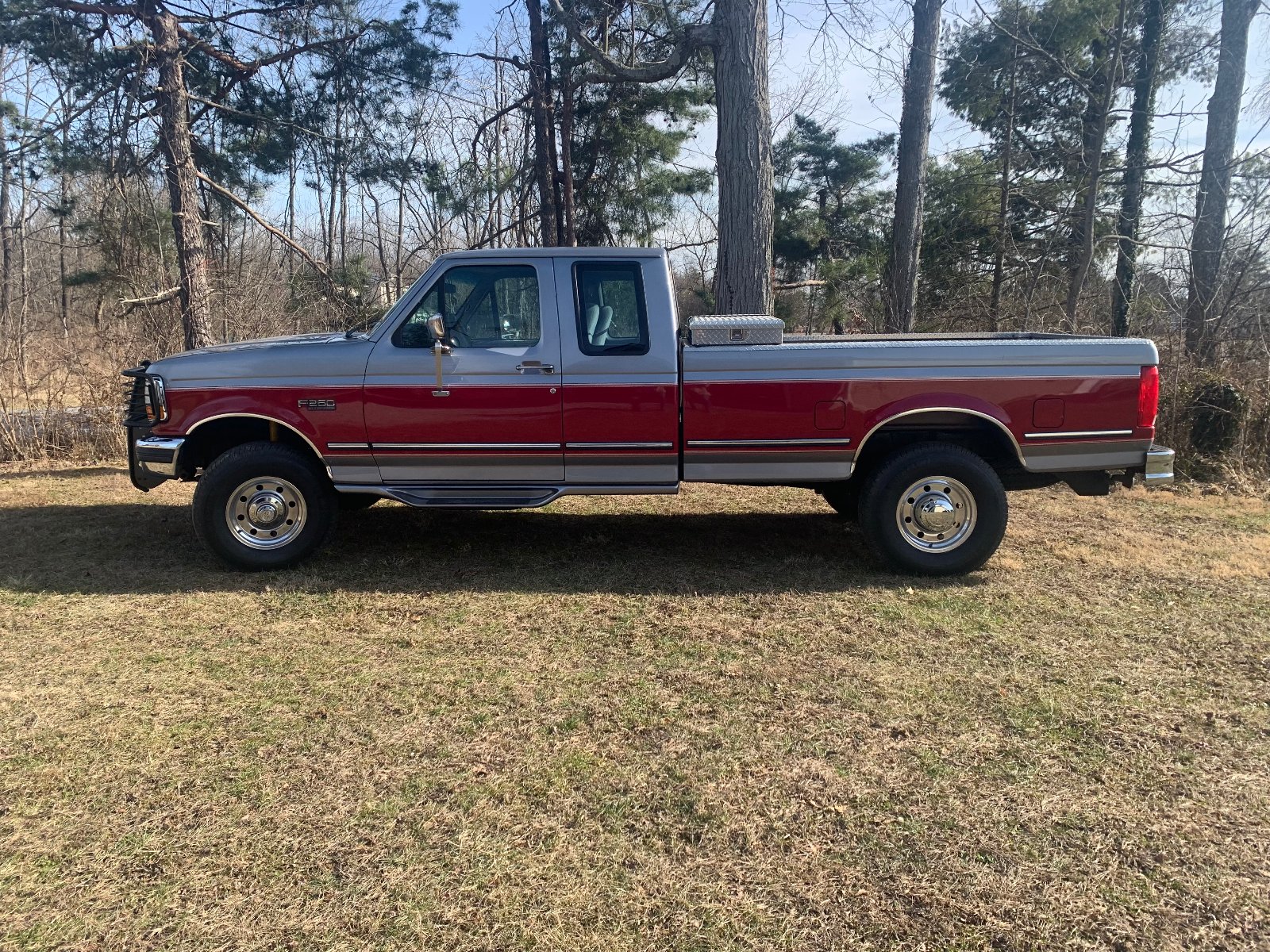

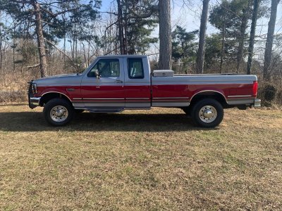

Not on my BMW but what i used on trimming rubber is to heat a razor knife with mapp gas and slice. The balde loses its temper after 2-3 reheats but it can give you a very precise cut. I did this on my body colored running boards on my F250. sorry to not have photos of the process

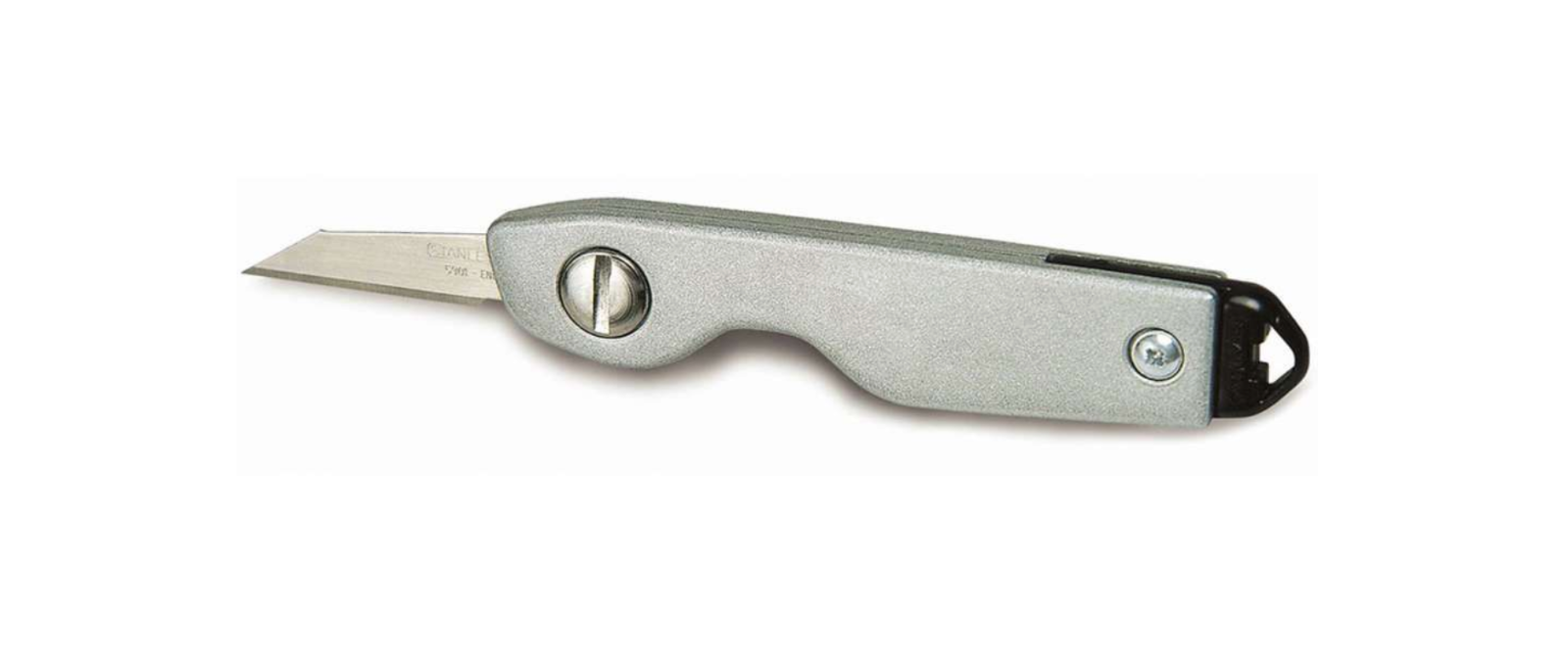

I used this little guy. Replaceable blades are a little pricey and they are dull after the third cut but work excellent
