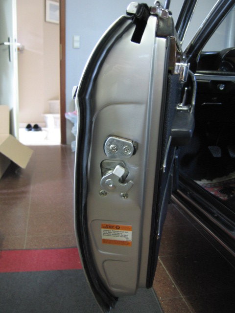

Just glued mine in to position last week and used "patex rubber glue"
First cleaned the surface with alcohol, applied the glue to both the rubber and the door, left everything to dry for 10 minutes and then put it on. Worked just perfect apart from the curve on the bottom. Think on my car the uneven surface as a result of that plastic like coating they used, before re-spraying it,
was to blame. However 2 week further everything hold on just fine.

Thanks and great photos
I took DeQ's advice and lined them up first. The left and right sides are different, makes sense.
....180 is the left hand side and ...181 is the right hand side according to the Wand N web page.
Near the top the seal clearly has an angle in it about 150mm down, that aligns with the trim line in the door. Whilst the other end curves around to go under the car. However it seems that the curve is wrong way. Am I missing something major or just being dim?
This is the part that you mentioned did not fit so well on your car. I am wondering if there is a batch of BMW seals that are the incorrect shape. I doubt this, it am currently stuck so will sleep on it and ask the forum.
I had a look and it does not make sense to fit this seal to the other door but I am sure that there is a simple answer.
Did you glue the seal to the end of the door plate or the back of the door skin where it folds around on itself, or both? I guess both sides.

Philippe, you need the little rubber cover that fits on the door latch. it will make the door latch work better. only 1.55 euro from w+n
https://www.wallothnesch.com/en/rubber-cover-41-12-14.html
Hi Scott,
Not sure I can follow you can clearly see on my picture that it is in position.
@Charles, I had exactly the same thoughts when first holding these rubbers against the doors. That probably explains why I couldn't get them in position perfectly. In hindsight I think I should have saved the €230 by not installing them. The turns on the bottom are already both coming loose. Looks terrible. I had two nice doors and now I'm under the impression that these stupid rubbers ruined them.

Philippe, look at the door latch on this picture. there is the 'hook' on the right side of the latch. the little rubber cover fits on that. it helps hold the door closed without rattling ...
img_6270-jpg.44659
rsporsche
10,702
3,726
Atlanta, GA
ooops, you are right, i just saw it. hiding in plain sight ... i was remembering it going on the other leg of the latch. yes, Chris, it's been too long.

Did you glue them onto one side or two sides of the door frame. Which side if you only glued one side?

as to the various questions, you glue only one side of the rubber profile, and yes it makes the cabin quieter, and avoids dust amd water , it protects the lock mechanism
it makes sense to install it together with the other rubber that seals the contour of the aluminium plate that is also usually missing
poor installation can lead to think this rubber is useless, unfortunately there is not a lot of pictures of this humble, expensive, yet important part
again you can use my threads with chrome and photobucked fix to help
