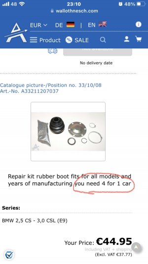

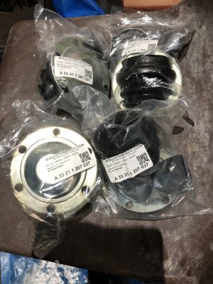

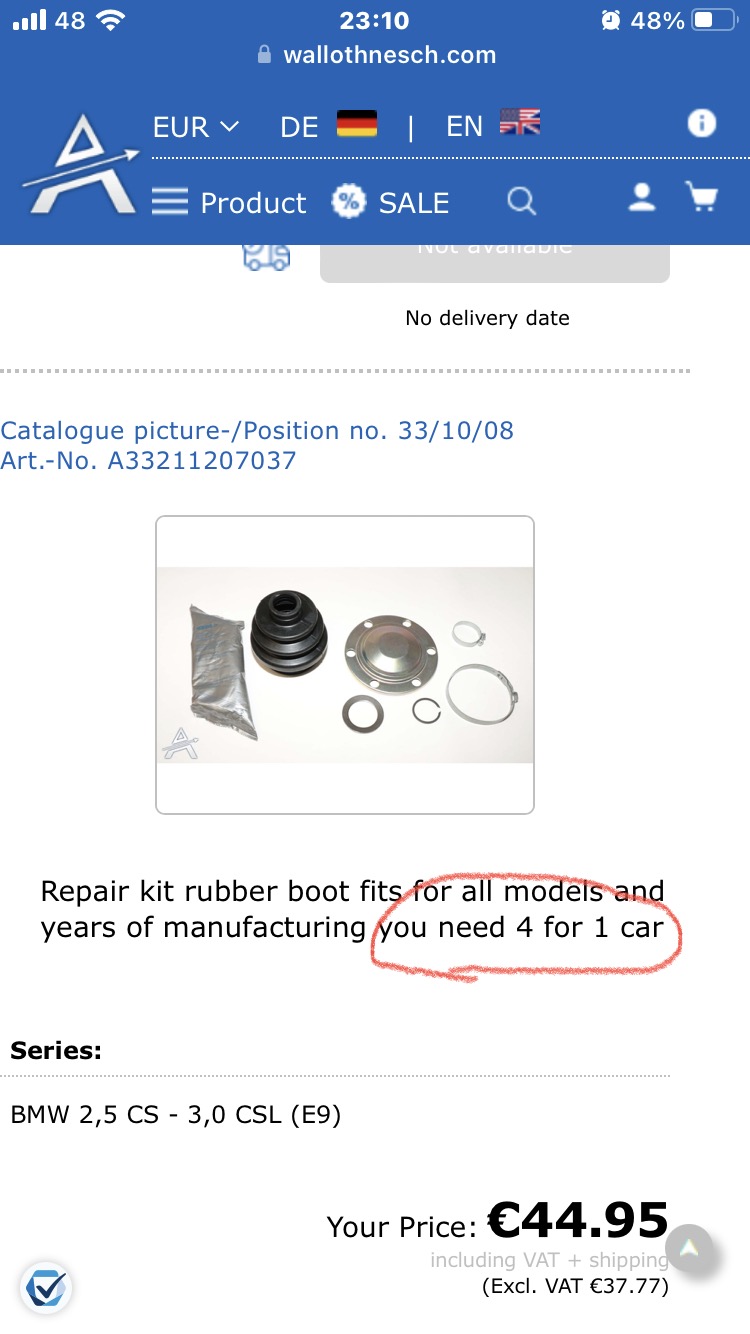

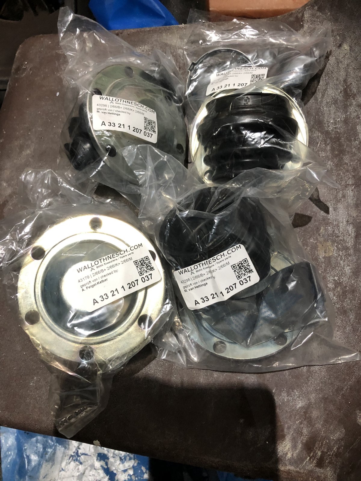

Hi guys , I bought 4 of these but now that I have them I am wondering if 4 of the same part is not correct.
Surely the 2 inner ones need a hole for the shaft ( maybe )
Am I missing something here ?
