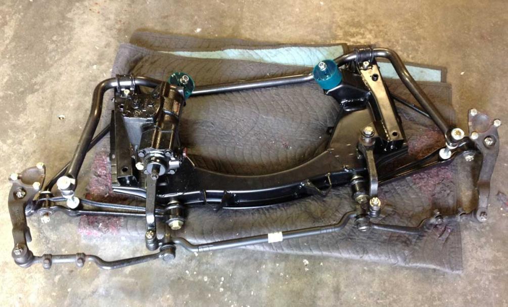

Pictured are what appear to be urethane motor mounts. Were they used to limit engine movement? (Somewhere in the thread there was a mention of the fan's love for a radiator.) Or were there other considerations? Source?

frontsusptogether-jpg.11642
Unless you are planning to race your car, I wouldn't go with mounts that are that hard. The bodies in our cars are quite flexible; these will only transfer the flex elsewhere.
lloyd - I have these on both cars and have been happy with them. I don't sense any excess engine vibrations. I am not fond of the sagging stock rubber mounts. Here is the blurb from the Ireland Engineering site:
Performance part. We were the first to make urethane motor mounts for the E30 twenty years ago. These heavy duty urethane motor mounts are stronger and absorb vibration better than the factory mounts. They are not a bolt-through design (effectively a skinny solid mount), but rather the internal plates extend into the urethane offering strength while maintaining some of its vibration-dampening characteristics. They're also more resistant to oil and ozone. The urethane durometer is 80a. Made right here in Southern California.

What about the transmission mount? BTW, I have seen mixing and matching of different composition mounts. Whether this fosters premature wear for a weaker-softer-more flexible mount or mounts is unknown, but one supposes it might add a a mid-level degree of stiffness and flexion.
I am not touting rubber over urethane or vice versa. My experience with both compositions has been mixed, a la Goldilocks. That includes flex joints (giubo), engine and transmission mounts, and suspension-related bushes. Not sure that price always reflects reliability since some of the off-brands seem to work as well as the OEM offerings, and not all urethane is the same in terms of composition and durability. There may be some peace of mind with the OEM, but maybe not, pursuant to your "sagging" experience. Urethane compounds and construction quality are hard to fully evaluate absent field testing, hence the question.
