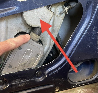

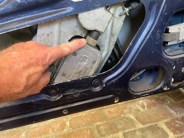

I have the panels off my 71 e9. I've WD-40 all the tracks for two days and still can't get the window to go up. But when I turn on the ignition and press the window switch up or down this toothed cap I'm pointing to moves one way or the other. So it would seem I'm getting power to the window and it's just stuck. I'm new to this but do you think mine is just stuck as well? If so could you give me a detailed guide to how to get it unstuck? I'm a rookie at this so any detailed help I can get is appreciated. Thanks, E

Not an electrical issue. Your window transmission gear is stripped.
The part is NLA but a kind member @TravL350 has printed these. I believe he may have sold his e9 recently, but you may be able to reach him. You can also check with @Tony.dreamer. Tony received one and successfully installed. He is definitely still in the thick of e9 life.
When I say it moves, it only moves 1/8 inch or so either way. It does not whirl around. It stops after a 1/8 move one way or the other.
Pull the motor and see how it spins while still plugged in. Next you can also remove the lid. Inside you will find some 50yo concrete-like grease. Clean and repack and see see how it spins. Try again installed, and pull the transmission if you are still having issues.
Have you tried helping the gear with a push from your fingers while operating the switch? The window sometimes goes too high or too low and the motor can’t turn. If moves, then adjust or replace the window stops.
I had been spraying all the tracks for the window with WD-40 (they didn't look too dirty) to clean for days. Today I took your advice and tried the window while pushing the gear with my finger. Damn if it didn't work! Thanks for the tip!
