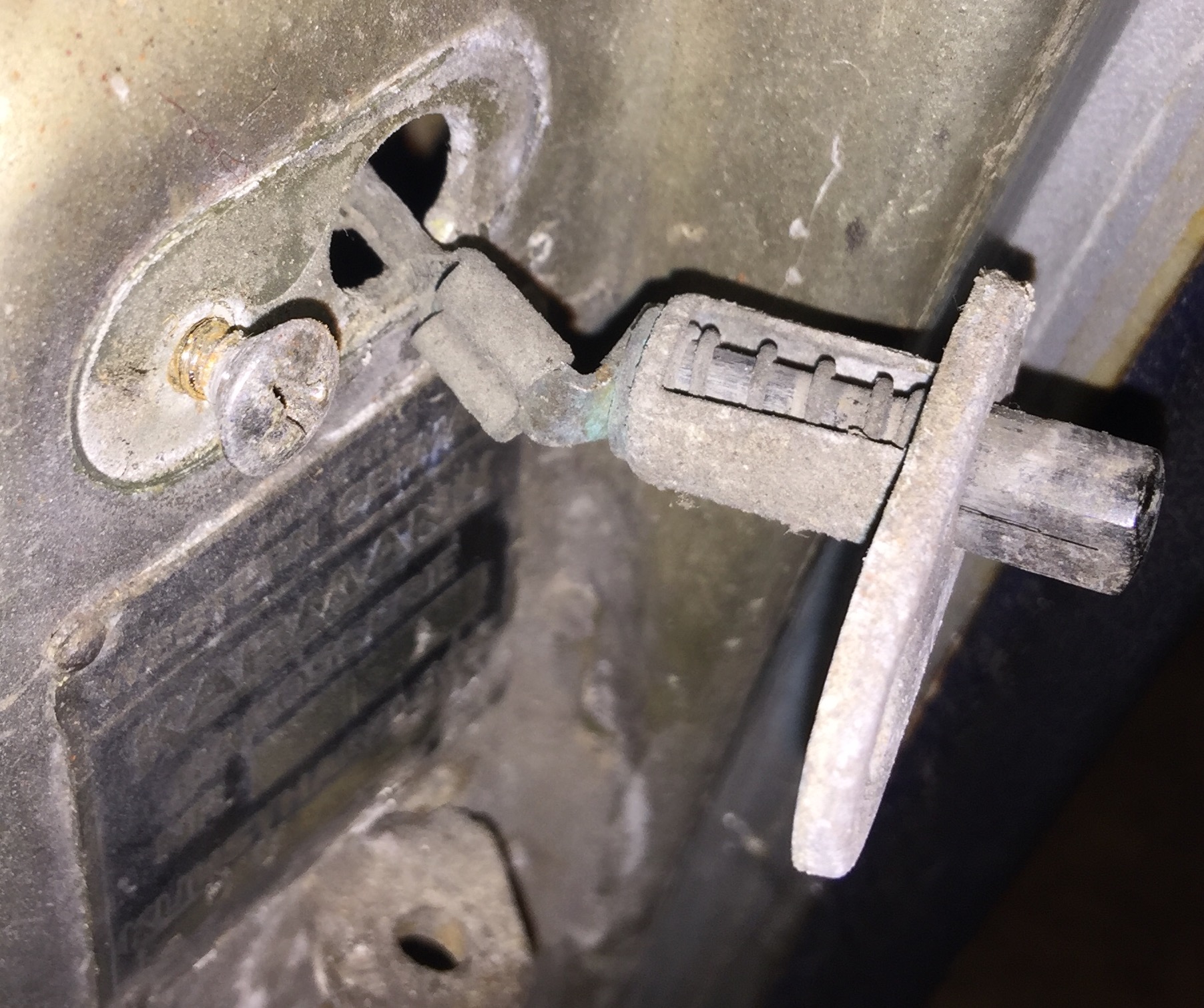

No, I need the key. This is my plunger switch, is this what it should look like if I have the relay, and where should the relay be? I will check.

guys, i have a '71 2800cs (us spec car), and it has the same switch Steve has ... and has 2 separate wires. i do not have the window circuit breakers ... well i actually have them in the panel since i have a '74 telescoping steering column and the '74 trim panel ... they just aren't wired up.
one wire goes to the interior light and the other goes to the passenger side.
hence two wires which are always hot and the switch grounds it
