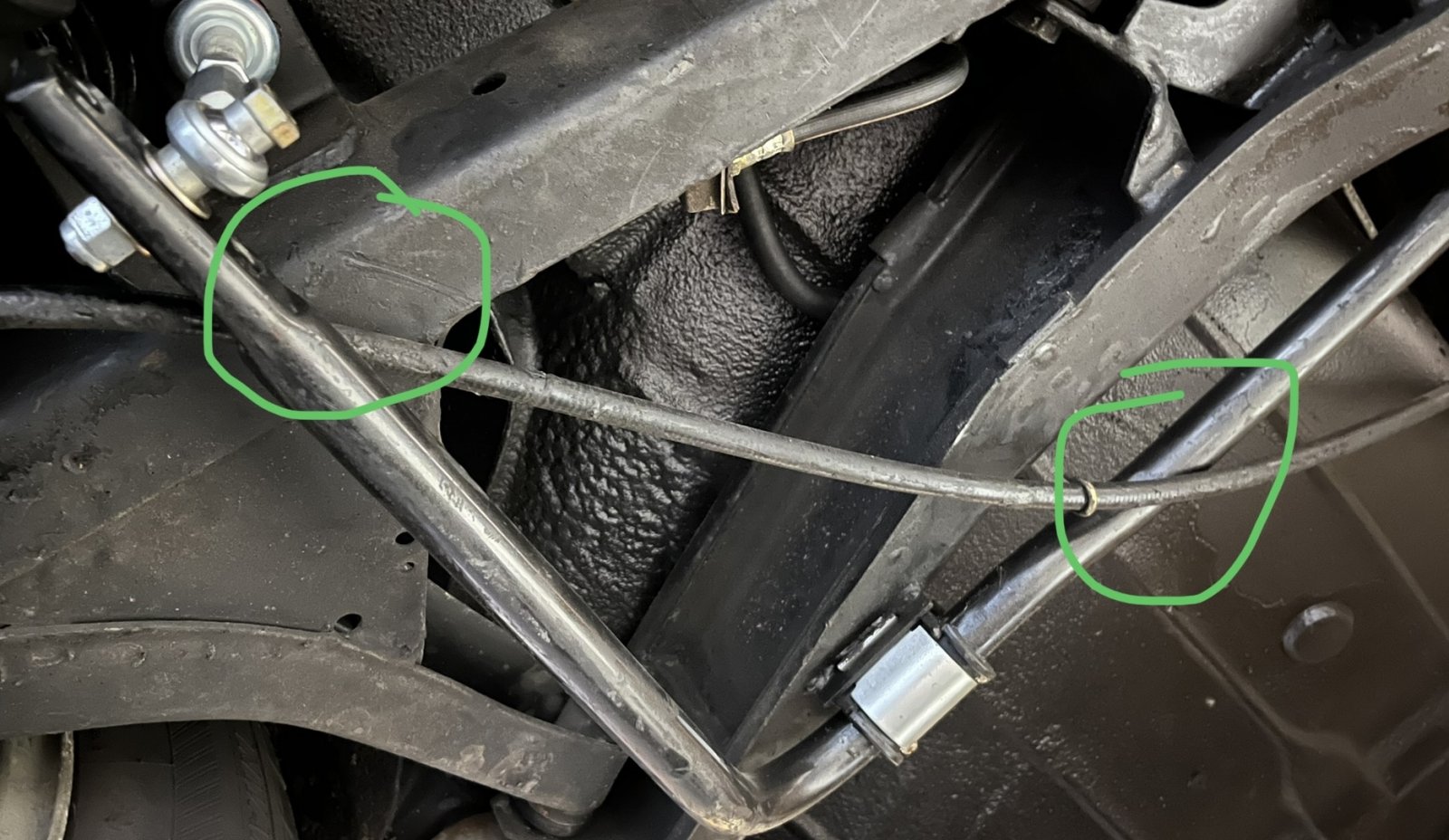

When I installed my rear anti-roll bar, I routed the e-brake cable in a way which minimized bending, underneath at the forward bracket and over at the adjustable link.
However, when I was looking at it today (tightening up my reworked FB exhaust), I started to wonder if the cable might get pinched under an extreme droop (catching air off a hump). Is this how y’all do it (see green circled places)?

The cable goes over the bar, suspended by a hanger from the trailing arm. If it’s routed under the bar, you’ll see it like on this car.
The relative location of the bar to the arm itself should not change much since the end is attached to the arm via the end link. The bar is limiting the movement of the trailing arm.
