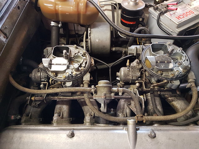

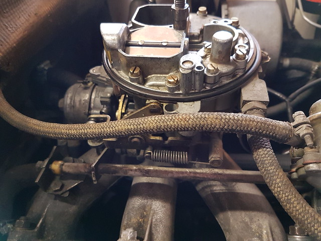

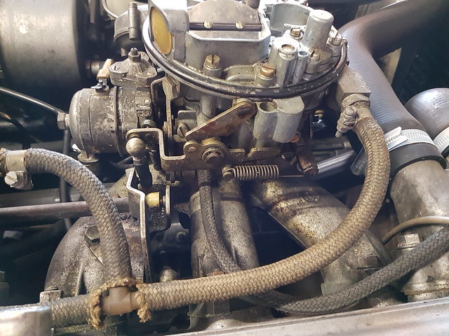

Thanks for the reply. Regarding the starting sequence you describe, this is what I have always done and until now it has worked perfectly. It does have the fuel shut off valves and these are both working however I noticed that disconnecting the rear one causes the engine revs to drop a little but disconnecting the front causes it to stall, indicating that the rear carb is doing a lot less than the front.
The car was built late 72' UK market. The problem with a lot of the technical information available is that they describe systems specific to the US market making it quite confusing figuring out what setup I have. The wiring diagram is from the original handbook therefore I know this is correct. The issue is that I don't know if it's a cold start problem or something else as even when up to temperature it runs rough. Here are some photos of the engine bay.

thank you for photos
perfect stock including original hoses, (i would replace them just in case a 45 y.o. fuel hose,...) they are not forever
have you ever rebuilt them ? clean and new gaskets ?
