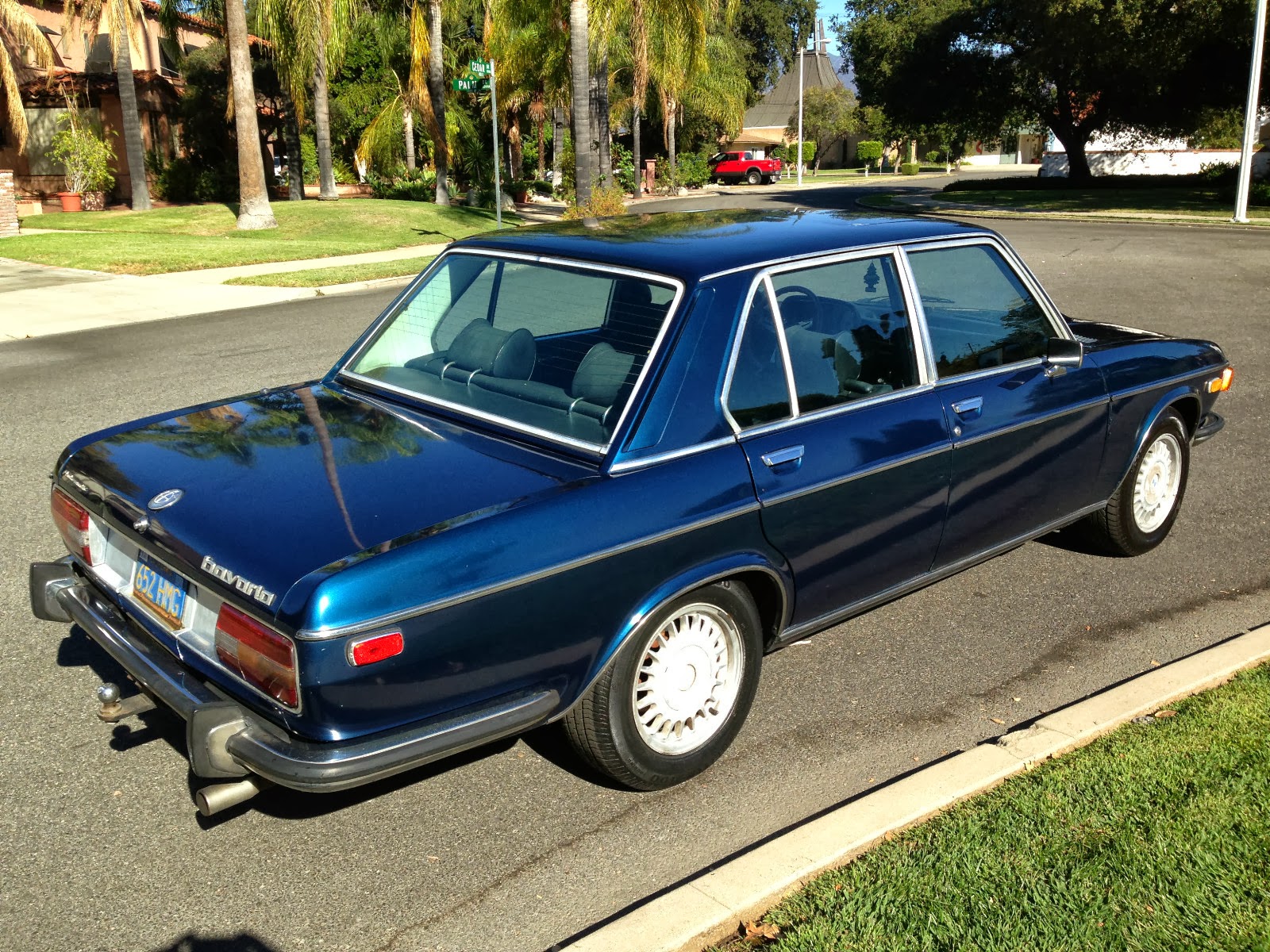

hey I own the last car now, I have had it since 2017 purchased it at an auction in PA. Wha a coincidence, was this your car?
