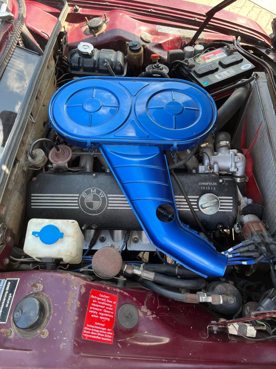

See pic of the E3 engine

I, personally, am a big fan of the Zenith carbs. When they are completely sorted out and adjusted properly, they work well, give ok fuel mileage and are fairly dependable. my .05 cent worth ( inflation ) And I think they sound cool when cracking a pair open throttle
Thanks, Rick
How does the E3 run? Does it run like you want your E9 to run?
Which Bosch injection system was added to your E9?
What carbs are on the E3? Zenith or Webers? If Webers. which model? If Zeniths, are all the original electrical devices present?
Thanks to both of you,
Dick makes some very interesting points. I still need to drive the car, and it has Zeniths (I also need to check on the electrical devices).
I need to double check the injection in my E9, but I'm fairly sure it's D-Jet.
The E3 Club's former president always recommended to leave the carburettors with the engine as there are so many different versions. That said, I see it is not possible here. Zenith for E3 & E9 were usually identical when engine/gearbox combination and country specification and model year were identical. If your 3.0 CS is a USA version and has the original engine, apart from the injection gear, then the original Zenith from a Bavaria the same age and same gearbox might work fine.
Zenith up to about 1975 have two heating systems, an electrical one and another with a coolant circle. The latter was dropped on later ones. From about September 1973 there is an additional internal air circlulation and different cold start gear. I still have not completely understood the Zenith. Were they a watch, they'd be called <<grande complication>>. Yet I like them very much.
Looking at the picture, the heat deflectors on top of the exhaust are the older version. Don't know exactly, probably not younger than 1973 which may be a good sign. On the other hand I see a vacuum box at the rear of the engine, not sure where it is connected or if at all. That box appeared quite late on Euro versions, maybe 1975. Perhaps USA versions got it earlier. The distributor is the early version, you will need it. D-Jetronic cars have their own special distributors.
Whether the D-Jetronic will work or not in the E3 is something else. There are lots of small parts hardly anyone checks, and none of them were built to last 50 or more years. As an E3 guy I would leave and use a nice running E3 as it is and try to get rid of a problematic E9. You seem to be an E9 guy so this may be not an idea you like.

It's easier to swap back to Zeniths than the other way around! All you will need is already there.

surprised ! thats a tasteful color combination in that e3 engine,
i guess if the blue touch came from the silicone cables, and spreaded the blue infection to other parts...just an observation
on the issue
i have been around cs and csi models; i prefer zenith CS because i know a bit about how to handle and fix them, and i feel that after a good process they work nicely, the car is powerful and i can rely on my own expertise to maintain them
for many years it was easy and cheap to find replacements because many people were offered to swap their zeniths fro anything else
i agree with stevehose that back to zeniths may be easier, to me is a question of two manifolds, and two carbs, and a couple of electrical connections, but we need to take a look to your distributor too, not to mention the fuel pump.
i can not understand your plans, build a better e9 removing parts from the e3 ? well it depends on the price, but maybe is better to source the bits for your e9 elsewhere, noone can tell you that the e3 bits are shot or good

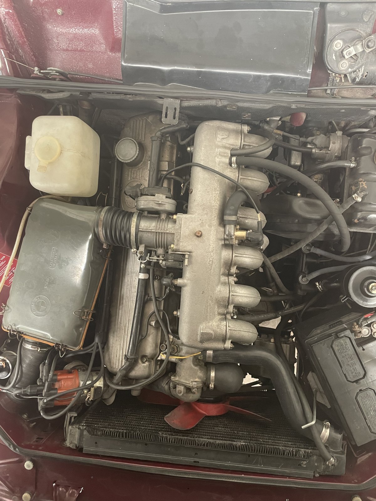

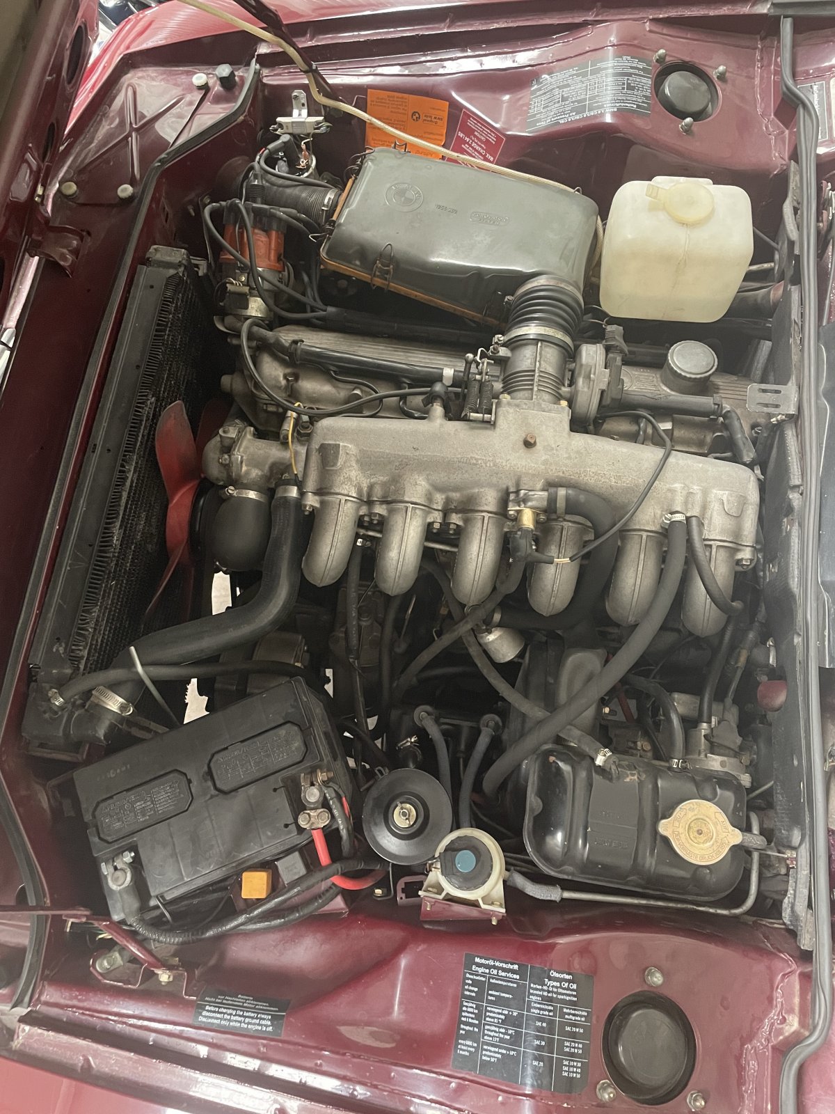

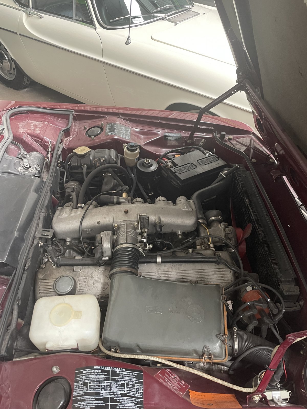

could you share some pics of your e9 engine ?
- cyl head
- distributor
Lastly, I could not stand seeing your record of 150 messages and zero likes. I do like the idea to return an engine to Zenith carburettors.
all yes to this, and also you can see air filter has the older tabs to close the lid, so i would say <73 sure
Thanks, you make a good point that sourcing the parts might be cheaper and easier than buying another car, someone else already pointed that out.... My idea is to built a better E9, and when I saw the E3 for sale I reasoned that all the parts are already there (hopefully), and it would be fairly easy to swap, but it might not be the best way to go.
I don't have picture handy of the E9 engine, I will take some and post them later

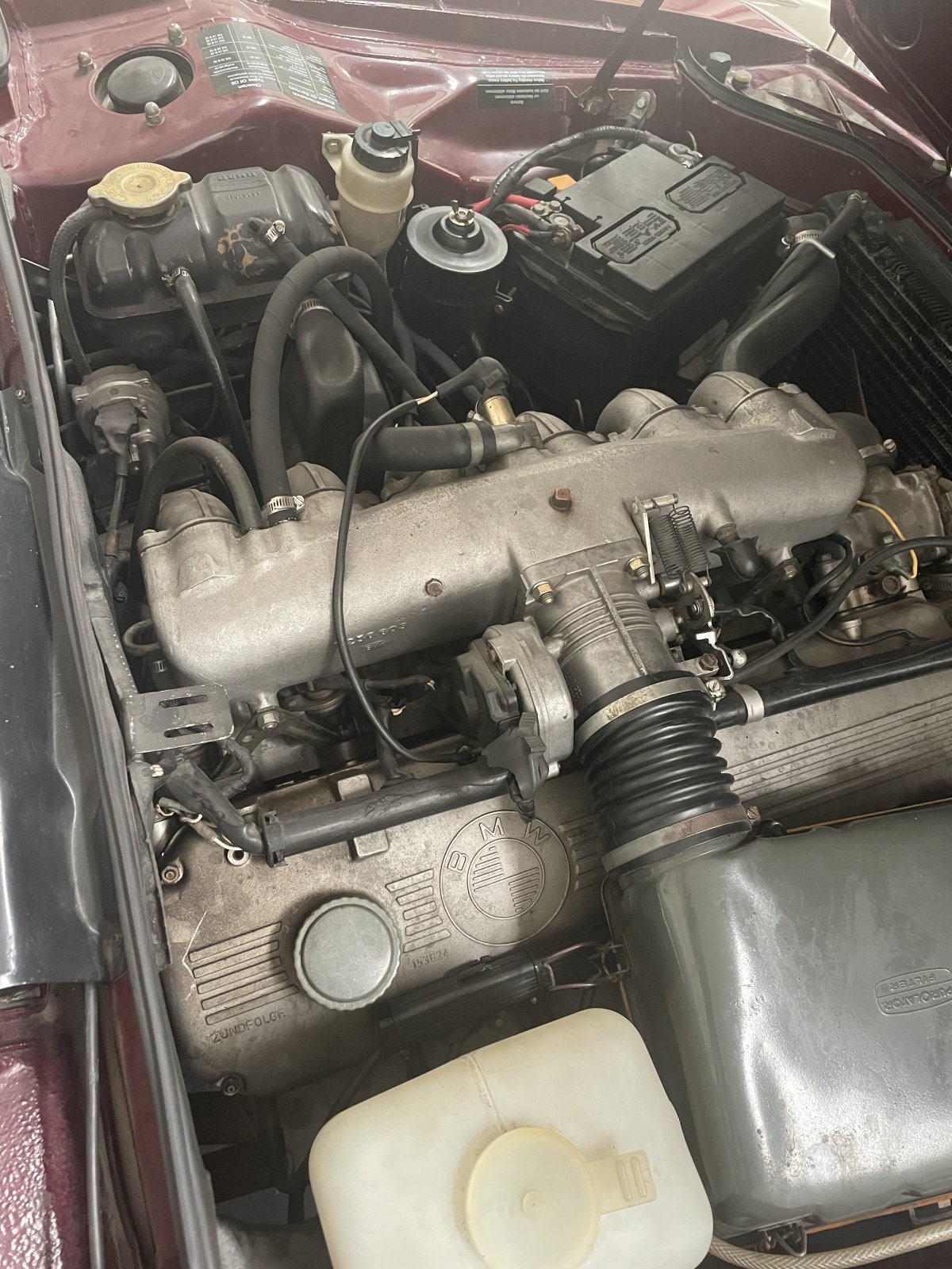

Henry
This looks like the pollution/emissions system which prevents abrupt closure of the carburetor throttles by slowing it down to a few seconds. I think this was introduced in the USA maybe in 1973 .

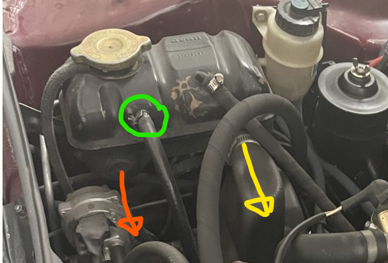

Are you talking about the windshield washer reservoir or the coolant reservoir. Why does it seem odd to you? Both are the same as what I've seen on other cars
"Both are the same as what I've seen on other cars"
you must look more in detail,
coolant,
not same as CS, see
yellow big hose should be at orange position, you can clearly see that orange point has been closed with a welded cap
green inlet is odd to me, not present in a CS
- to make a CS car you need a different reservoir

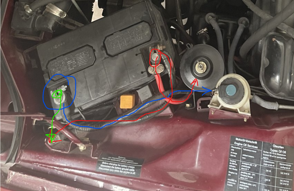

the battery drama:
i can not see any sign of polarity in those terminals, but based on the red cable i would say that positive is at the right side,
then in blue i have marked what the negative terminal seems to do with that black cable, pretty odd as the normal way is to go like the green line, straight to the body
the red cable arrowed in red too seems to go towards the starter, which is normal, but then a second black cable heads from the right hand side of battery to the body
making this impossible to understand to me
is that battery standard, i mean positive at RH and negative at LH ?
is your car negative to ground, or positive to ground ?
in a 50 y.o. car everything is possible
the battery drama:
The positive is at the right side with the red cable going to the starter as you mention. I have to check where the black cable (from the positive) goes, it doesn't go to the body I can assure you that, it must be powering something else.
The ground or negative cable is easier to explain. I have a battery cut off switch installed in the left hand compartment (where the hood opening handle is), so that's why the ground cable doesn't go directly to the body. It goes from the battery to the cut off switch and then to gound.
Not only is this a 50 y/o car, but one that was messed around with in the 90s when it was converted to a CSi. Add to that the fact that I am in in Mexico, and there's probably less than 10 E9s in the country, so I have nothing close by to compare it with....and there are no mechanics that have specific knowledge of the E9.
I appreciate you pointing these things out so I can investigate and return to original whenever possible.
Same story with the water tank, I never realized it was incorrect or modified, now I have one more thing to fret about... ;)
