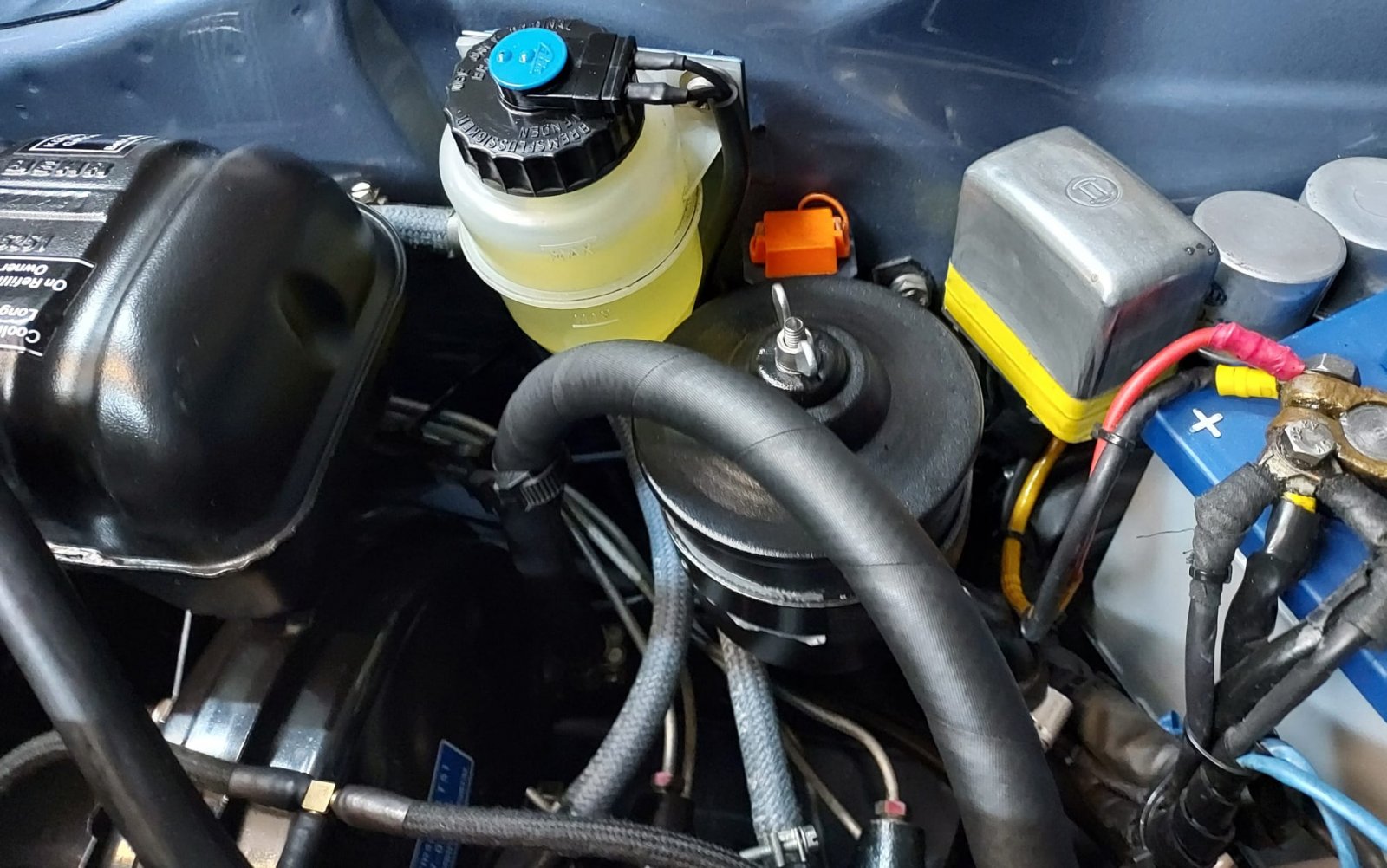

The positive is at the right side with the red cable going to the starter as you mention. I have to check where the black cable (from the positive) goes, it doesn't go to the body I can assure you that, it must be powering something else.
The ground or negative cable is easier to explain. I have a battery cut off switch installed in the left hand compartment (where the hood opening handle is), so that's why the ground cable doesn't go directly to the body. It goes from the battery to the cut off switch and then to gound.

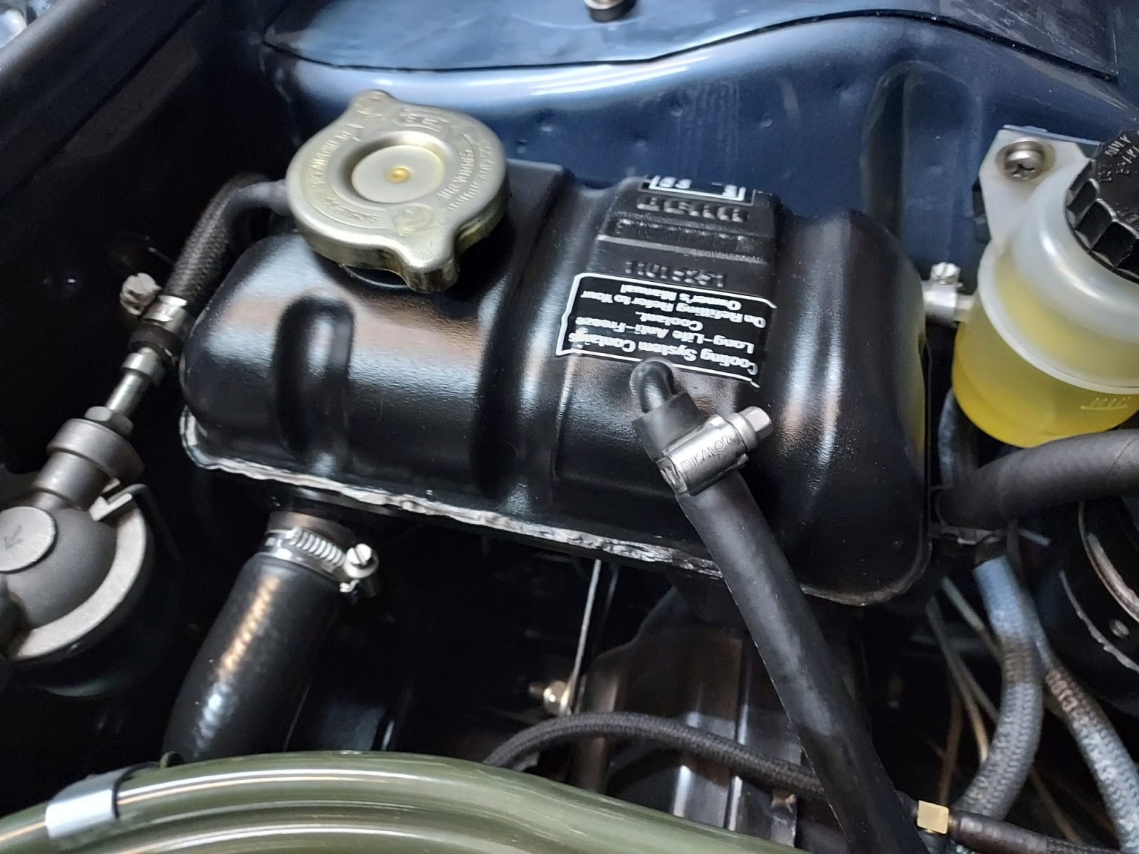

Same story with the water tank, I never realized it was incorrect or modified, now I have one more thing to fret about... ;)

battery mystery solved then…
Some random pics of cs engine bays

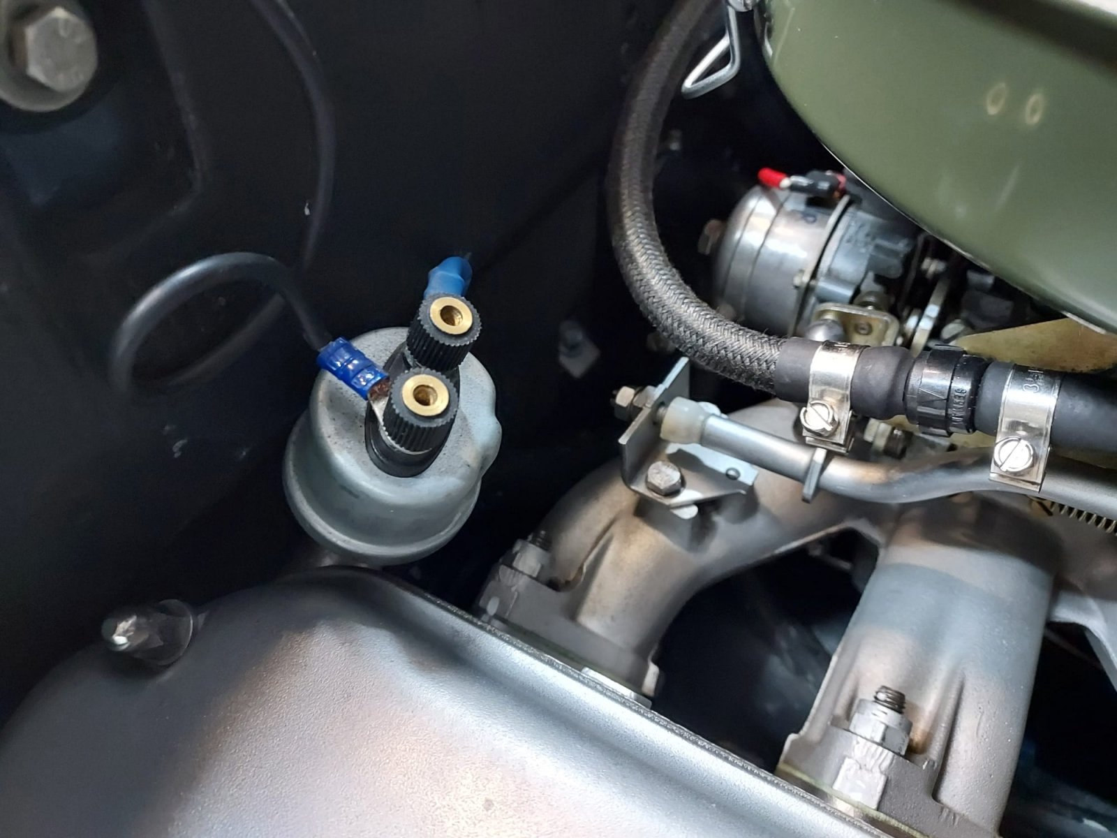

Forget the oil pressure sensor

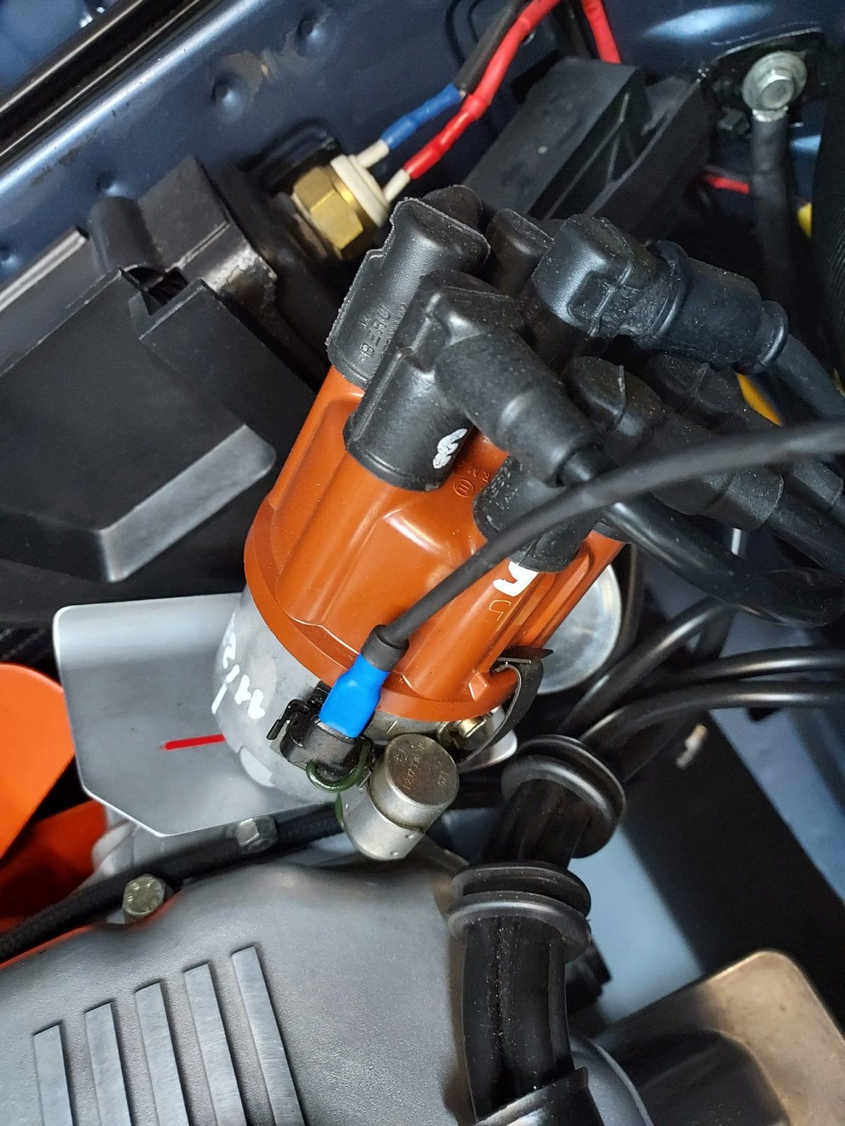

distributor for cs
battery and surroundings
coolant reservoir

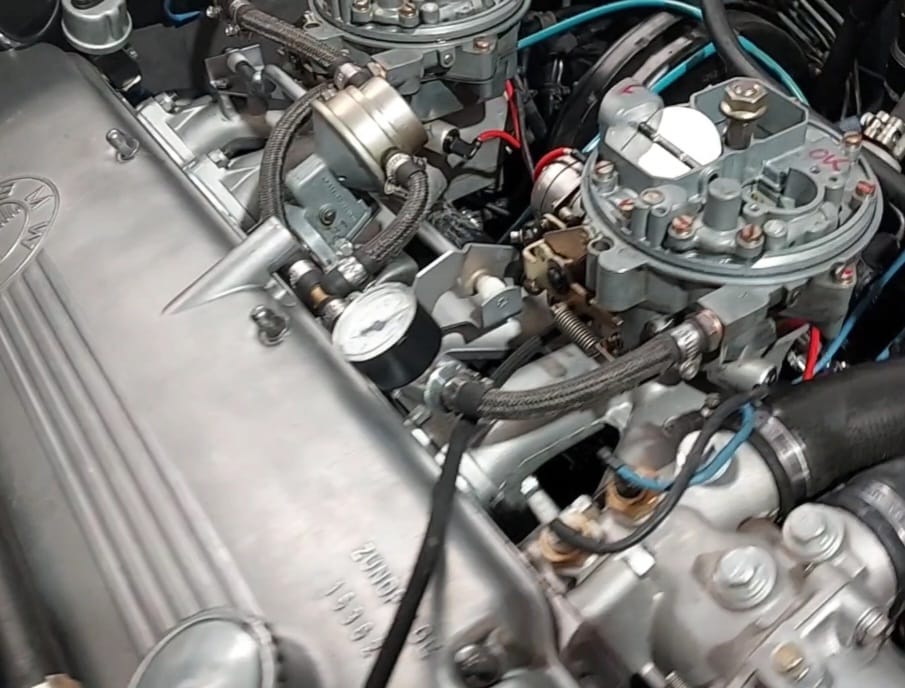

mech fuel pump and carbs
set up is much more simple
i would say that many zenith configurations will work,
the simplest one is for carbs with no additional air valve, those ones only require a 12v hot lead
