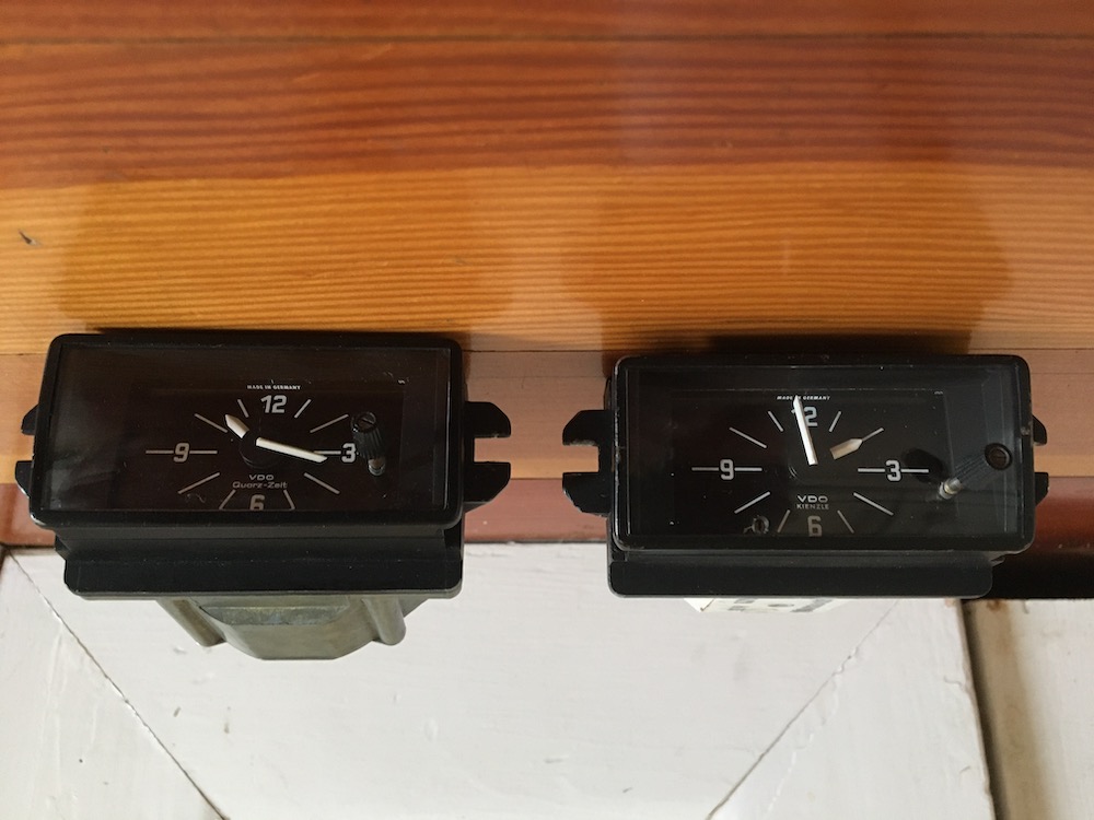

Later this year, I was fortunate enough to score two parts clocks from a forum member (thanks Tom!). One of them was a electric/mechanical clock just like mine, and the other looked exactly the same but was marked "VDO quartz zeit" instead of "VDO Kienzile".
I am guessing that BMW changed to the quartz clock when they became widely available...maybe around 73-74. They were simpler, kept better time, and were less expensive. Real OEM was not much help in pinning this down. In fact, Real OEM shows the part number for an E3 clock as being the same as for all years E9 also...but I have never seen an E9 with this clock.
I sent my clock back to Clock Works along with the parts clocks with a request to try to make one good clock out of the two Kienzles and to try to repair the quartz model. They did both. I chose to install the Kienzle in my car. It was the original clock for the car plus I love the barely audible (to my old ears) ticking...then the "clunk" as the points close and the clock rewinds. I figured I was sacrificing some time accuracy in so doing, but so far the Kienzle is quite accurate.

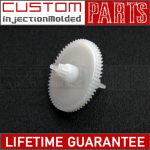

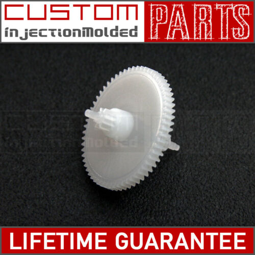

I sent my VDO quartz clock out to ClockWorks who said it was not repairable due to a broken plastic gear, which is the case on about half of these clocks according to them (If you open your clock up it's a thin plastic orange colored gear.) However, while trying to find a replacement or see if I could get one 3D printed I stumbled on someone selling the replacement gear, which was just installed and is apparently working on the bench so it appears to be correct.
https://www.ebay.com/itm/275240048176
I can also vouch that ClockWorks was great to work with - quick response and repair. I threw them a parts clock as well so they have a few now (although they used a couple better gears from that in mine as well.)
