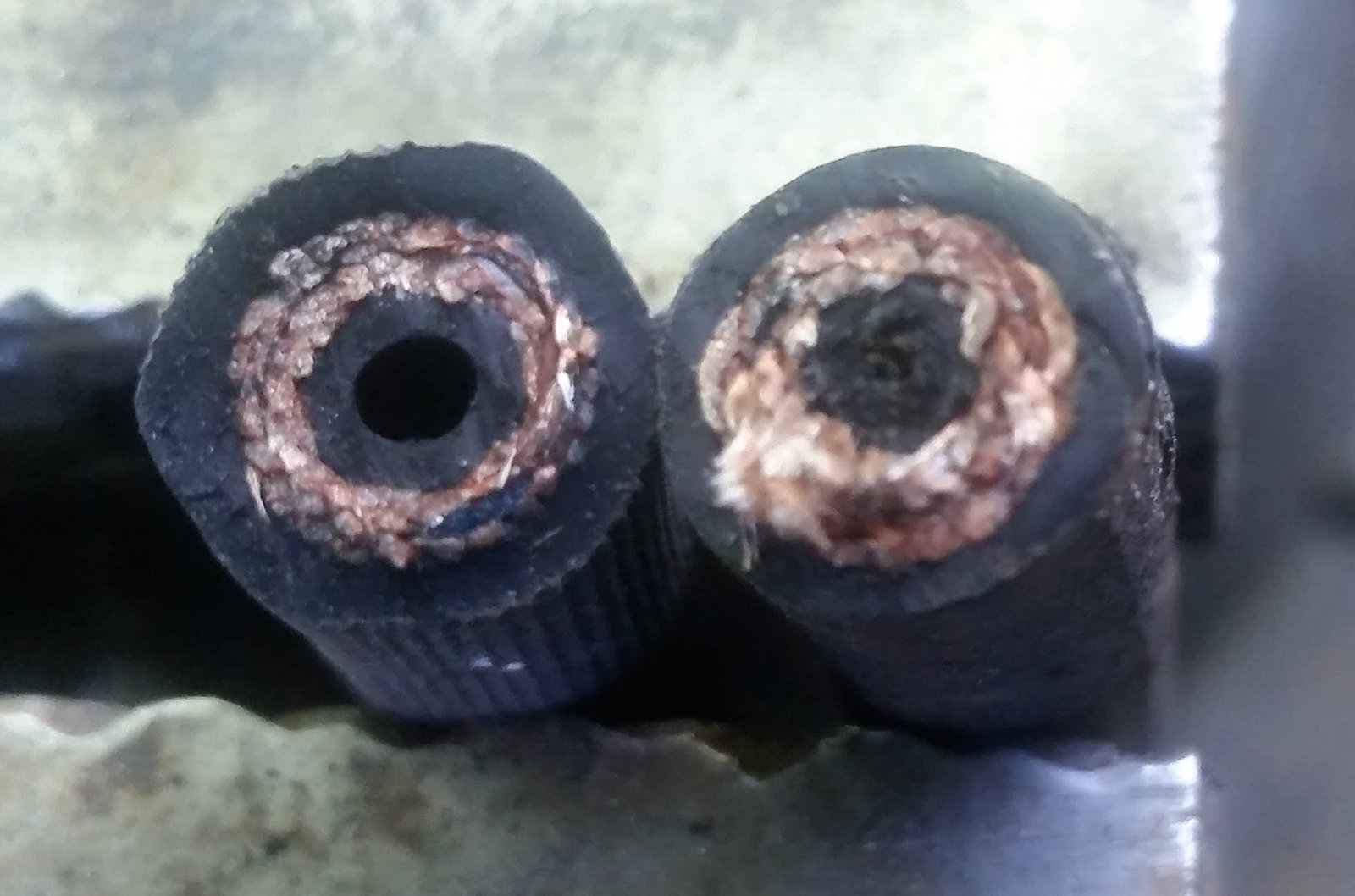

I would check your brake hoses as you may have them collapsing inside and holding pressure when they shouldn't. Also you may want to check the brake and clutch pedal travel and see if they are in spec. Another thing to check is if your booster working properly? Put your foot on the brake pedal and start the engine and you should feel the vacuum assist come on.

Bear makes a good point. Old brake and clutch hoses do collapse inside and make for disappointing results when you think you have thrown new parts at a problem and it hasn't helped. Let us know how it goes .

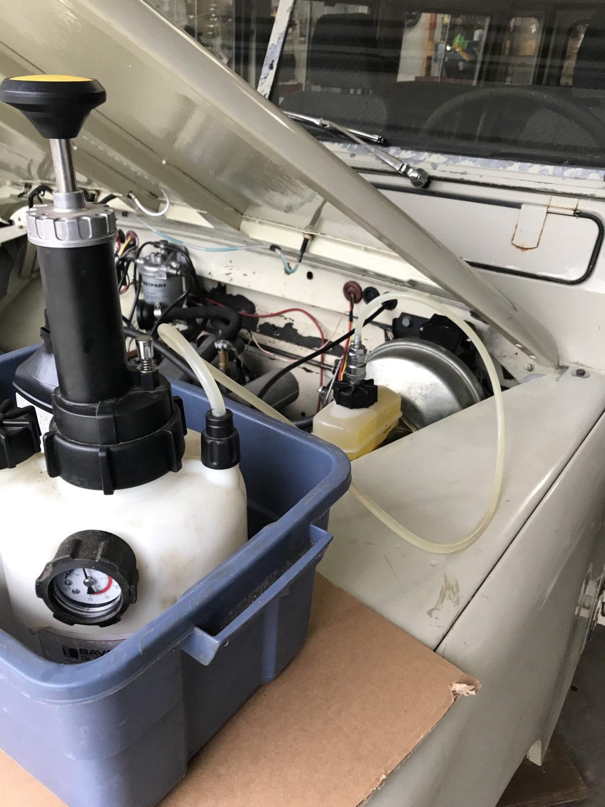

This is one of the easiest and fastest jobs you can do. And it is a perennial cause of poor braking behavior. The flexible lines are inexpensive (the same ones as on the 2002) even if you opt for the stainless steel version. I highly recommend you buy or borrow a pressure bleeding unit (https://www.amazon.com/Motive-Products-European-Bleeder-Pressure/dp/B0002KM5L0?ref_=ast_sto_dp&th=1). Instead of filling the pressure tank with brake fluid, just fill the original brake fluid reservoir and top it off as you bleed. Much neater.

Totally support the swollen hose theory presented above, the simple fix and the huge difference fresh hoses make. I'd splurge on a set of flexible stainless hoses; many sources. Also, strongly support the purchase and use of a pressure bleeder; it makes the job so so easy and quick and several of them can be used on many manufacturers (as theres only a few brake part manufacturers used by so many vehicle manufacturers).
