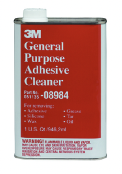

I know this is an old thread, but I am installing an after-market hood liner on my e3 and wondering what materials are best to clean/prep the surface where the old liner has crumbled away. Thanks!
Citrus based cleaner and a plastic scraper to get all the old glue off then some simple green.
Goof Off Pro and a kitchen sponge worked best for me by far for getting off the old mastic. Then followed up with a light cleaner (simple green would do.)
This is the best product that I have found for removing contact type adhesives as used on weatherstripping and likely on the hood pads. Does not harm automotive paints (but test first to make sure)...
Thanks, all. I ordered some of that 3M stuff off of Amazon and they shipped it to me. I have the hood off of the e3 at the moment so that should make this easier.

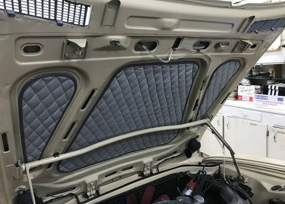

Assuming this is a long shot, - anyone know of a source for pads that look like this?
