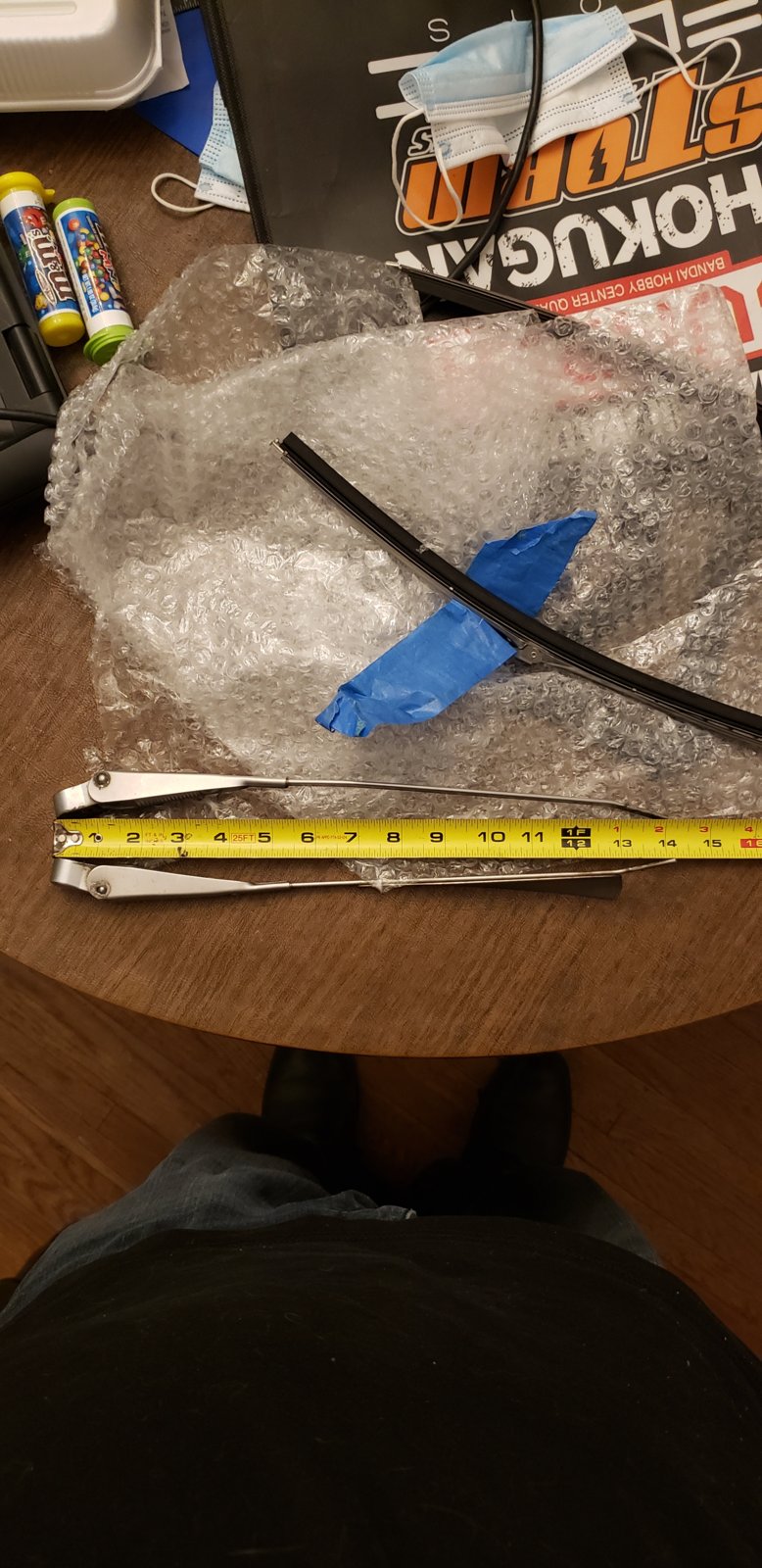

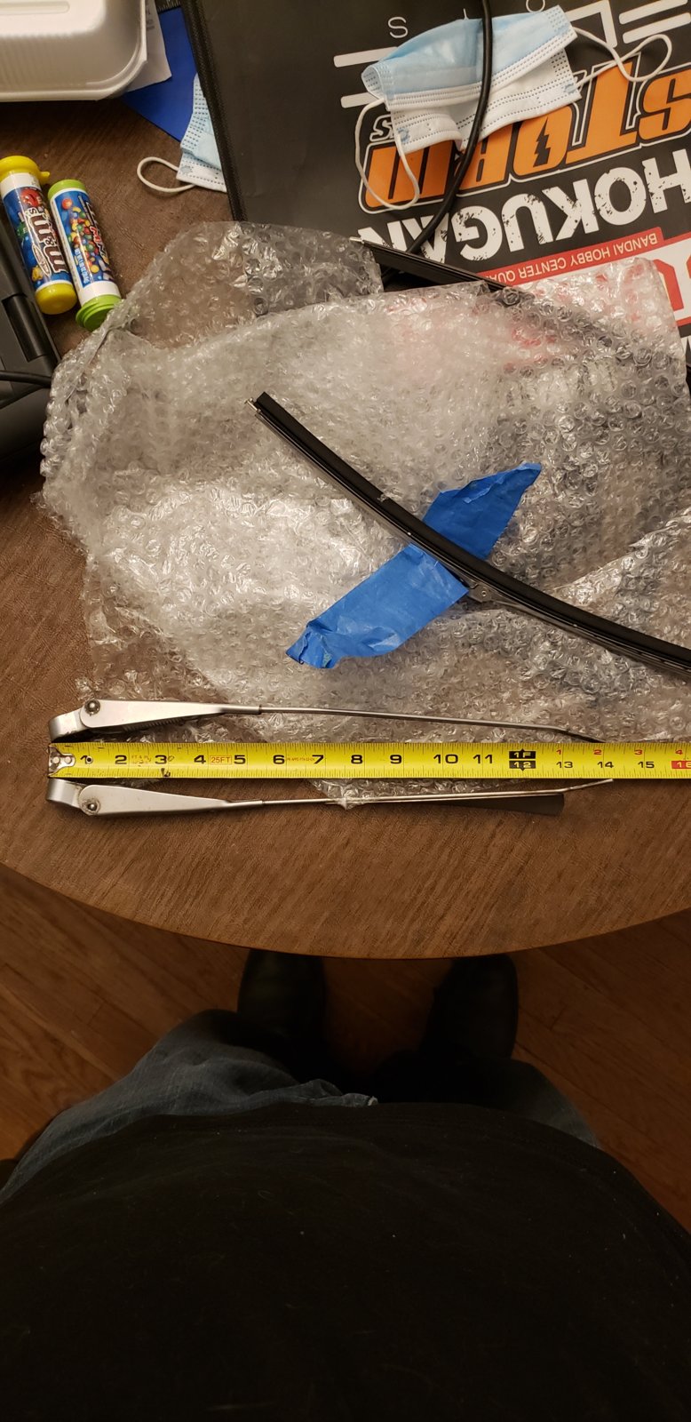

What are the differences between E3 and 2002 wiper arms? Do both also fit E9?
Are the ones in the picture 2002 or E3?
Thanks for your help.

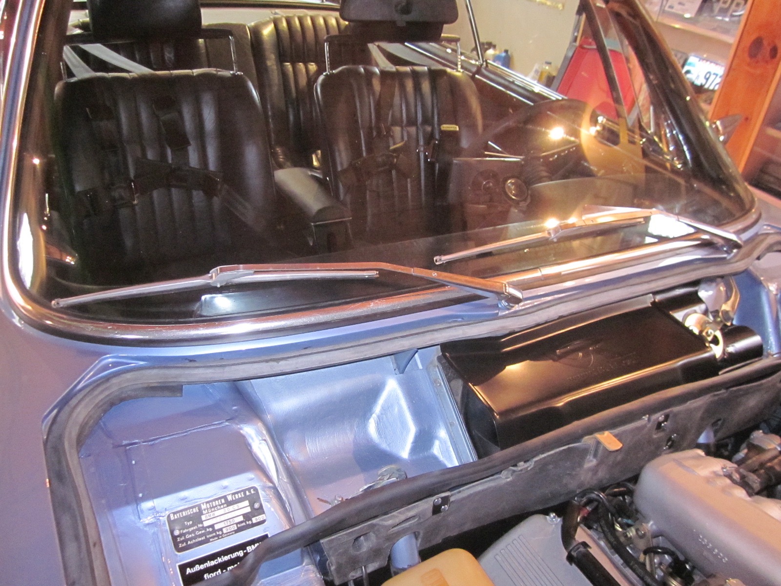

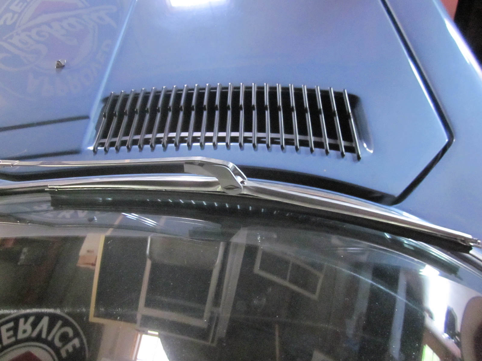

Those are BMW 2002 wiper arms, they have bayonet ends.
E9 & E3 have "shepherds crook" ends.
Both will work on E9s & E3s.
Thank you.
I was sold those as E9 wipers, from a member.
I just realized something was off.
They have 15" blades, but I thought 16" were the size for E9.
I love the learning curve, as much as I try to resist it.
