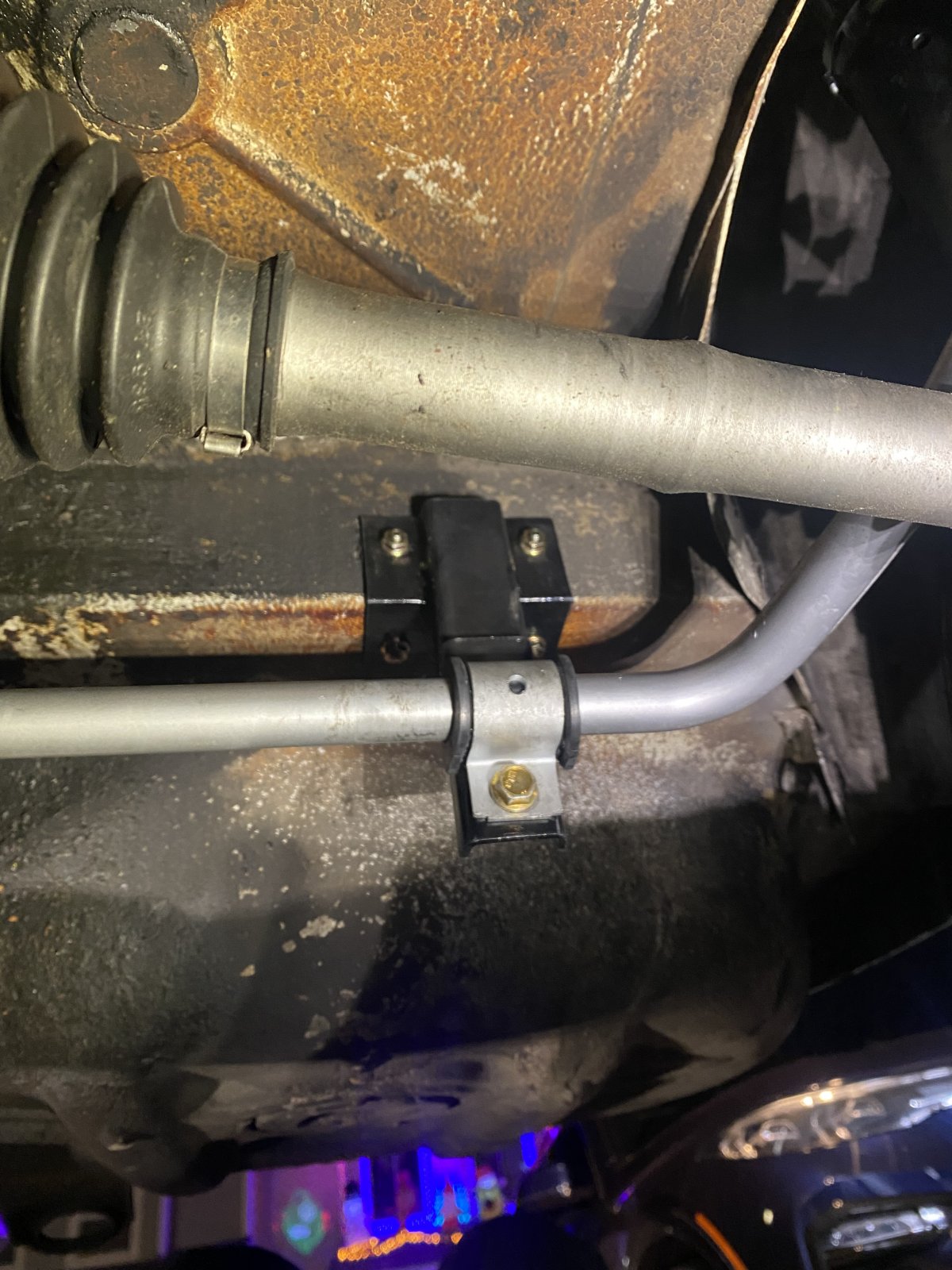

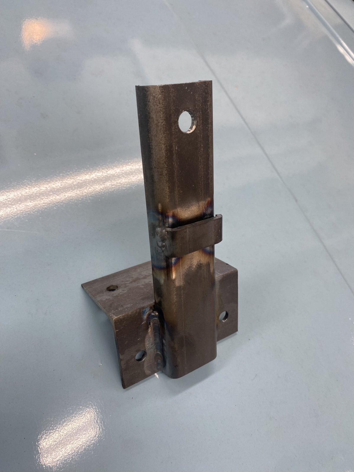

Finally got around to installing the rear swaybar. Made a simple bracket that bolts to the trunk floor pan. I would have liked to weld this on, but the passenger side is inches away from the gas tank. Using angle iron and bolting to the side and bottom of the floor pan should be plenty strong. I added plates on the inside of the trunk to sandwich the sheet metal, it’s fairly thin there. I went with an uuc 22mm swaybar. It’s very noticeable, but feels solid.
Very professional!
