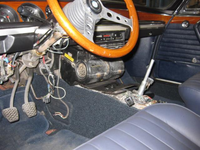

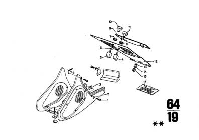

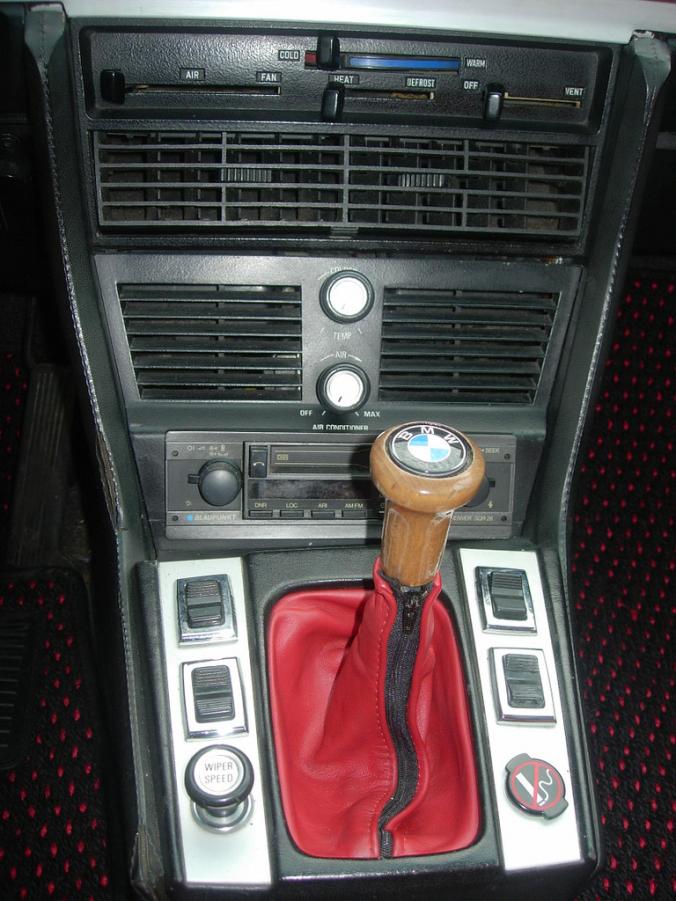

This is what the blower control and the a/c looks like. The second picture is my car..the rest are borrowed.
