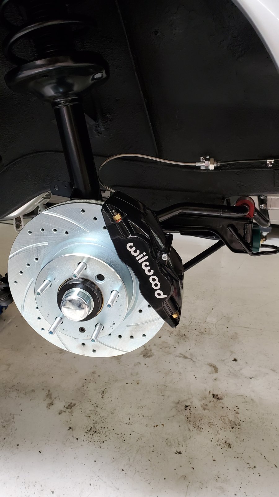

Refresh bushings, rebuild calipers, add stainless steel brake lines and a good high temp fluid and pads.
I have been very happy with this setup. Works great on street, mountains and on the track/racing.
