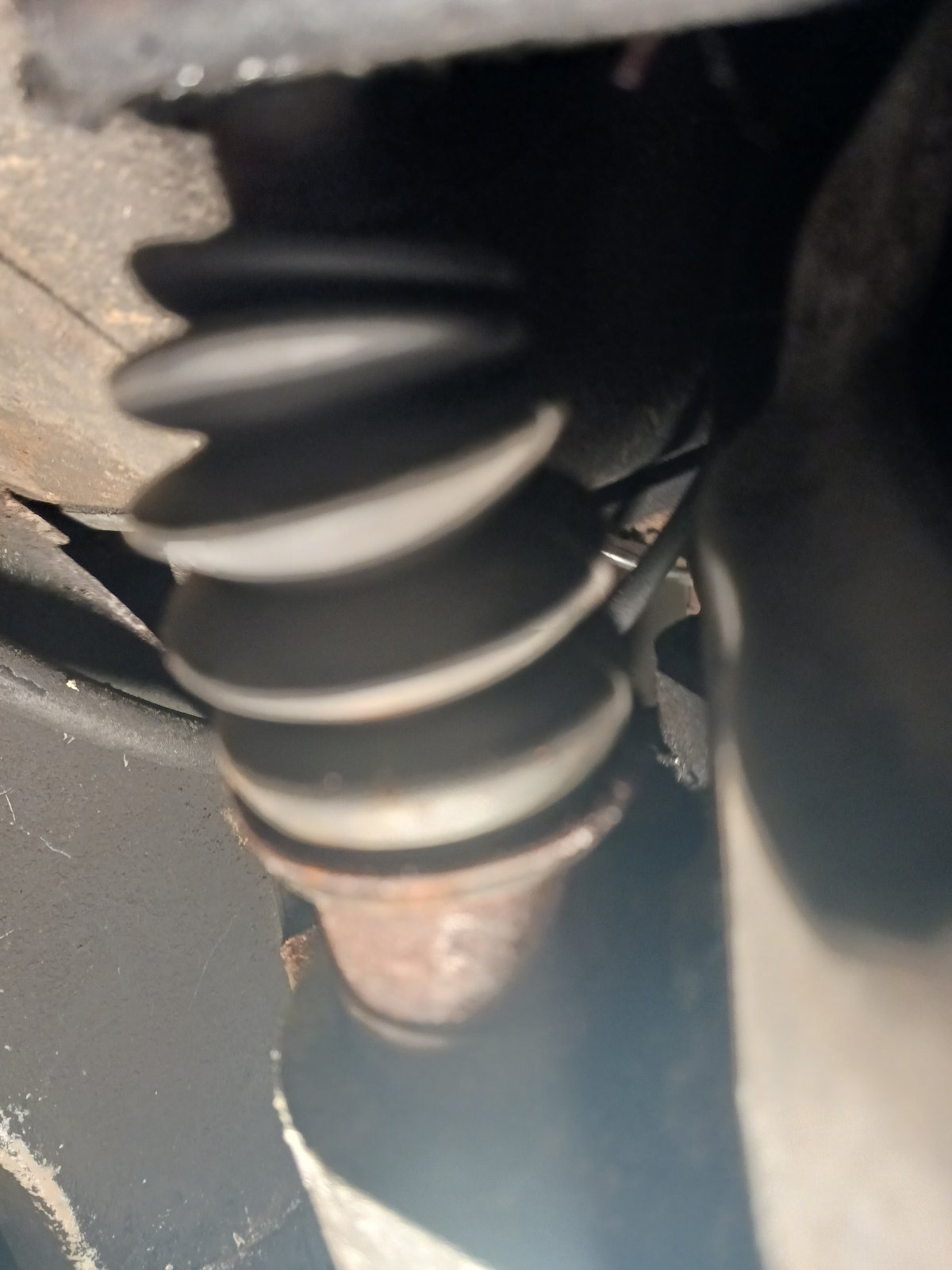

It's held into the transmission/clutch housing by a circlip. Photos were hard to get, but here's one showing the bump in the housing that contains the cylinder. I used a mirror to view the circlip.

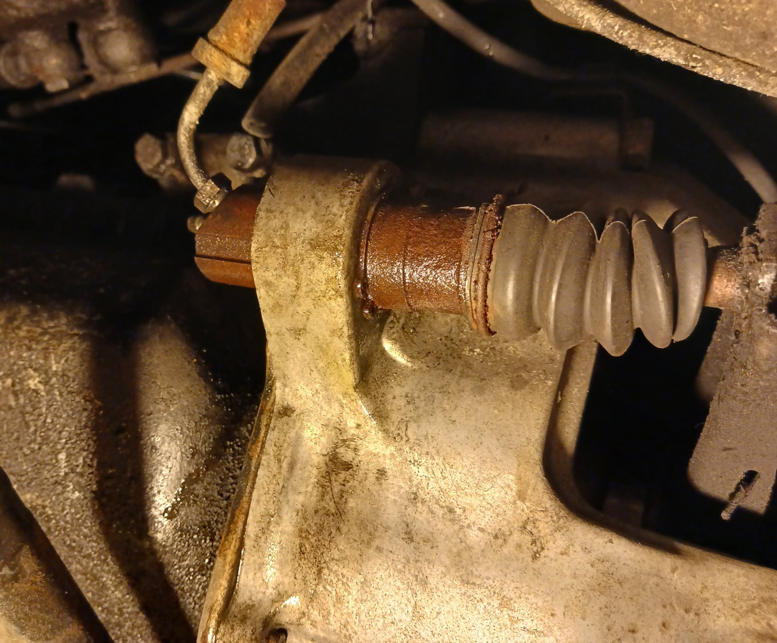

start the penetrating oil now on the circlip and where the body of the cylinder goes through the loop in the bellhousing
Here it is, soaking in penetrating oil. The circlip is visible on the right side of the loop in the bellhousing. I don't have a circlip tool, but I do have 2 needle-nose pliers, a pair of fishing pliers and various screwdrivers.
As SFDon is suggesting, you may want to take a hammer and a chisel to knock the clip around a bit to get it to separate from the slave cylinder and enable it to stretch open.
If you plan to rebuild for re-use you can clean it up quite a bit by soaking in vinegar or evaporust. It wont hurt the inner cylinder which you will hone anyway, but you should remove the piston if you can.

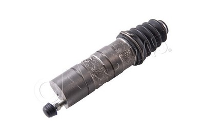

I just bought one of these. I wasn't in a hurry and it's now in and working fine.
Thanks. I saw that but the seller's list of compatible models doesn't include the '72 3.0 CS (though it does include the '72 CSi). Is that an error by the seller?
Now that you have soaked the circlip in penetrating oil, take a pick and go around both the exterior of the clip where it is installed to the transmission and the interior of the clip where it rests against the slave cylinder and remove as much rust as you can. Then spray with pentrating oil again.
Good idea. I just lightly pounded one end of the clip with a screw driver and rubber hammer. That end moved, but the other didn't, raising the possibility that the clip might break.

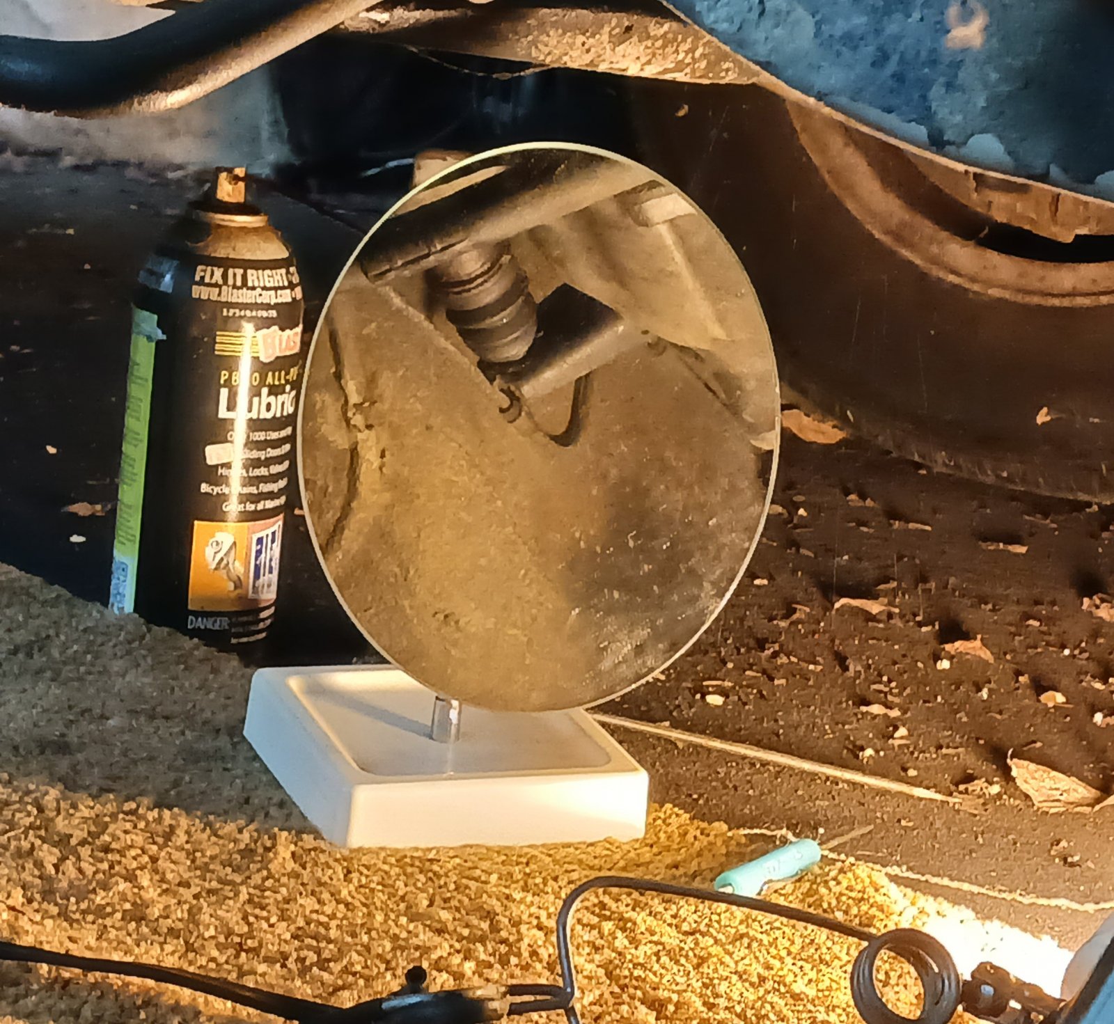

I probably should have done this earlier, but using a mirror and depressing the clutch pedal with my right arm, I saw that the slave cylinder's piston moves several inches. The pedal seems to have a normal amount of resistance. Unless something has changed since I parked the car, it appears the hydraulics are working.
