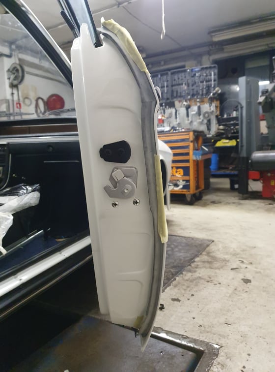

E9 door seal
It's glued into the contour of the end of the door

@Keshav I bought them a while ago from oldtimerteile just wasn’t sure how to fit them.

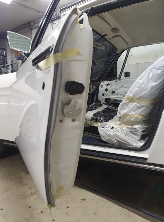

I am looking for "keder" that comes under door panel. Only found them in black - I have same color panels as @Stevehose on photos

Also wanted to ask what is the purpose of this door seal? Sound proof?
The black keder goes well with dark panels..... amd as you point out, matching the colors with new materials is not always easy.
Yes, those gaskets help lessen the incoming air sound. Thought I’d also mention, as seen in Steve‘s pic, the small plastic cover/ cap on the door latch is very important. Makes the door closing a lot better than without.

Door where closing nicely but now when I put new rubber door gaskets not anymore have to push them hard but they line up perfect.
Yes, those caps and yes, the door closing issues with new door seals is common. They eventually do ’settle‘ down but an annoying feeling to start off with.
Don had recently hinted at certain spots on the new door gaskets where some ’work’ eases the tension. You might want to ask him.
Difficult for me to say in English what I did:
The gaskets on my E9 had to much volume, so I had to much tension closing the door.
So I cutted the "gasket tube" on the long side and removed a string with several millimeters.
I glued it together again with gasket/seal glue.
I did it on the side which is close to invisible / close to the sheet of the body.
It's now 4 years ago and it just works. The optics of the gasket is like "factory" / no so overblastet
