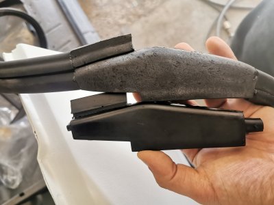

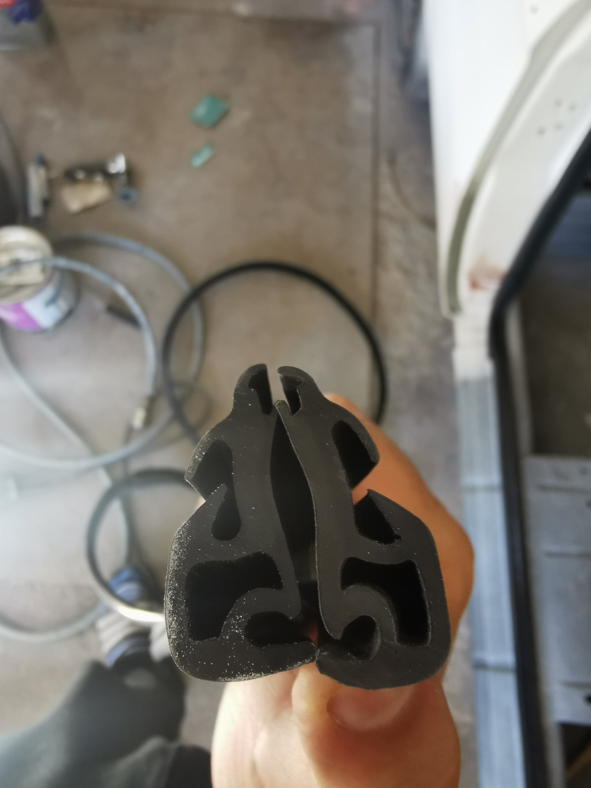

So an overall look compared to a set of NOS seals provided by @Paul Baker

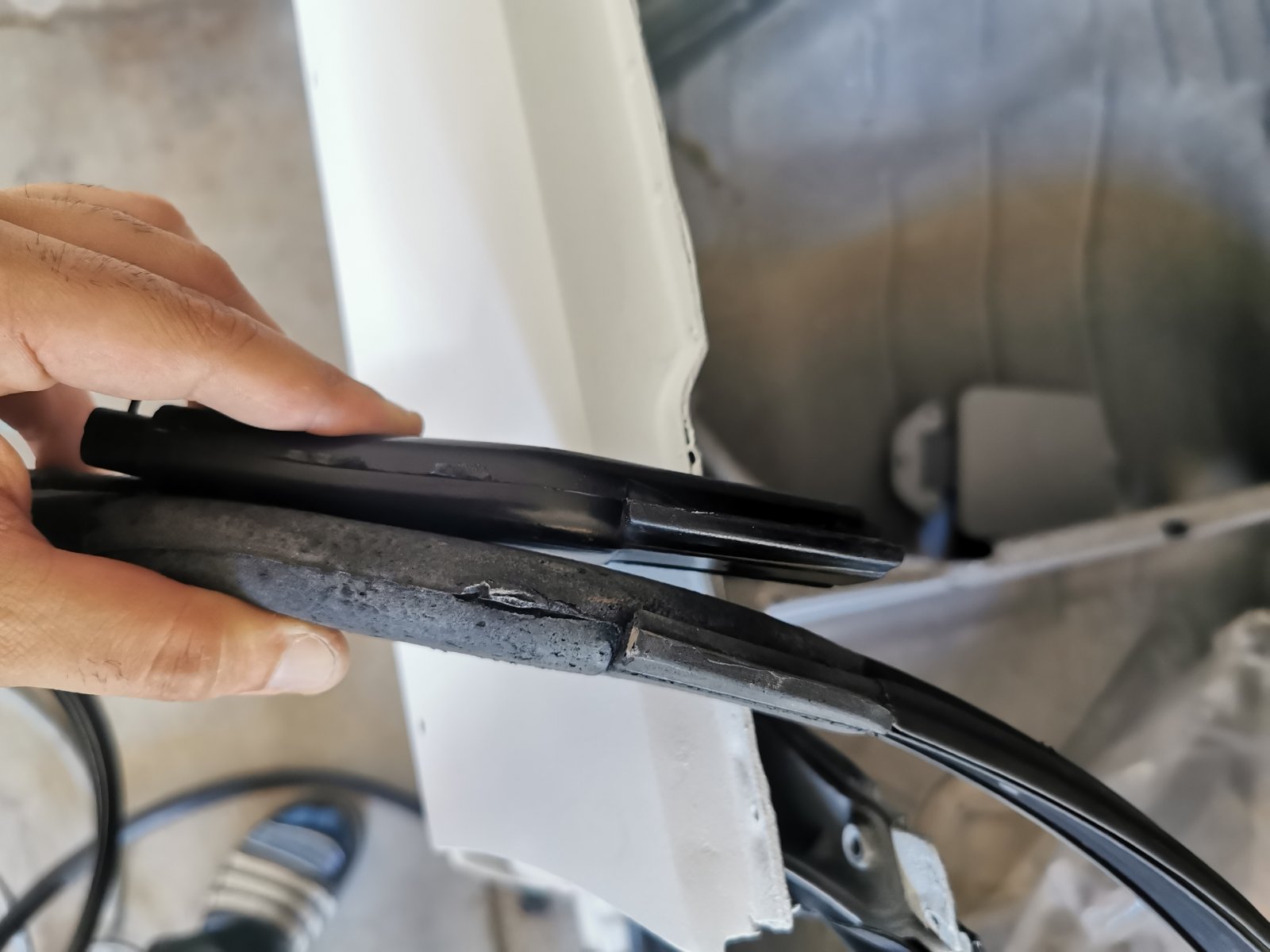

Gen bmw on the left, pattern on the right. About 2mm thicker but the rubber is slightly softer, I'm hoping that this means it will be a tighter fit on the top and helps with wind noise

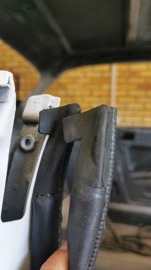

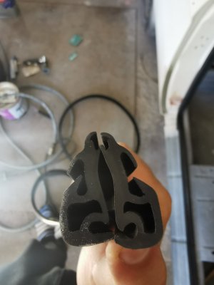

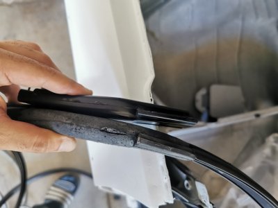

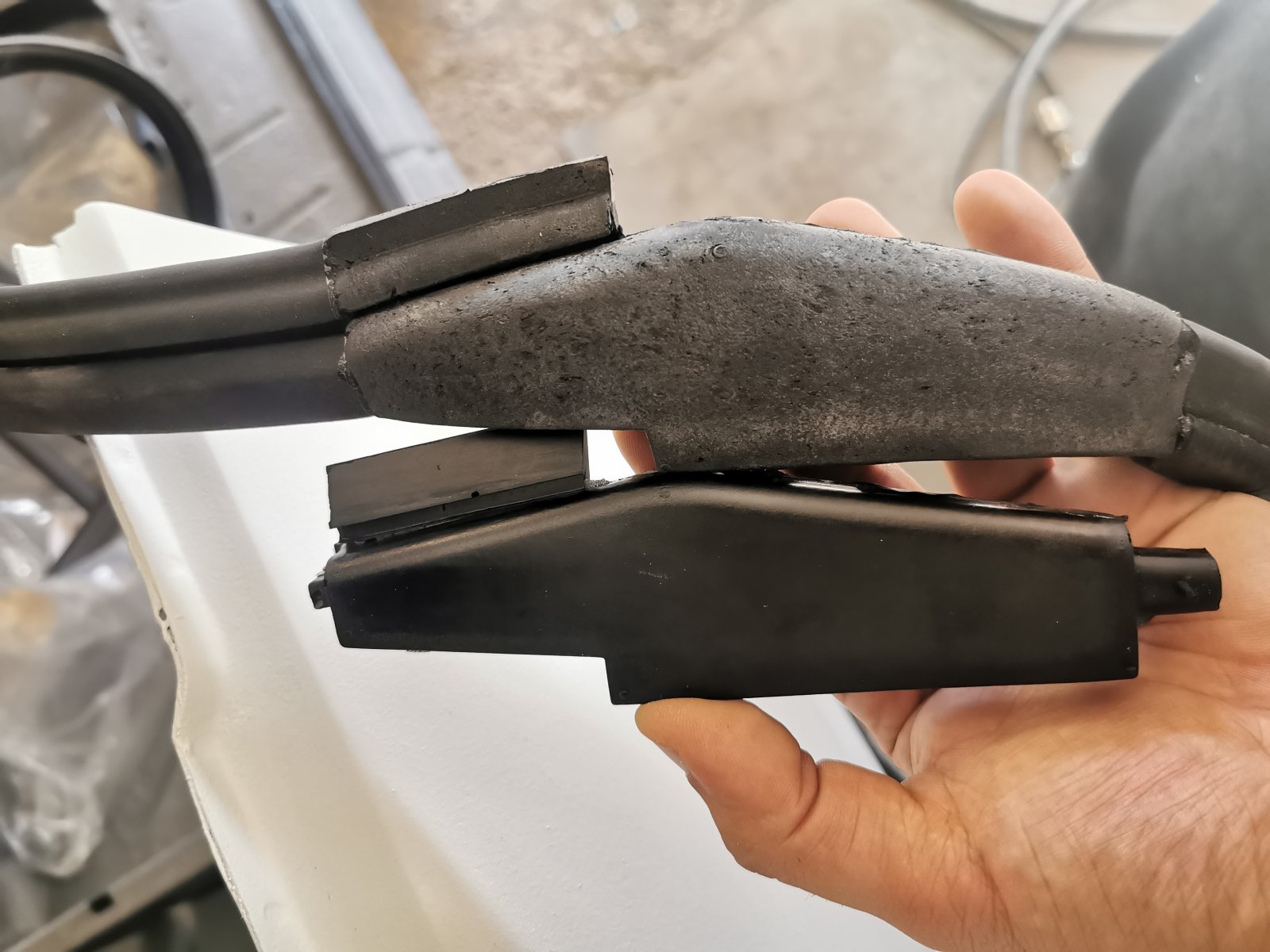

IMG_20220917_142509.jpgBmw on the bottom, pattern on top. Bmw is more like a low density rubber whereas the pattern is like a rubberised foam which deform more and is thinner. I know the bmw ones do need some shaving to fit up properly so this is probably a good thing. They also look a damn sight better. IMG_20220917_142645.jpg

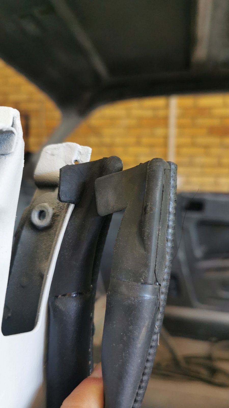

Up at the top of the b pillar the bmw part has a taper where the rubber piece hollows out before the sealing strip. The pattern is solid throughout. One thing to note is the left and right seals on the bmw parts aren't consistent in firmness, one being much stiffer than the other, whereas these are both similar.

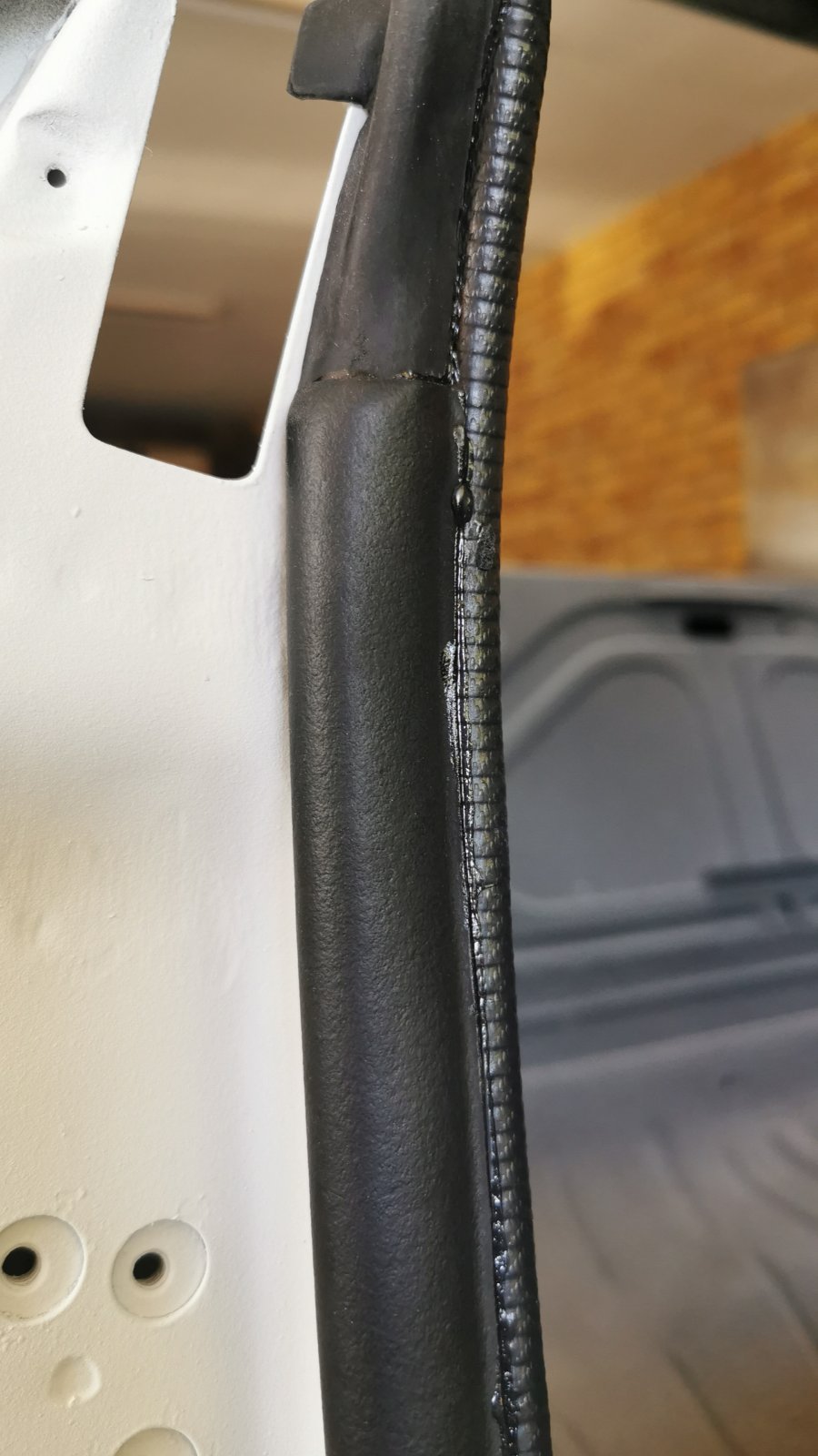

The biggest, and imo only detraction for me on these is the fact the seals glue on, there is some exposed glue and does look a bit unsightly. IMG-20220917-WA0029.jpeg
Overall, I'm happy with them (other than the issues with contact which we have found). They are well priced and were shipped quickly once the order was placed was finalised, they fit and seem to seal well and are a better option than the bmw seals if you can find them.

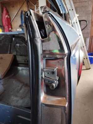

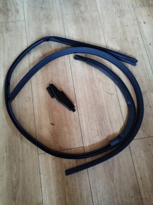

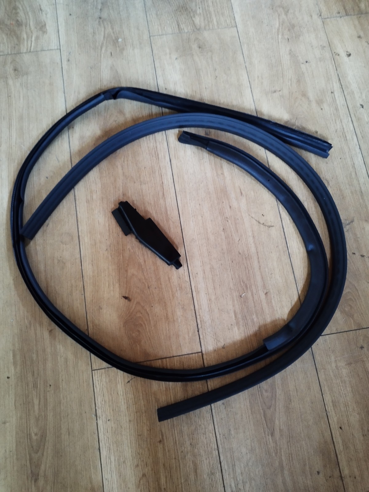

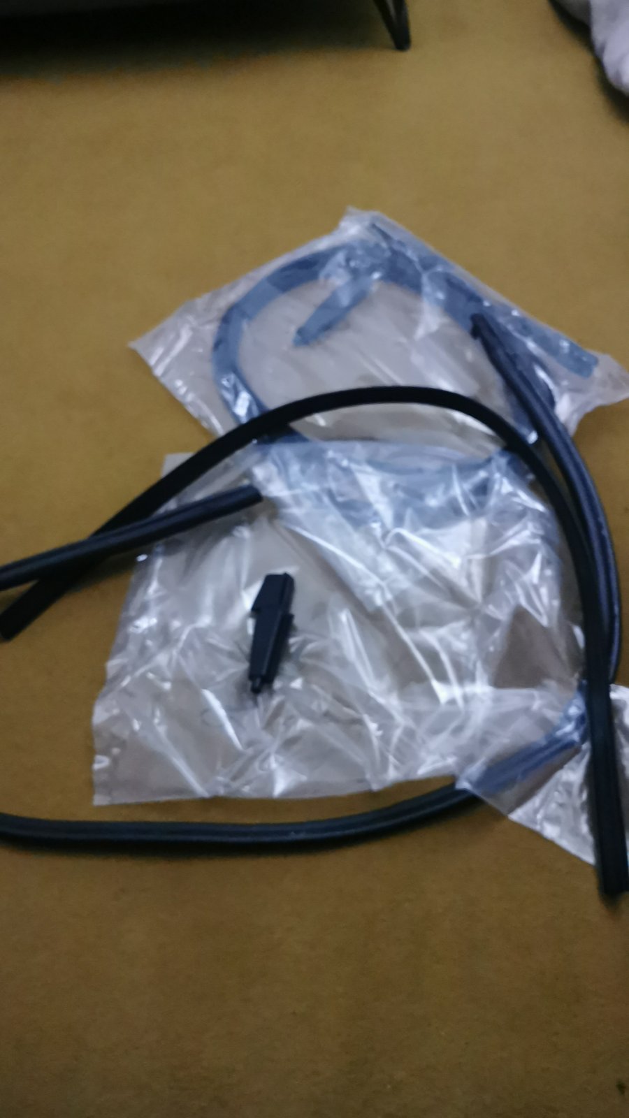

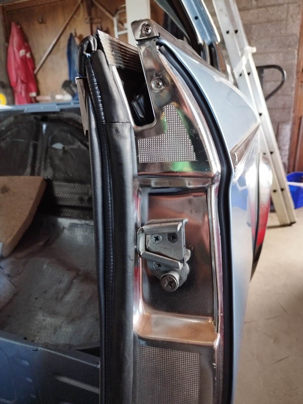

Seals arrived today. I don't have good seals to compare, nosmonkey has provided a very good comparison, which I think is very accurate, including the fact that some glue is visible, however it is accptable. I like the fact that they are a bit softer than the originals, they are fitting nicely so far, I dont have the doors ready to fit yet. Price including carriage to Ireland was €265.00 or $265.00. I placed and paid for the order, I had no other contact, none was required. I am happy with the outcome.

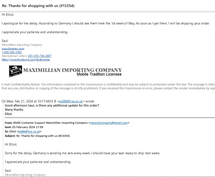

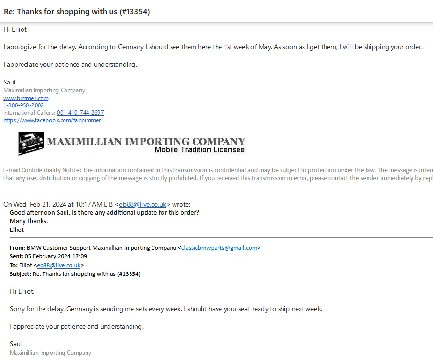

Hello, i've ordered a pair of new reproduction doors seals from a company called "Maximillian" in December 2023 and was given a date of January 2024.
after asking for an update at the start of February I was told the following week.
after asking for an update two weeks later I was told possibly May 2024.
Is there an alternative source for these as i'm now very wary in dealing with this company.
It is already not ideal as i'm having them first sent to a forwarding address in NYC - USA then to be sent to me in the UK. It's a very long round trip from Germany.
Many thanks in advance.
@eb88 , There may be other sources that others will share. Maxamillian is a reputable firm and is actually associated with a BMW dealership in Lancaster PA. I have purchased a number of items, including door seals, from them without any concern. They are not always the best at sharing the actual time to source a part.

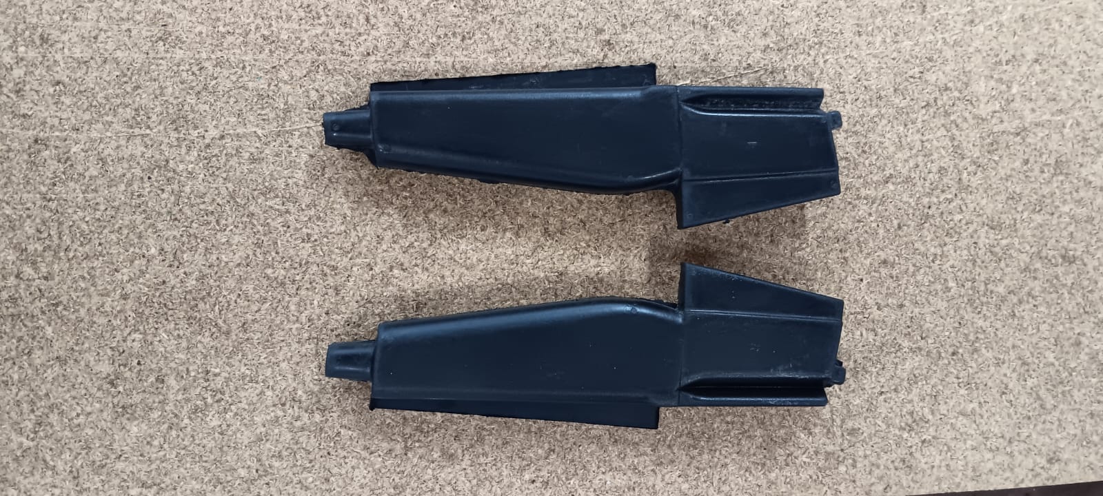

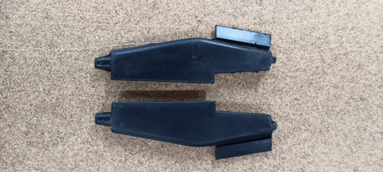

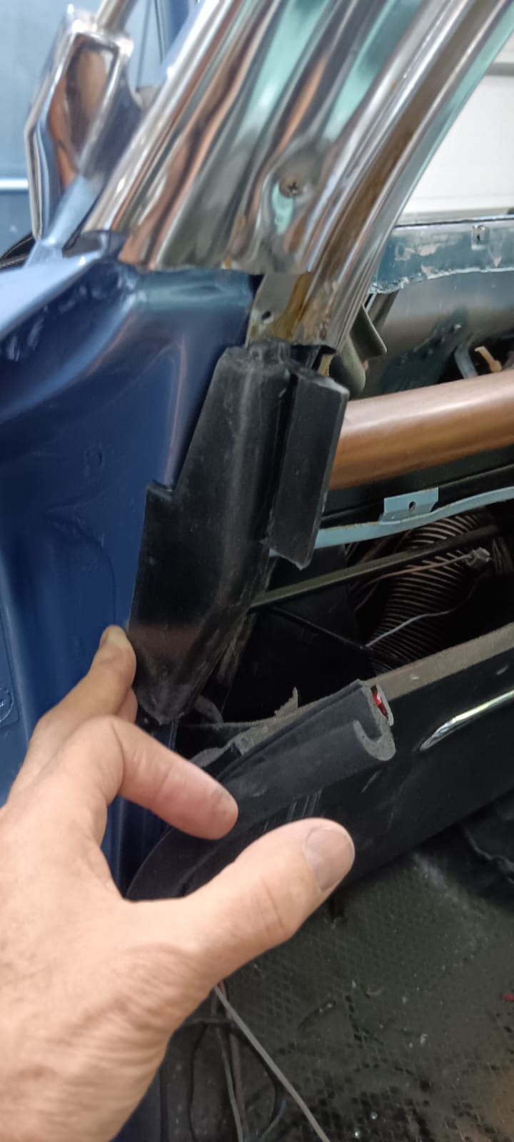

OK… Silly question time. Please have a look at the seals below. Can anyone identify the correct positioning of these? They obviously are part of the 51716754282 / 51716754283 door seal assy, but how are they joined? A photo would be great. This thread does have some pics, but aren't quite clear, especially defining RH from LH. Many thanks in advance.

Wide part with flap fits into the upper door seal, it makes sense if you hold up to the A pillar.

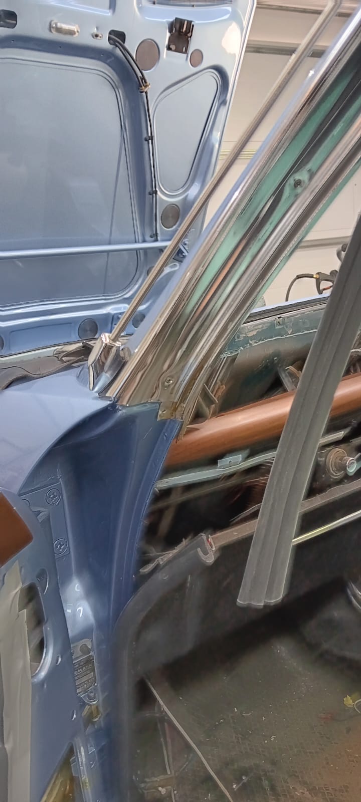

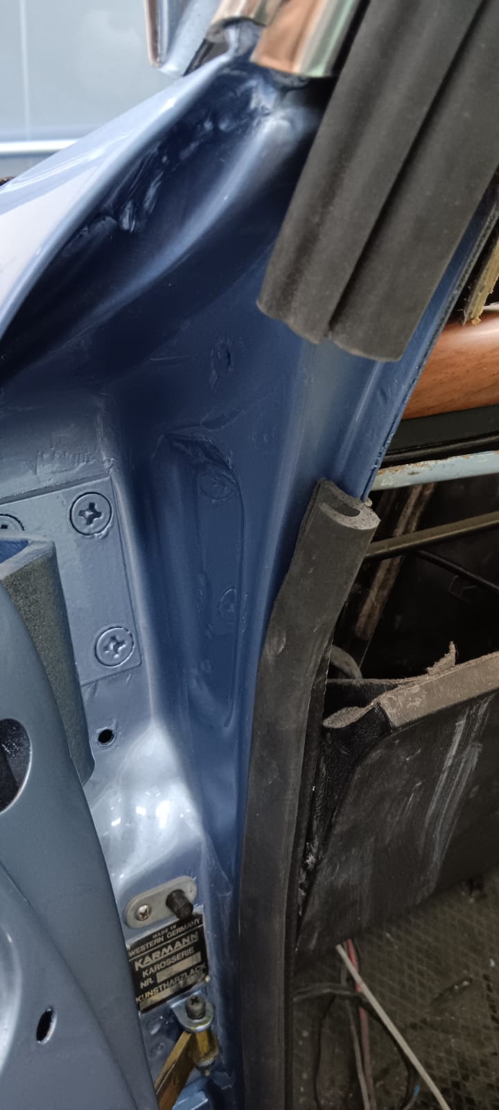

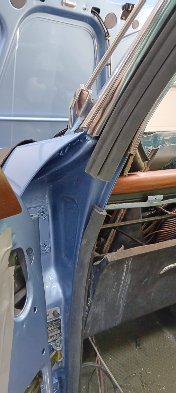

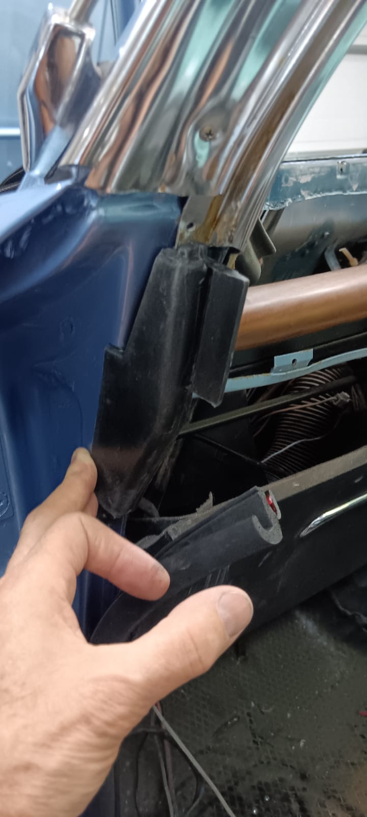

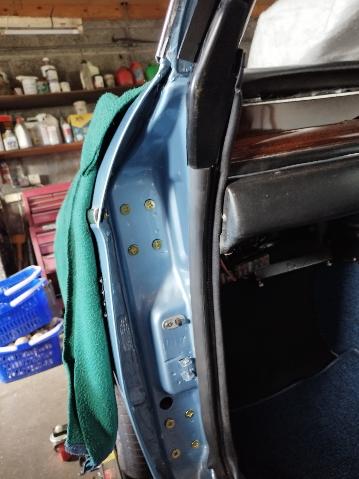

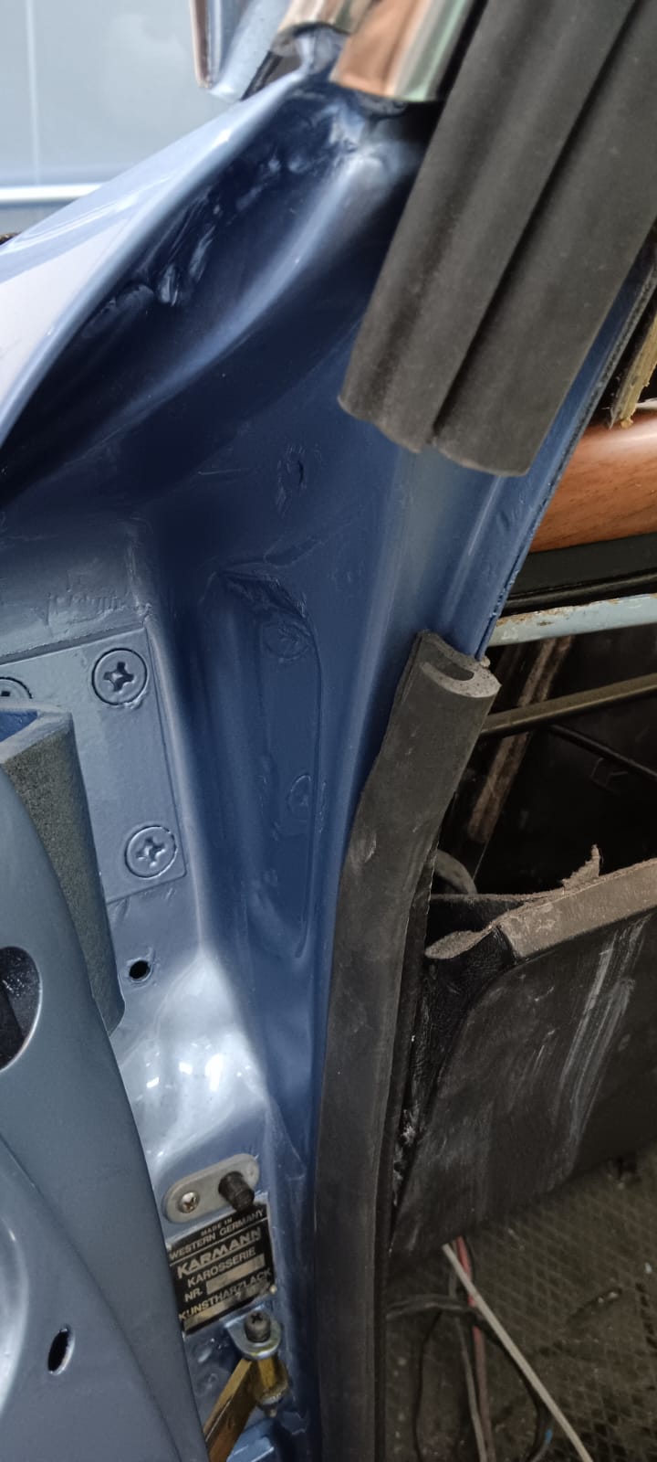

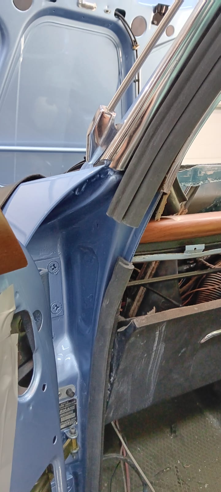

OK... Still somewhat confused. My natural state. I have added a couple of pics. It seems like the upper and lower seals are too long (out of the packet). Happy to trim them, but at their cost, I wanna make sure I'm getting this right.
