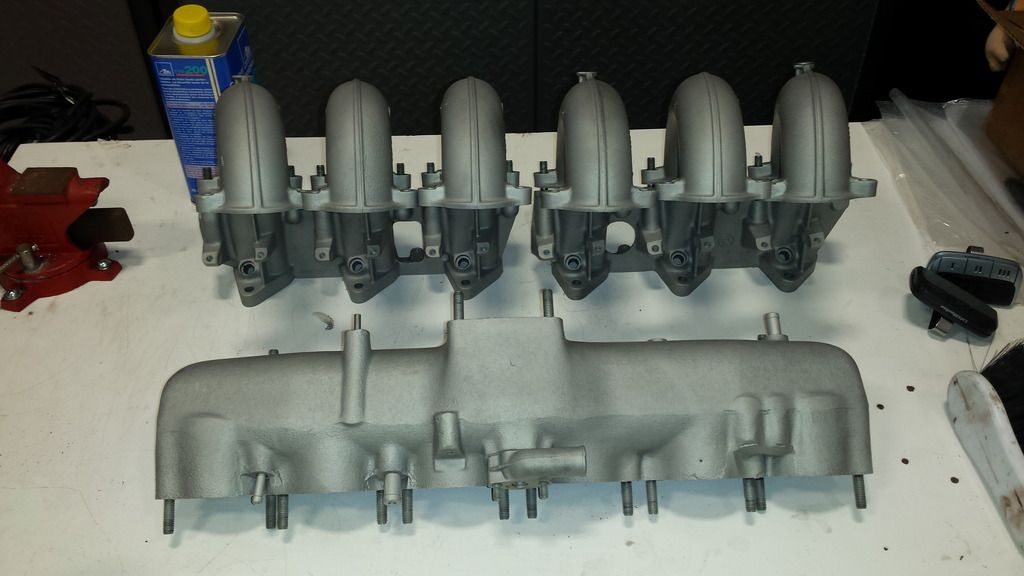

OK, I finally got that 320is put back together, just waiting on the duplicate title so I can register her in my name, so now it's on to the new engine. I have for your viewing pleasure the intake that Mr. SFDon sent me, Don has the head and I have the block being finished up this week (I hope). I will have all the parts laid out at some point but for now it's a bit like LEGO's Gone wild!

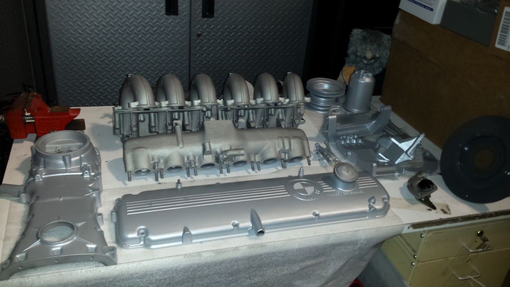

Hi Koldo, I Had the valve cover and other parts powder coated in some kind of silver, Don is responsible for the fine work above. I hope I can get this beast to run as good as she'll look!
I started breaking out some of the pieces in anticipation for the block and head.
I have an oil cooler for the engine and a reservoir for the LSD if I ever find the correct one and the front covers may or may not be useless as if the previous head was milled and the front covers milled accordingly then the probably will not match up to the new head- although if the covers are too big I can mill them to specs. (just some little things to look out for. Since I expect the head to arrive assembled (possibly with a passenger from SF), and the block will be on hand the parts that I'm missing are the injectors/rail/etc, the ECU, the fuel pump set up although I have a few- not sure what Don will recommend- and the crank/timing gears, Oil pump, various chains and tensioners and I'm sure there is allot more BUT: I will start to document; the intake came from Don and I think he can tell us what the standard is for this set up (please) ie. what kind of car/years/engine did it come off and how can we identify it positively, also any intakes that look similar but will not work.
So far, I have the block (which I'll try to categorize when I get it back)
The Intake,
The Valve cover off the original engine, some have the oil fill in the front and some in the back- hope this one fits but probably won't.
Front covers -as mentioned above
Various pulleys and brackets, these you should keep from the donor and the recipient block to see what matches up best
I have an aluminum radiator and all the stuff from the old engine set up
I promise to go through in more detail after the Monterrey festivities- Thanks for watching and hope to see allot of y'all on the left coast!
If using the standard b35 style air cleaner you will want the rear filler, there are several versions. Looks like you have the correct one without the added studs and flat spots, I think e12. Some covers are thicker and will need longer mounting studs.
