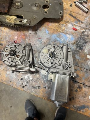

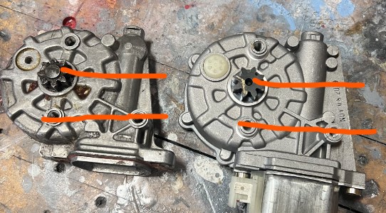

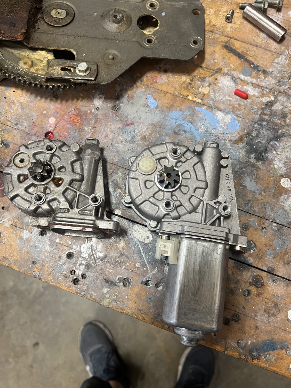

OK, need the table level view (vs. overhead) - if put a ruler flat across gear top and another across the two mount surfaces, what is difference? Are both units same?
If you mount each motor in position on regulator and look from the side (regulator gear as horizon) how does the motor gear sit? Centered, at top, at bottom

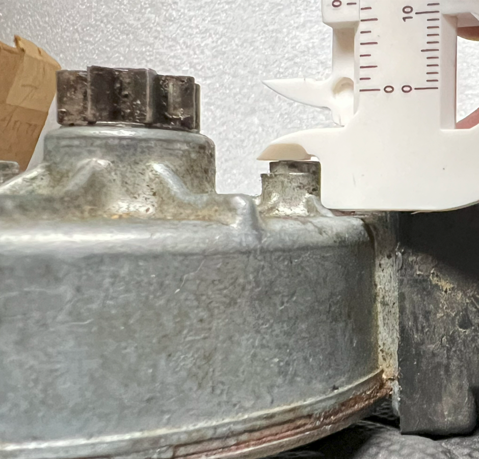

Bosch 0 132 001 101 for MB
approx. 12mm, so too "tall" to use without custom spacers.
What is distance on the Porsche?
I am quite sure the E28 rear regulators are not the same as an E9.
Right! E28 rear motors will substitute for e9 motors pretty easily (and are faster/more powerful, though not "window breaking" powerful). But I doubt the E28 rear regulators are similar to E9 front's; I suspect that Pflyer's mechanic just substituted motors and not regulators.

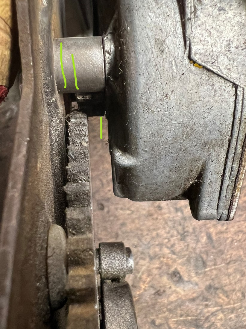

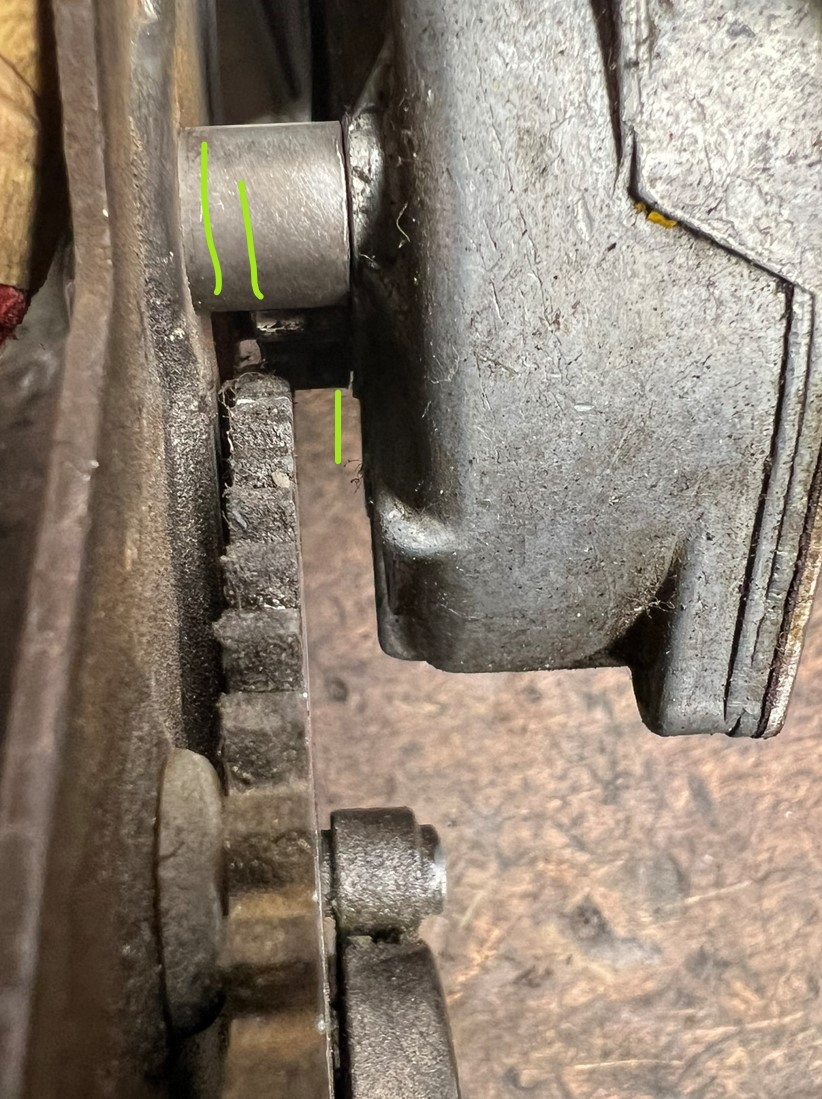

picture of incorrect motor mount/drive offset causing <50% gear to gear engagement.
