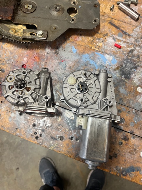

OK, here are the facts. It’s a 1974 e9, so the Porsche motors are identical, as verified by my mechanic. The older e9 regulators are quite different. I think the key to installation is with the rubber stoppers that others have commented on. The reason we went to the Porsche ones is because one of the two e28 regulators that we purchased was bad. On a hunch, my mechanic purchased the Porsche ones to see if they would fit. They were identical. Height, dimensions and gear. I have the e9 shop manual that describes the installation of the window. It’s not very complete on the window installation.
Here are the regulators
? The spacing for the holes? Doesn’t appear to be the same?

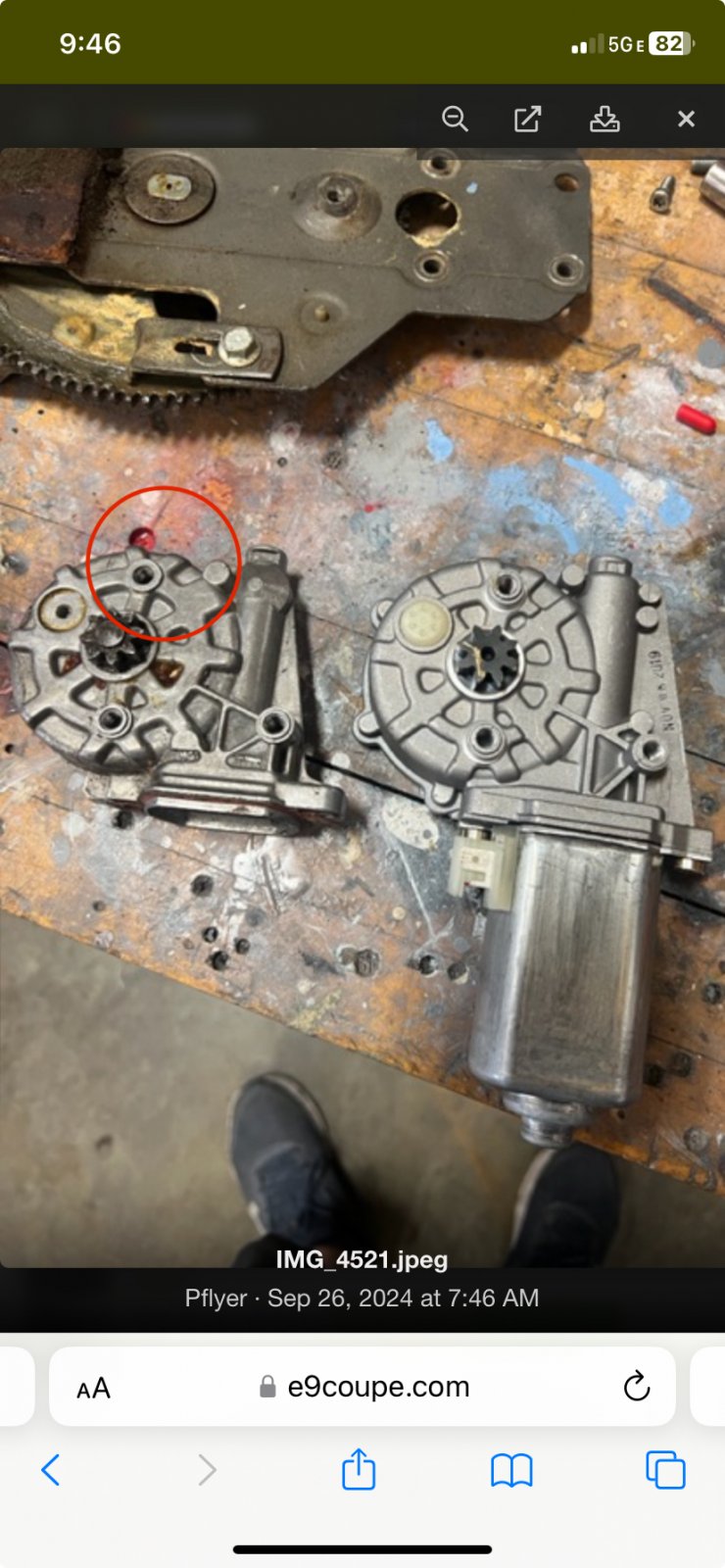

Does look like the "upper" gearbox mounting hole has the locating shoulder on the new motor and not on the old (original?) on left..
Is that same picture of "first" replacement - no difference to 2nd replacement?
Shoulder difference?
The one on the right is the new one. The replacement (e28) is on the left. If you zoom in, the holes are equidistant.
