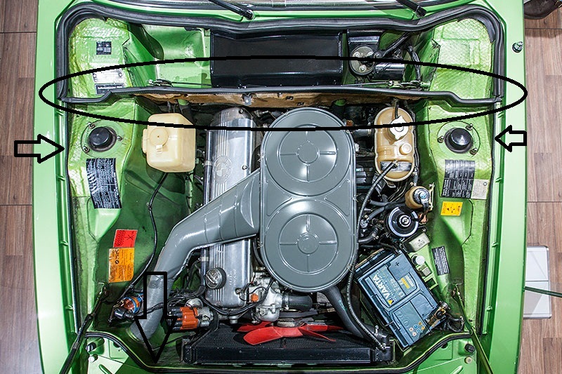

I belive this is upper one

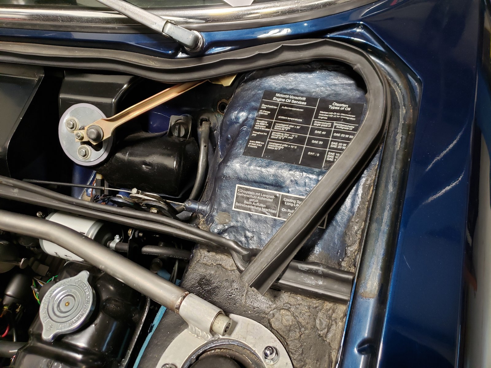

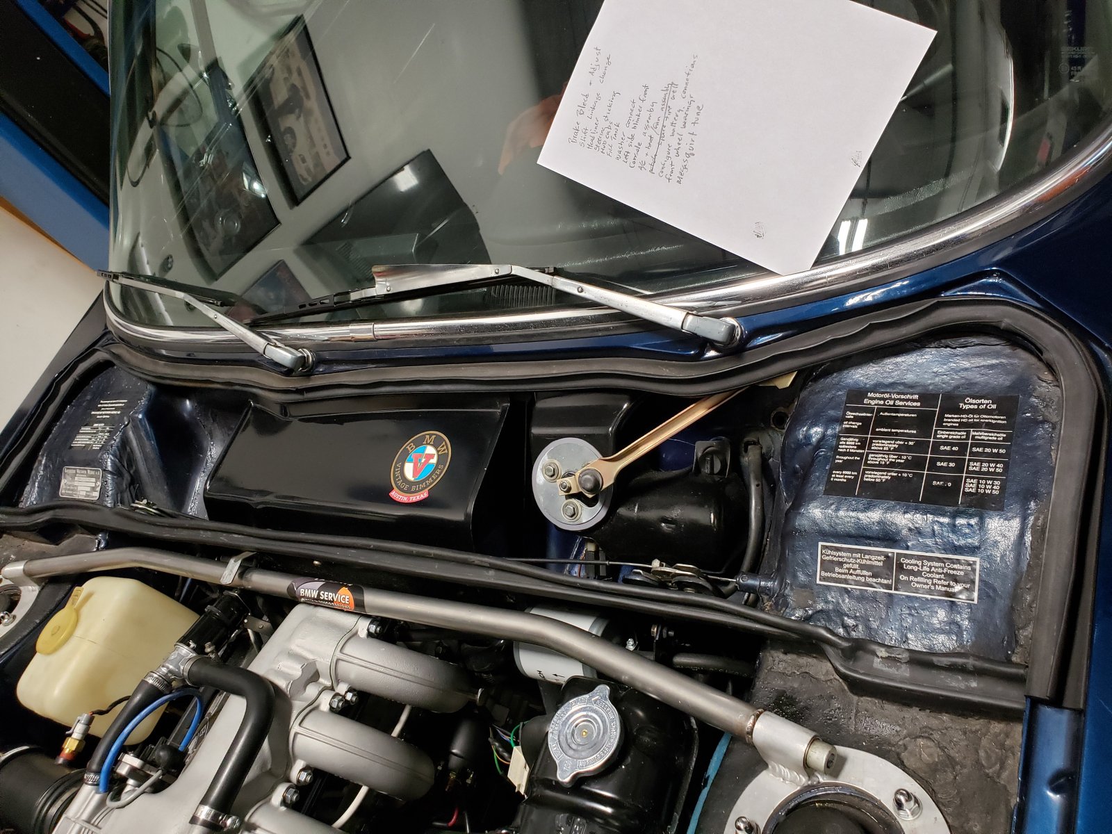

I was told it might be a good idea to leave the top rubber piece loose as water will collect under there- once it's formed, it fits in without glue.

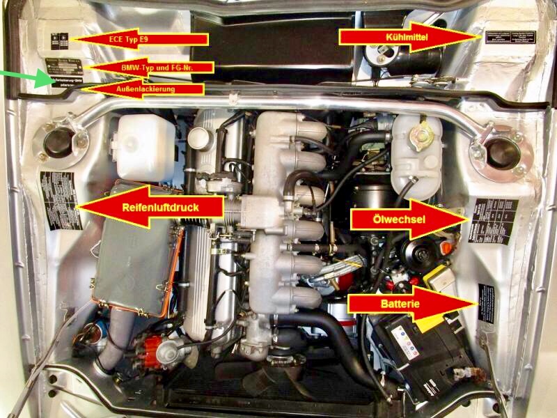

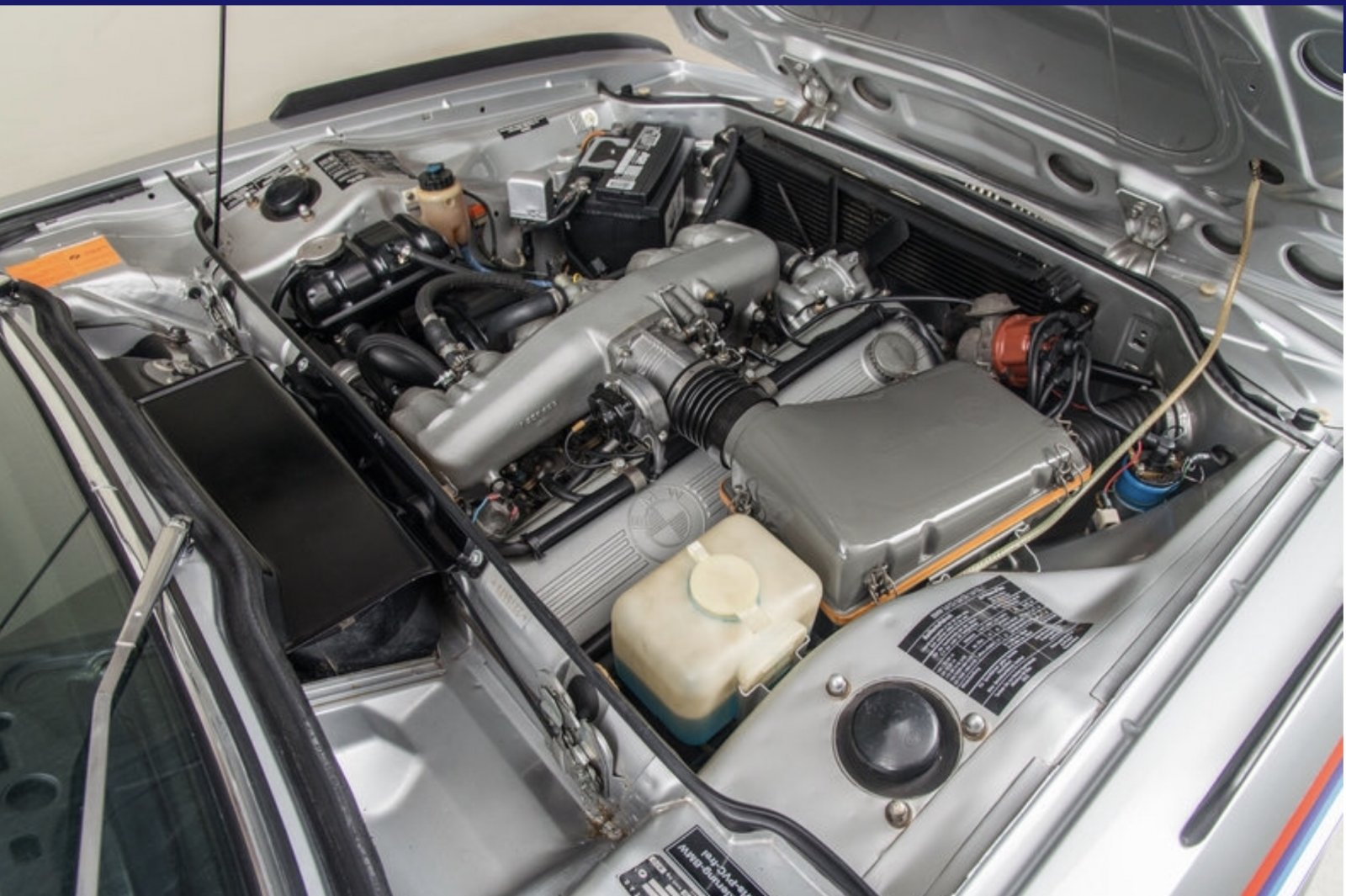

That’s right Alan, it’s a face lift car like yours, and the stickers positioning is original. Car belongs to our friend Christoph from cs-werke.

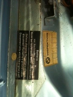

Except US coupes didn’t get the small ECC sticker, the red one by the Parts sticker, the tire sticker on passenger fender (2800CS only), or the two small ones by the oil sticker, and I’ve never seen a battery sticker that close to the battery.

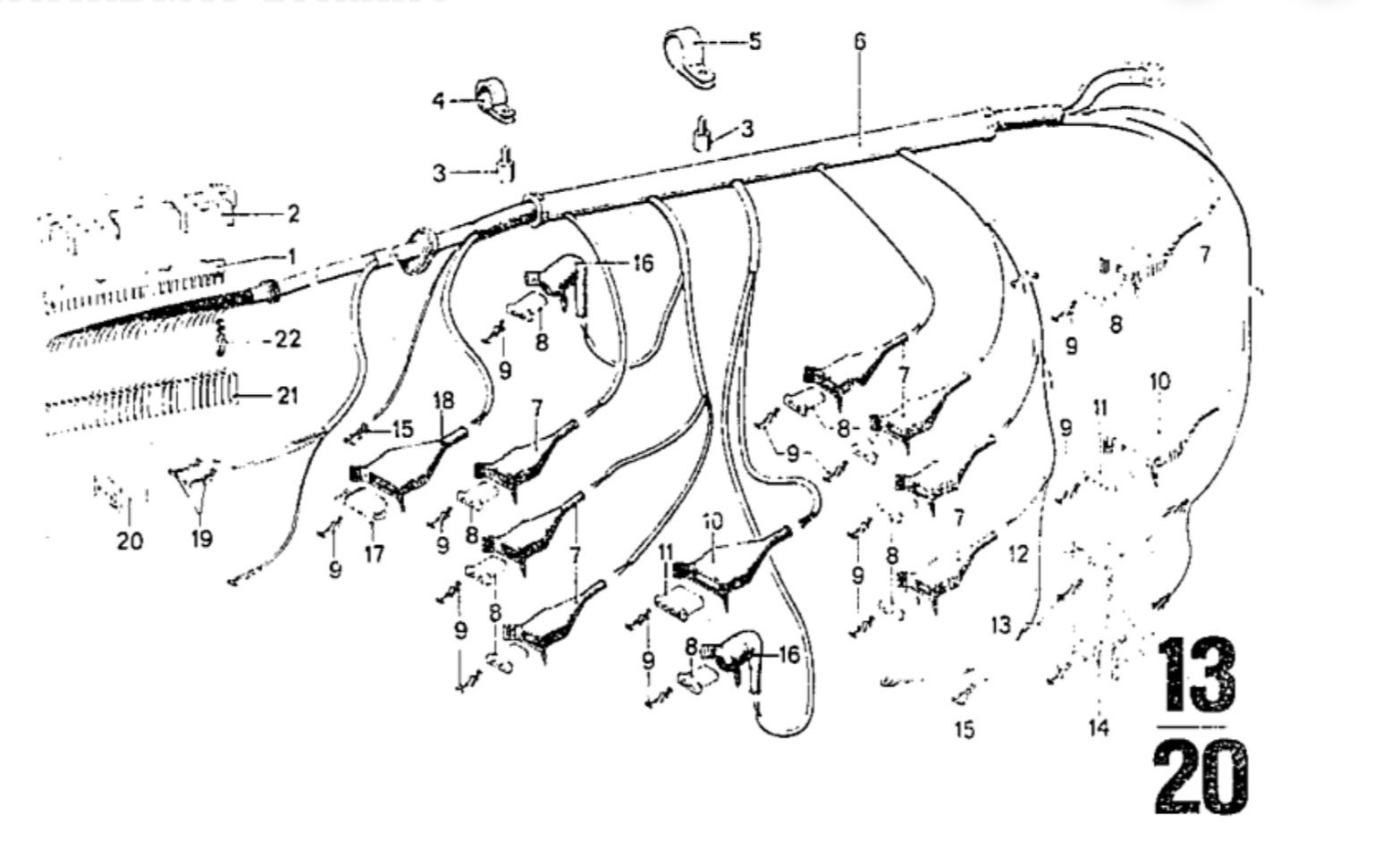

Even better, under Media, Engine Electrical, page 2, midway you’ll find the pics for the DJet harness posted by Dan.
