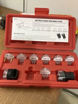

do a Forum search for "fj118 " ....same flow rate and fraction of the cost. No brainer IMO ....suggest you replace alll the injector seals too.
SFdon loves his NOID lights! I almost went that route with my FI problems last year…how about borrowing an ECU from him instead to see if all the injectors work, that is if he still has one available?
....allso, are you getting a "pulse" from the connectors to the injectors that aren't working ?
Thank you. I have swapped the working injectors to all the connectors, all the connectors are working, I have also replaced the connectors. I think the FJ118 injectors are the way to go. I have sent a mail to RockAuto, their price seems very reasonable.
